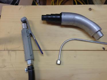

My tools just came in this morning. The BMW sprayer wand thing didn't work with my sandblasting nozzle. LOL
So I made my own. A valve and a couple of fittings I got from my local hardware store.
Cost = $6

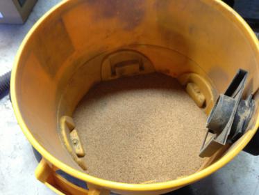

As for the amount of walnut media used to clean the intake valves. About 5 pounds.
This is how much that was in my vacuum after the valves were clean. And to me the media still looks pretty clean so I can still reuse it for something else.
