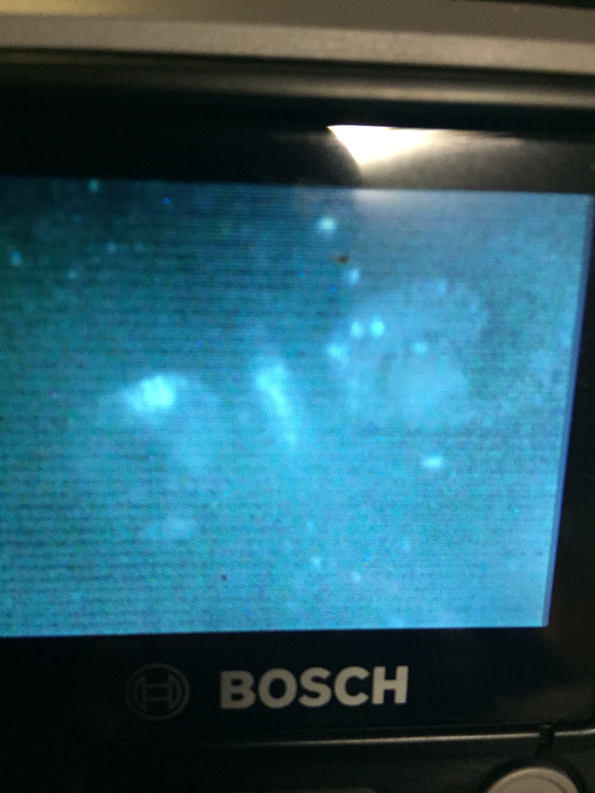

Today I got half way cleaning my intake valves. After my car having 117000 miles on it yet new to me, I decided to do it. As the pictures show. This was long over due.

I ran sea foam through my car three times first. The intake is super clean, but the intake tracks in the head are still gross. Taking apart the intake all signs are that this was never done on my car. At 117000 miles it still ran ok. Although based on those pictures I'm sure it wasn't long before it wouldn't be. I don't think a long drive will help. Because of the direct injection those valves never get sprayed clean. This is a maintenance job. I'd like to see pics of one that only had 30-50k on it. Look at the most nasty picture the stems have almost two to three times the normal diameter of build up on them.

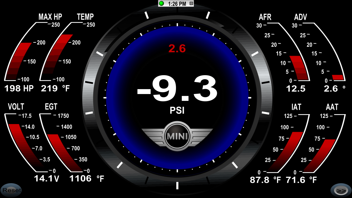

I finished today. An amazing change. I use this app that charts the output from the computer. Before the cleaning and then after.

What app do you use? I use Dash Command
Old Feb 7, 2016 | 05:15 PM
Sstrickstein's Avatar
Sstrickstein
Joined: Dec 2015
Posts: 205
Dash commander

Must be a different dash skin then what I use. I am running the same program. What a difference walnut blasting can make. It is like a new car!

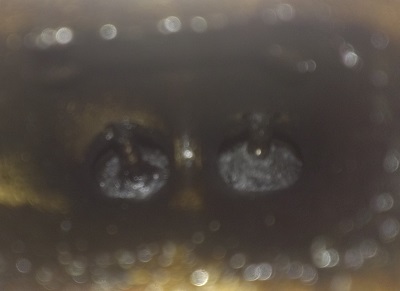

DIY'd the blasting today, this was after ~70k miles from the last cleaning (@dealer) and few irregular seafoam treatments.
Before and after.

Nice, night and day.
