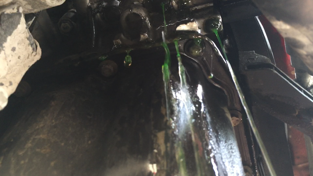

I took the part out and cleaned the surface again. Re-installed. Added coolant. And coolant came cascading out.
I can't tell exactly the point of the leak, but I took a video on my phone and moved it around trying to find out where.
The still frame from basically almost directly underneath the leak shows the leakage. It had pooled on the tips of a few screws and were forming 3 drip points. I also have a frame showing where the water pump is and how it's just fine.
Does anyone have any ideas? I'm about to have to send it to a shop to see if they will touch it, and it's driving me crazy. I've been working on this for three days and hate giving up, especially if it means spending money.
Think its that water pipe behind it on that connection from water pipe to pump.
Looks like where its inserted its coming apart.

Ok, Yea you can get it from the top side and you will have to pop off the thermostat housing to pull it out.
Yea, looks like its cracked or damaged at the connection from the waterpipe to the waterpump housing.
If you take the thermostat housing off you can slide it out that side of the engine bay fairly easily. The water-pump side just pushes in. It's physically captured on the thermostat side.

Pipe is out, and I will upload a photo later to show where the entire section with the o ring is gone.
Isn't there supposed to be a metal clip holding the pipe onto the thermostat? MINI replaced my thermostat recently - it blew up on a road trip and I couldn't fix - which would have involved disconnecting the water pipe.
I'm thinking they left it out, and perhaps they did something to deteriorate the other side that is broken/gone.

Sounds like they lost the clip ? , There is a metal clip on the water pipe side at the connection from the thermostat to the waterpipe.
