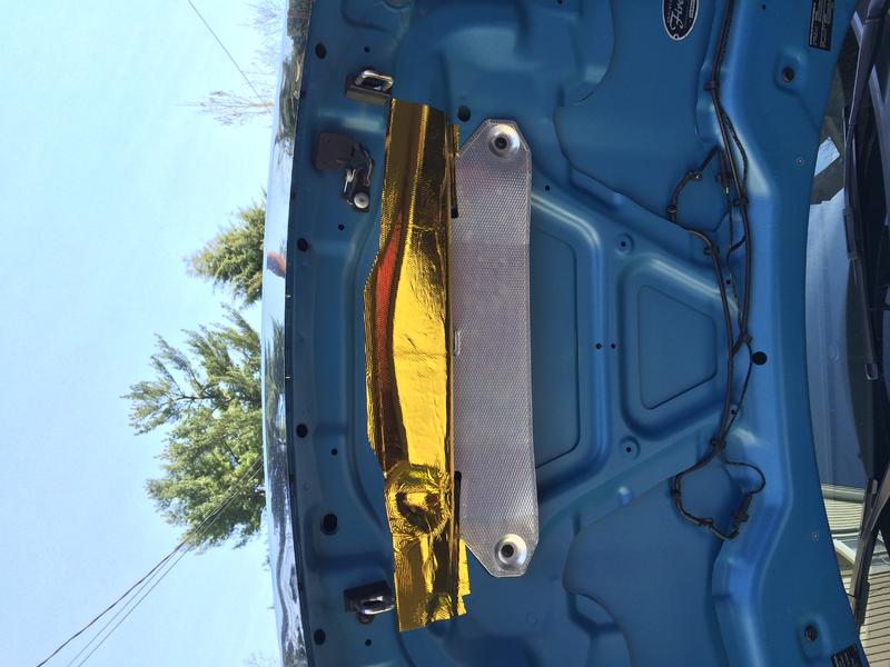

Originally Posted by pakisho
I just looked and there is no underhood shielding at all.
Im running it in to the dealer this weeekend, anything i should ask them to do to mitigate this? And any tips on how to clean them? They werent stained when i got them so im assuming they can be wiped down somehow? A wet cloth did nothing.
There generally is not. A few cars came with under hood insulation, but most did not. My 2013 didn't come with anything.
I added this - Its gold DEI heat wrap and the factory heat shield (which I had to buy from Way Motor Works..)
Attached Thumbnails Is the heat from the motor/turbo affecting the stripes? W/pic-img_1973.jpg
Old Feb 12, 2015 | 05:55 PM
pakisho's Avatar
pakisho
Joined: Jan 2006
Posts: 43
Roger that.
I dont know anything re the cars history so no idea if the shield was pulled off, etc.
Will buy the shield.
