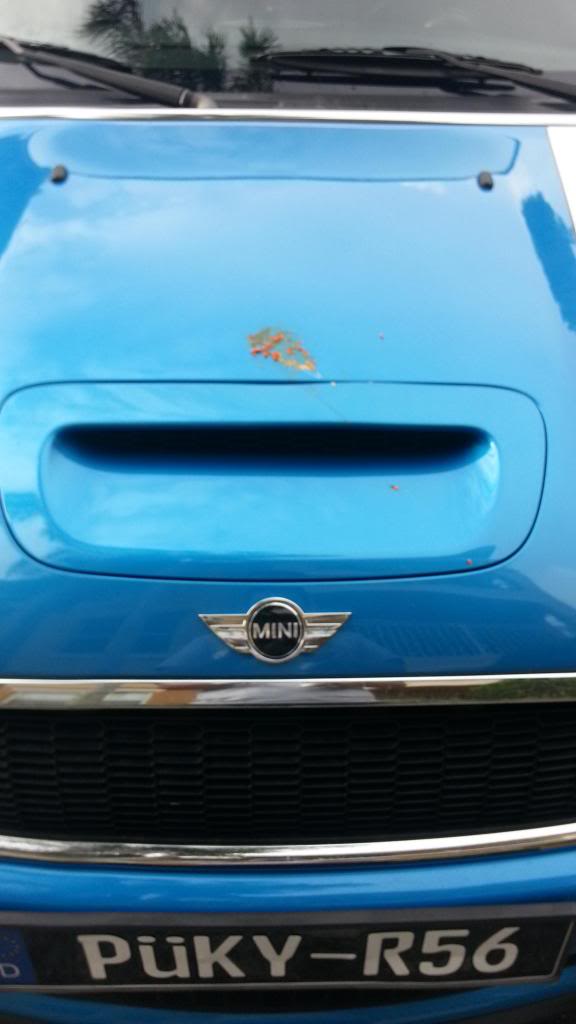

Warping/Melting hood scoop R56
Ironically, it took me a bird's dump on my hood to notice this issue. Went to my Lauderdale MINI service this morning and advisor said it was common issue,so he ordered part and said insulation will be installed as well.

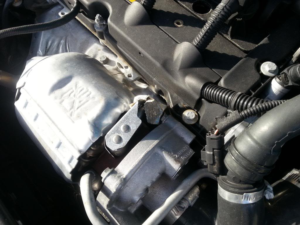

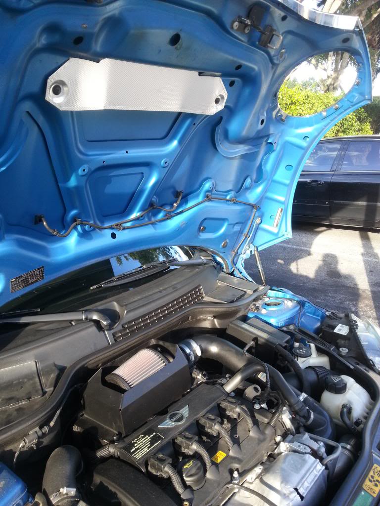

Some pics while I wait for replacement scoop from dealer...

FYI... My car is already out of warranty and yesterday the dealer replaced my hood scoop, installed internal hood shield and turbo line shield all covered under "Manufacturer Recall".
