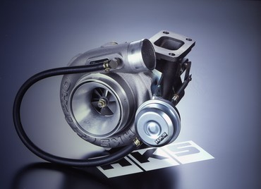

Originally Posted by genik
can you please be a bit more explanatory and also are there any pics of the little tube/hose that connects to it?
http://image.nengun.com/catalogue/or...e_-_gt2835.jpg
the tube you see is what controls the wastegate.
ours work off of a simliar principal but are backwards.

two very important questions if this tube is loosened
1. can it cause loss of power over 4000rpm?
2. can it be responsible for the appearance of the check engine icon?
