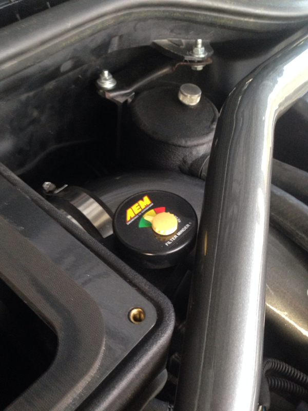

Installed the AEM strut bar and relocated the OCC. Strut bar looks really good installed.

Could you post a picture of the bar installed? I'm planning on getting one, but am unsure if the OCC will interfere.
It will interfere. The bar hits the top of the OCC. I'll have to take a pic or two for you.

Here you guys go.

Originally Posted by mikeyb74
Here you guys go.
You need to use some lock washers or loctite on those threads, when I had mine it lost two screws, use a fiber washer if worried about the finish. Nice OCC mounting job! Whoever purchased my AEM system got very expensive chrome screws and chrome washers that cost me $30!
