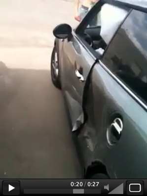

So my T-Boned Cooper S is repairable
Not sure how I feel about it
The damage doesn't really look all that bad considering she ran into my side at 50km/h (she ran a stop sign). They're approving the repairs for about $11,000 in damages at the moment. I'm not a mechanic or anything, but I'm skeptical the car will ever drive the same, anyone else have any experience with being T-Boned in your mini?

My first thought is that the driver's door will never close again quite right.
If you do go thru with the repair, I would not accept the car from the body shop unless the driver's door and window operated (opened, closed) perfectly.
Old Jun 3, 2011 | 04:47 AM
bruno787's Avatar
bruno787
Joined: Apr 2010
Posts: 92
From: Philippines
looks repairable, theyll just replace the door and the rear fender, however, they do need to take apart the car's interior, and weld the rear fender. it will drive the same with a competent body shop.
if you dont like a cut and welded car, then go have a replacement.

Thats not that bad, my 05, had the same damage on passanger side. The dealer replaced the door, cut out and welded in a new quarter panel. Panel sprayed the door and qtr, looks new, paint matches perfect. took about 2 weeks to repair.

The biggest issue will be with the B pillar. If its bent or needs repairs then you can make a case that the car's structural integrity is compromised. If it's just the door and quater panel, then you will probably just have it repaired and I wouldn't worry about it as much. Just make sure to thoroughly go through the car to verify that the airbag chemicals didn't do any further interior damage.

The biggest issue will be with the B pillar. If its bent or needs repairs then you can make a case that the car's structural integrity is compromised. . .
My thoughts exactly.
If there are any visual ques, dents/creases/buckles, I would really make sure that the adjuster who is filling the claim knows. It should be quite evident to the shop who is doing the work, but who knows.

ouch! thank god for those side and curtain airbags otherwise that could have been a lot more painful. In addition to the other suggestions, I also would keep an eye out with the paint job after the repairs are done. Sometimes the "blending" is wayyy off, and you'll be driving around with that door and further quarter panel a shade or so darker than the rest of the vehicle. Not noticeable initially, but in direct sunlight, you'll be able to tell the difference.

I have been in the body work biz for a while and if you want my opinion send me a copy of the estimate. I would try for a new (or salvage) door and quarter panel.
If you have her at a dealer you will probably be fine.

The new rear quarter is actually going to be glued on...pretty easy fix. Replace the door and quarter...and it'll be good as new.
I'm concerned...that quote seems REALLY high?! What else is being fixed? I'm sure they will blend into the small front fender and into the rear hatch...but still...seems like that estimate is a few grand high...
A new door and quarter isn't too expensive and replacing them isn't really that hard...the most difficult part is taking the freaking interior door panel off lol.
EDIT: Scratch that...just noticed the airbags were deployed...that solves the problem of why the cost is high for repair.

Anyways, I'll definitely check out that B-pillar myself before signing away for any repairs to be done, and I'm thinking of getting a second opinion. I'm told the body shop I have it at is the best locally - it's insurance approved, don't know if it's mini approved. I'll probably send it to the dealership for another opinion. If they both say repairable, then so be it I guess.

They say they are replacing the B-Pillar??? So I assume they're just going to go ahead and cut it up to do this?
It was bent pretty firmly since it was pretty much a direct hit to that. Soooo what are the odds the undercarriage is bent?
