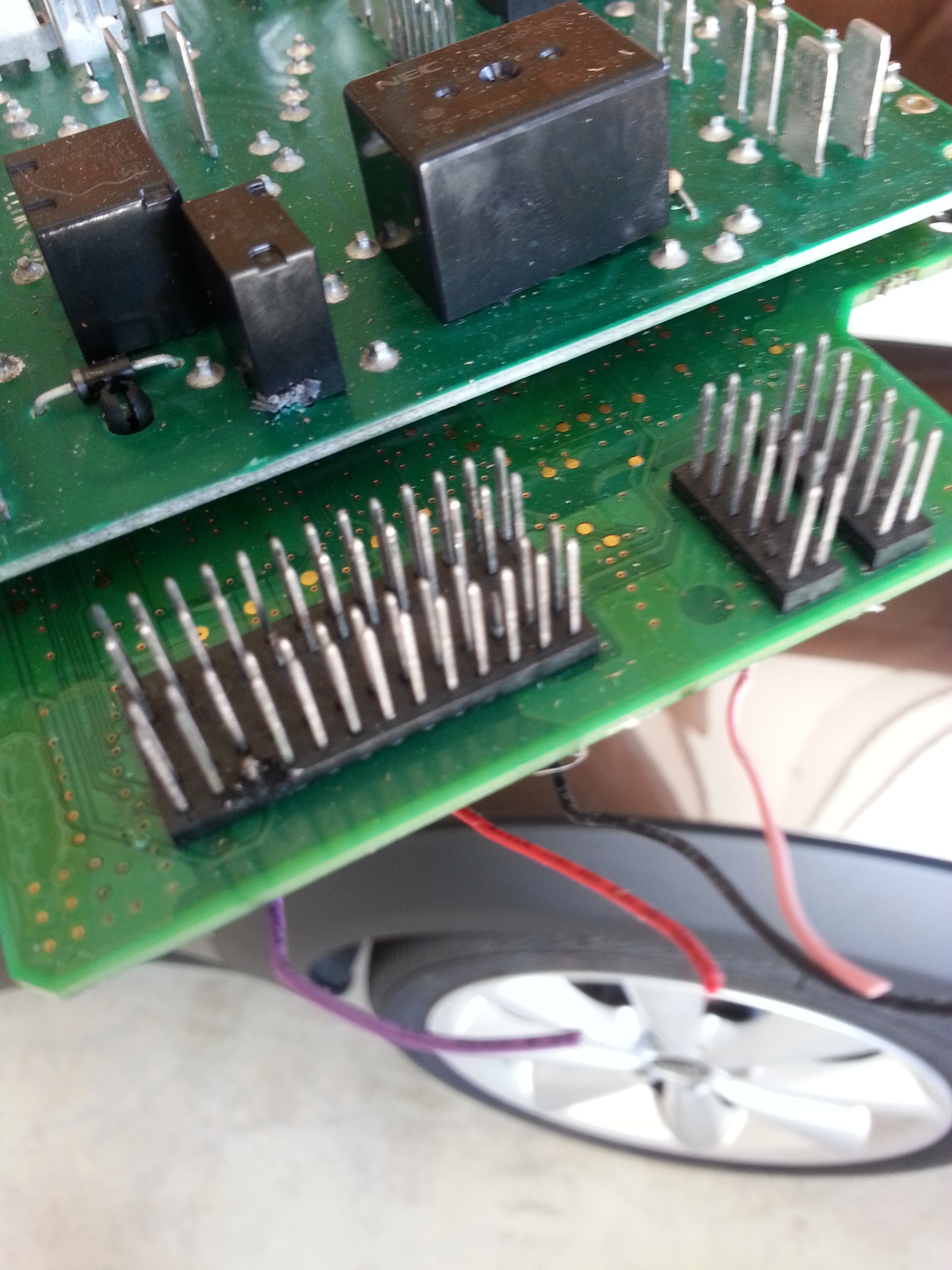

Second post, if its a little confusing I am also responding to some other members comments: After hours of interior removal and searches for any potential issue I have found 4 wires on the lower 2 plugs on the BCM. When disconnecting those plugs to examine the wiring 4 pins came out with the plugs. Rather than replace the pins I just soldered a jumper wire off the back and routed it around to the correct wire in the plug.Everything was great. During the down time I thought it would be a good time to have the PDR work done.
The tech came and moved the car into a well lit bay and began to do 4 hours of dent removal. The next morning is when my nightmare began. They got in the car to drive it on the tow truck and.... no start. 30 attempts later...no start. everything was checked, fuses, relays (ehh?) battery was low and recharged. Battery was removed to allow DME reset..nope. Key operates as normal, lights and accessories 100%.
Everything but the engine will not fire. crank yes. Smell gas, yes. Spark, no. checked the BC1 and it looks the same as when i did the work. I am absolutely stumped..

My Mini is a 2013 S, AT with 8831 miles. I have since stripped the interior to the sheet metal and have unplugged every plug in the entire interior, having found only 2 plugs (both are the 2 lowest plugs on the BCM and also the closest to the cellulose material sprayed on the back of our carpets, see attached. The interior was bone dry behind every panel with exception to the passenger footwell. For good measure I used 2 humidity indicators that we use at work (uline) they did not even register. And our portable desiccant dehumidifier was also installed as best possible and ran for 2 cycles, both timed out because nothing above the relative air humidity was detected. Regarding the exterior, it can get as wet as possible with no ill effects for obvious reasons. Also attached is the pic of the car, the BC1 board and solder job. You can see what I was attempting. The crazy thing is this all worked. Not until after the PDR work did it have a no start issue. I checked the panels and all appear to be installed correctly, besides what could the tools from PDR repair possibly do to cause a no start issue? The remote key works correctly, the radio, windows, odometer, locks, lights and every button that operates a device works 100%, just won't start. Cranks like a madman, no spark. You can smell the fuel. The battery is registering 14.1 volts at this moment. No spark. I really like this car, and want to drive it! For the 100 miles or so before I decided to nose around it drove like a new car, very fun. Any advice or insight on how the BCM could cause a no spark issue ONLY?
