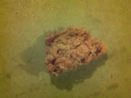

I thought this was such a weird problem that I had to post about it, along with a pic.
Recently, I noticed that when it was cold outside, I would hear a roaring type noise coming from the HVAC fan that would get louder as the fan speed increased. I was hoping that it wasn't a majpr issue, but I was surprised to find out what it actually was.
Apparently, a critter decided to build a little nest in between the fan and the cabin filter. When I pulled the cabin filter cover off to have a look, a bunch of pink insulation fell onto the floor of the car. I reached in with my hand and removed all of it, and the roaring noise went away.
I assume that the nesting material came from my garage walls that the builder insulated and covered with plastic, but never drywalled. Unless this material is used somewhere in the Mini? I am also wondering how the heck a critter got in there in the first place. The cabin filter cover is too tight for anything to get in that way, leaving only the fan side, which seems odd. Also, the material was free of excrement and smell, so whatever did it didn't stick around very long.

Wow, that is pretty crazy. How big was that nest? Seems pretty large, and dense.

It was about 6 inches in diameter and pretty thick and dense. It probably took up the entire area from the filter to the fan. The funny thing is that the car is a daily driver all year round with maybe a weekend of non use here and there, so whatever did it (probably a mouse since our cats catch one every now and then) worked quickly. I can't imagine how much work it would take a single mouse to move that much material.
Another funny thing is that the same garage houses a car that is used only several times during the summer and I've never found a nest in that car. Next weekend, I'll be going through that car very closely.
