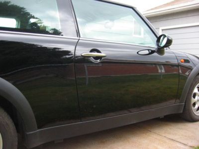

Update, sort of.
I went by the body shop to see what it would take to remove the inner panel. He grabbed the outside door handle and pulled. The handle came apart. Enough was attached to the cable to be able to pull. The door opened.
So now there's a rubber band on the outside door handle sort of holding what's left of the parts together. Door opens from inside and, if necessary, outside.
Kind of happy ending. Wife isn't entirely confident that she'll be able to get back out once she gets in.
Road trip tomorrow!

It's alive!!!
OK, fixed, all better, everything fits and all of it works and none of it rattles. Good as new.
Well, of course it's not really good as new, but good enough for the next 20 years, I think.
The estimator was surprised that the price for parts was as low as it was. Fine with me.
