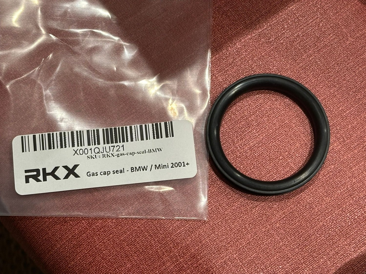

OK, I ordered one of those eBay gaskets. Hopefully it'll fit!
The tether on the original one doesn't come out of the side so I don't think there's a ring to pop off and transfer over.
I'm surprised this issue hasn't come up more often for owners.

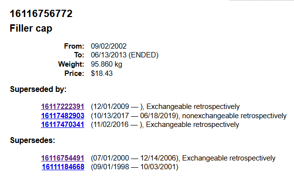

it is so confusing to try and find the actual part number for the original design
i punched in alotta the numbers but supersede supersede muddled mess
so don't know really the timeline of the changeover

Ya, that's the stuff I was seeing on RealOEM too. Crazy how BMW/MINI thinks that the new part# that superseded all the old ones which has a shorter tether coming out the side that isn't long enough to stretch the cap to the cover's holder while refueling is OK?????

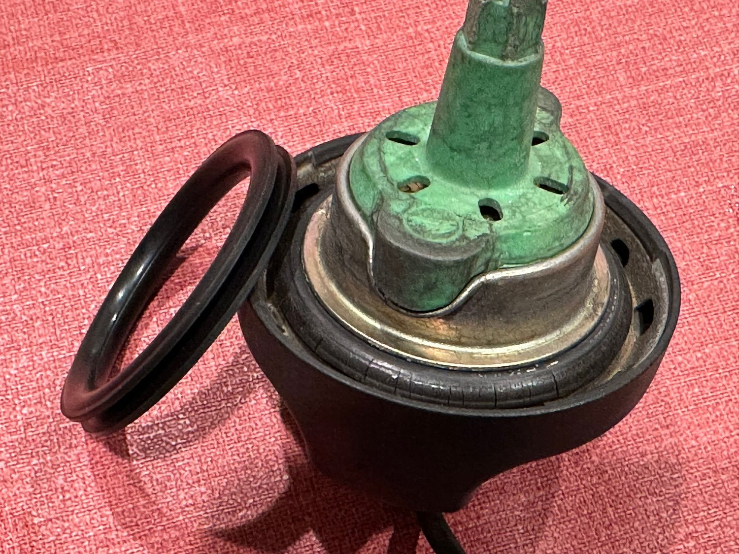

Well I don't think the eBay seal is going to fit my original cap. Looks totally different???

That is the same exact seal I bought off Amazon (2022).
Amazon Amazon
Fits and seals perfectly.
When you pull your old seal off you should see they are a perfect match.
Sticking my neck out banking on the fact that I'm right - please don't hate me if I'm wrong

@MiniManAdam
said it fit & worked for him too as he posted the same Amazon link for the RKX brand. . .

the RKX brand seems to be the new style but still seems to work to perform same function,
some sellers list the simple o-ring

Optimistic message from the eBay seller "Thanks. I am about 90% sure that this is the correct seal. I believe that your old seal has just permanently compressed as if it were installed which gives the rounded over appearance. I think we have one of these gas caps in our development department. I can try and see if I can locate it tomorrow to know for sure."
I didn't consider that and not sure if it did or it's just hard to tell by looking at it while installed.
If he says it should fit, then I'll risk removing the old one to try the new one out.

That's a great video! Looks like on the R50, the shorter tether isn't an issue. It's the R53 where the tether attaches pretty far back is where it's too short.
The eBay seller has been great to work with. Unfortunately he couldn't locate the gas cap...
"I am sorry I looked everywhere and could not find this gas cap in our inventory. If you need to return the item let me know and I will get you taken care of!"
I asked about the groove on the O.D.
"Do you know what the purpose is of the outside diameter groove that goes around your seal? Is that supposed to fit into a groove on the cap, or just give it some sort of compression? If it's just the latter, maybe this might work."
His response
"no it does not fit in any groove on the car side it is just a copy of the OEM seal. This same seal is actually used by like 5 different manufactures we just sell them advertised to each individual car brand to simplify things. This seal that you got is by far the most common one out there used by basically every European car brand from about early 2000's up to today. Where your car is 2005 it should fit, but some models used older style gas cap seals that we less standardized up untill the mid 2000's as they were original designed in the late 90's"
So, I think this could definitely work. I'll try it tonight. The -326 o-ring probably works too, but I can see on this eBay seal and the original it's got the same non-circular cross section, so this will hopefully do the trick.

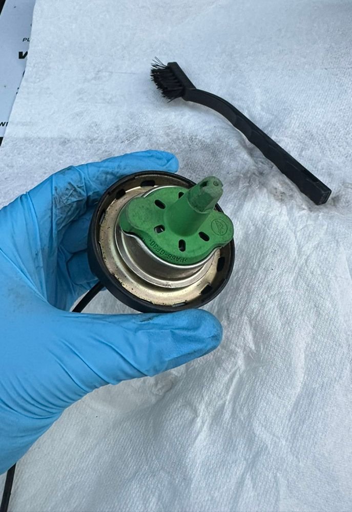

Well, what do you know! It seems to be the correct seal for my R53.
I want to say seller RKXtech has been super responsive and helpful - highly recommended. And Oldboy Speedwell, I don't think I've ever seen anyone so adept at researching archaic information/videos/posts on a forum ever before. Thanks for all that help!
I finally bit the bullet and yanked the old gasket off the gas cap. Much to my surprise, and contrary to how it looked installed in person and in photos, it has a outer diameter groove like the new replacement eBay one does. It was just crushed together and looked solid.
I tried cleaning the inside and outside with some MAF sensor cleaner.
A -326 o-ring would probably work too but those gas cap engineers must know something I don't and added that groove for a purpose.
Anyways, it's on the car now. Hopefully no more error codes.
