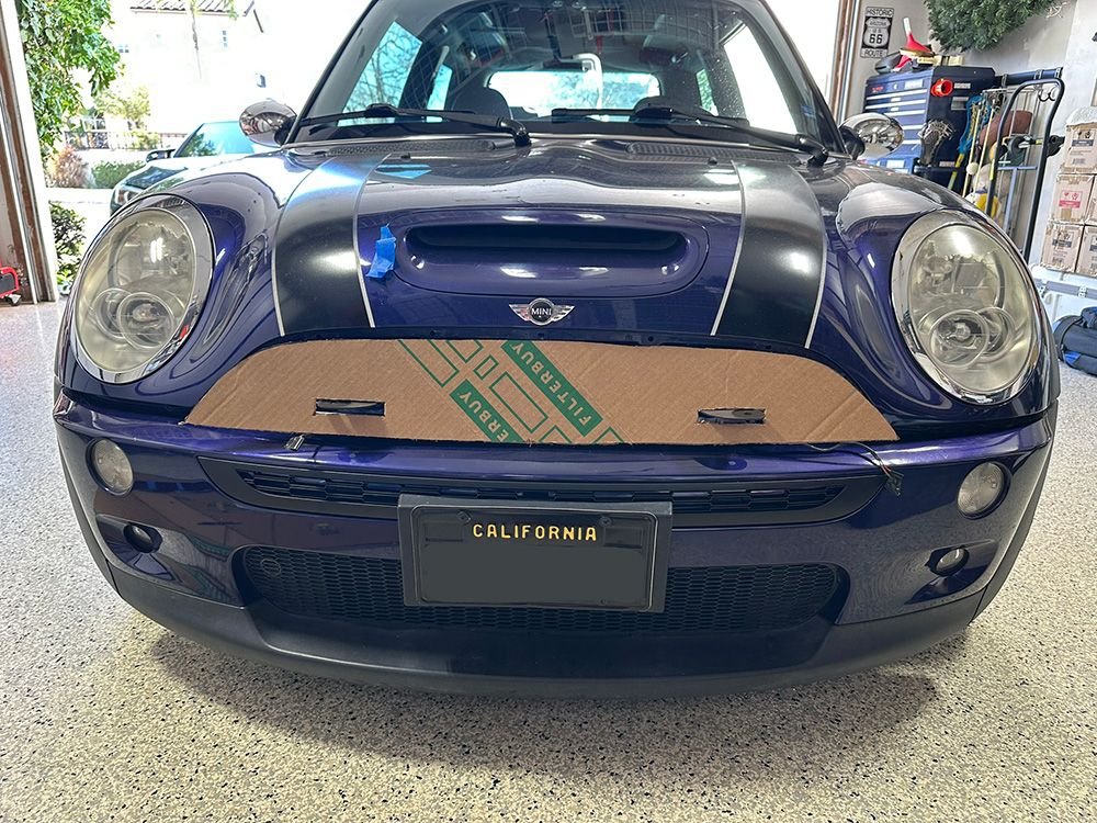

This car has A LOT of chrome on it. I had always wanted to do a JCW style front grill. My dad had actually put black vinyl tape on the grill to black it out, but that didn't last long.
I finally pulled the trigger on the out motoring flat back upper and lower.
Installation was complicated by the existing OEM rally lights we installed years ago.
Came out really nice. Happy with the results.

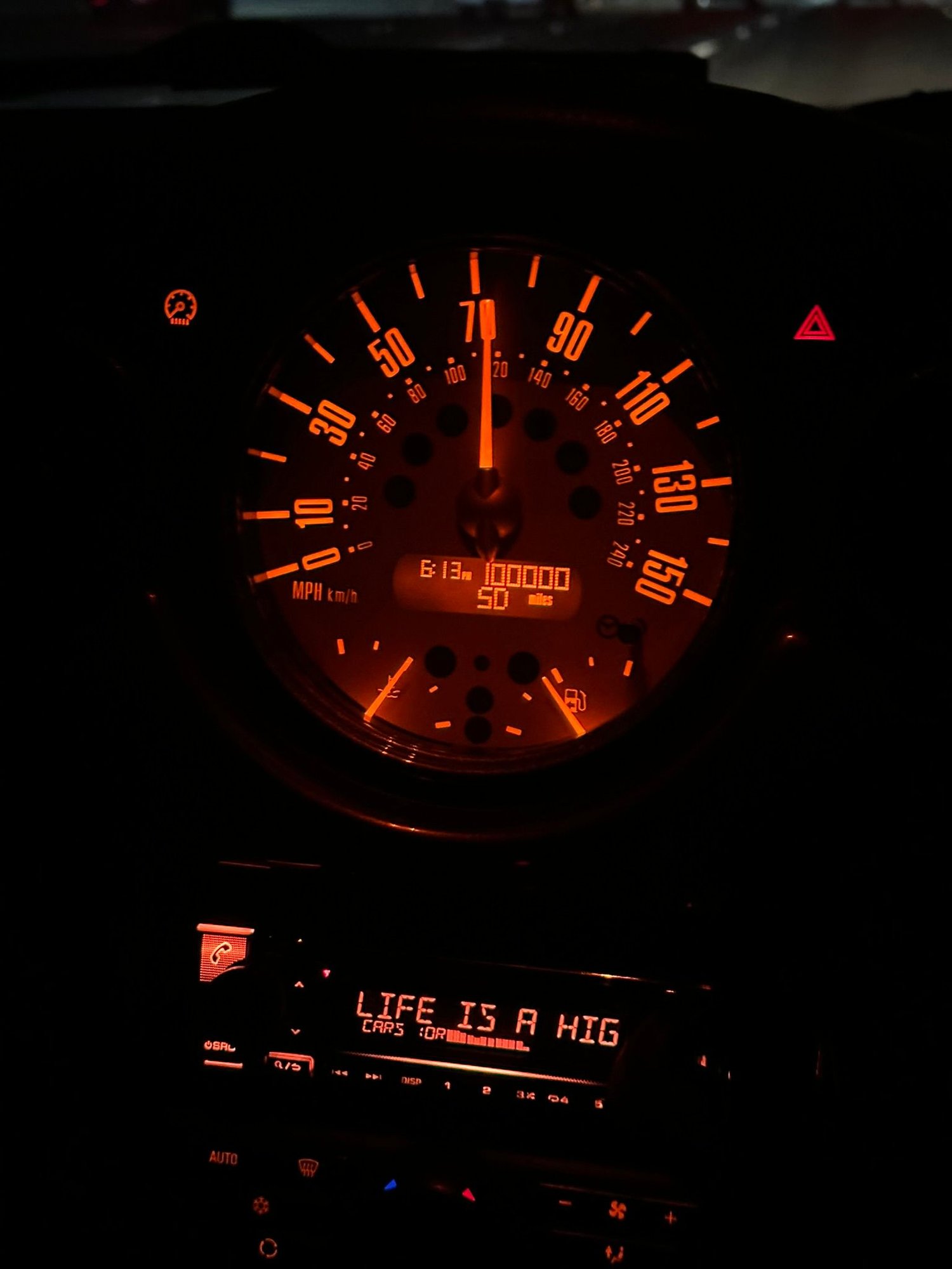

My daughter actually came home from college to be the person driving to crack 100K miles.

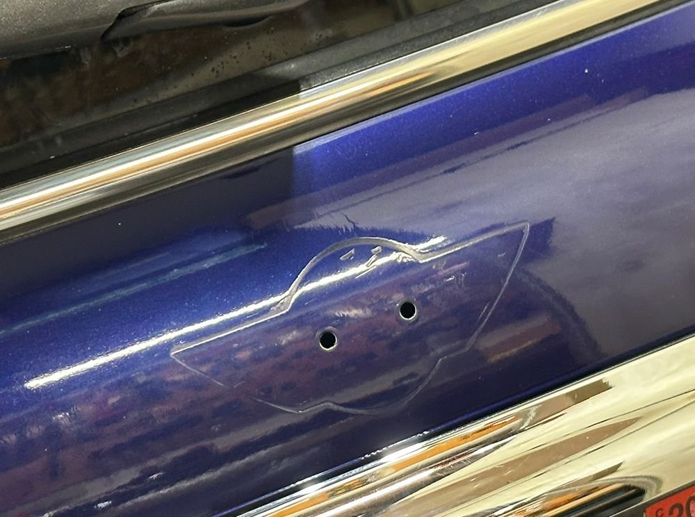

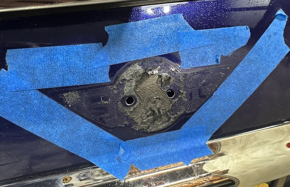

The rear MINI badge was looking a little beaten down by the sun. Got a new one. Make sure you get the correct version for R53 that has 2 of the same diameter locator pins on it. There was some confusion on a supplier's website and wound up having to return the first one I recieved.

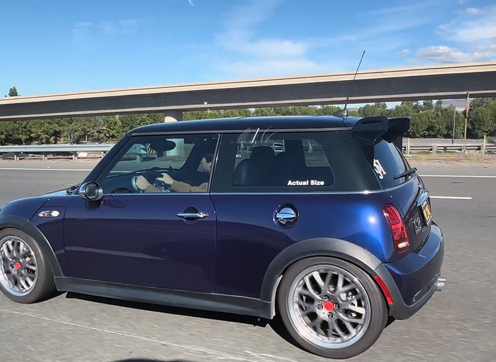

We had also installed the Orranje G-Wing GP Style Spoiler. I really like how it re-shapes the side profile view in the back end.
Rear taillights had fogged up with moisture and bugs so installed some union jack LED taillights.
The red MINI wheel center caps needed replacing due to fading.

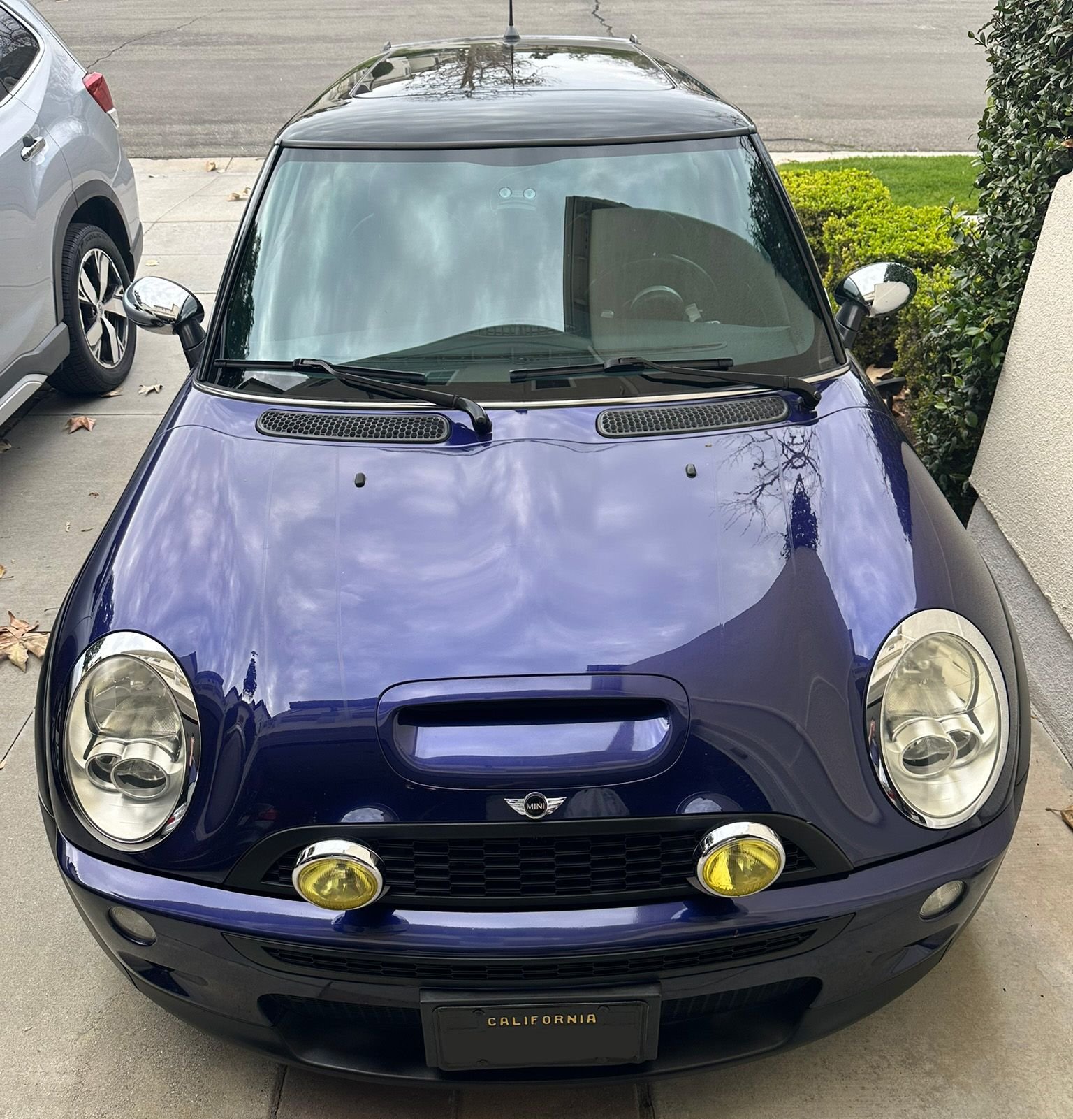

My bonnet stripes started to wear over the years. Presumably from the buffing by my detailer every once in a while. It got to the point I decided they look too scruffy, especially the silver pinstripe highlights on the sides of the 4.5" black vinyl strips.
Well, it took me and the 2 detail guys 2 hours to get those off! They were baked on and baked in. For some reason the silver stripes etched into the paint a bit. We color sanded, buffed with different compounds. Got it as good as possible.

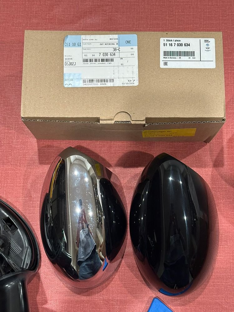

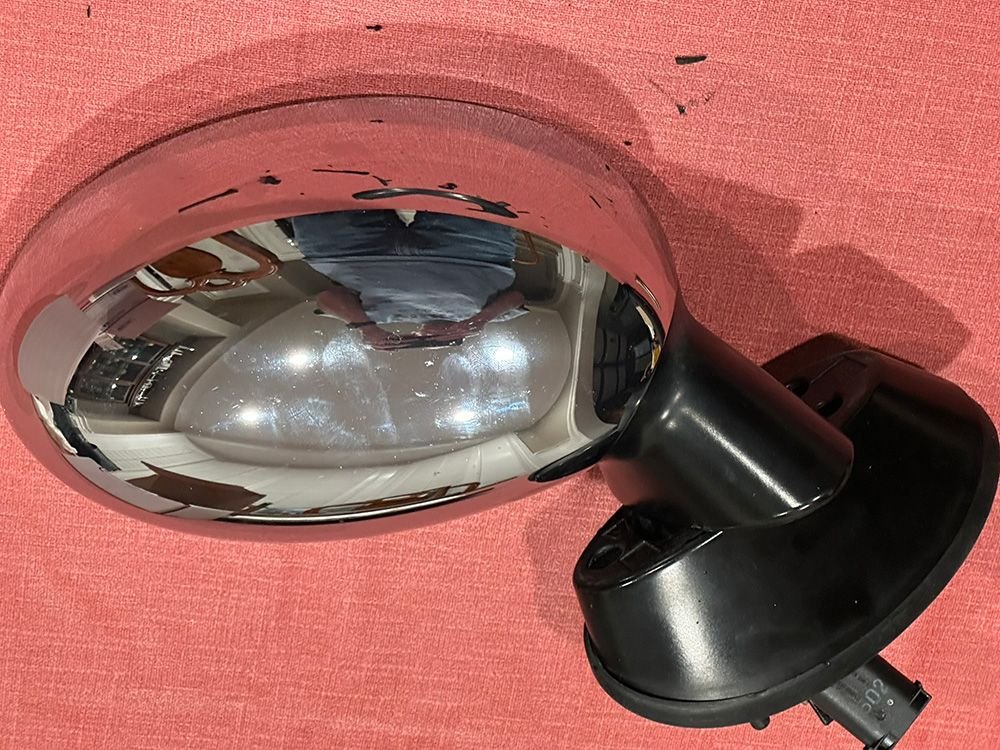

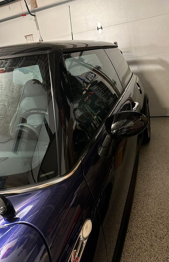

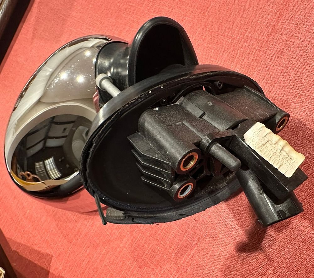

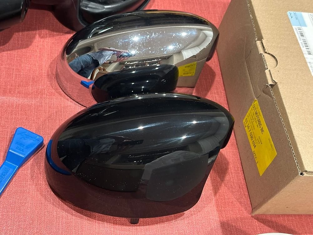

Back to the excess chrome, I wanted to get some black mirror caps, not the tape on version, but replacements.
Checked around for some time but couldn't come up with much, so decided to bite the bullet on some overseas eBay junk. Yep, total junk. I received them and found that they did a pretty good job reverse engineering them if you DON'T count putting the left side mirror's 5 snap's geometry on the right side mirror. And, the right side mirror's 5 snap's geometry on the left side mirror.
It's interesting how MINI's engineers designed the 5 snap's geometry on the left and right mirror asymettrically.
Anyways, major eBay battle, but since they favor buyers so much now, got a refund.
Then saw an R53 that had black mirror caps just arrived at a pick your part not so near us. Sent my son to grab them and those unfortunately turned out to be beyond repair and unusable.
So, as my new saying goes, Buy nice, or buy thrice.
Picked up a set of OEM MINI "primed" mirror caps from major parts vendor. They showed up and only 1 of 2 was primed. Used my old guy that did my bumper years ago to paint them black for me. Mo money.

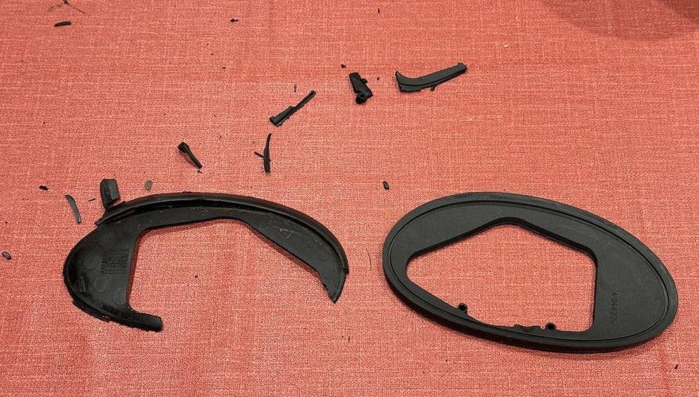

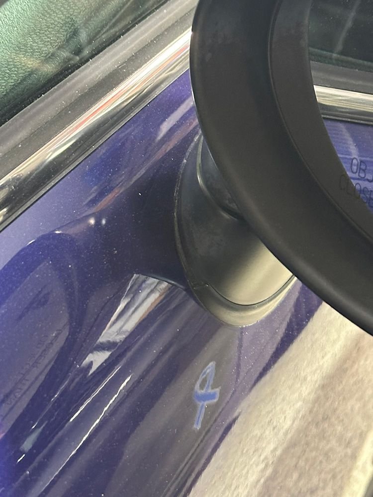

I noticed that my mirror gaskets were in need of replacement so picked up a set of those too. OEM this time straight from the start.
Installation went OK. I think it's almost impossible to remove the caps without breaking any snaps (at least on 20 year old caps). Not a huge deal here, but I found re-attaching the new caps very difficult to line up the 5 snaps at the same time, and this is with my mirror completely off the car in my hand sitting in a chair in my house with cotton gloves on.

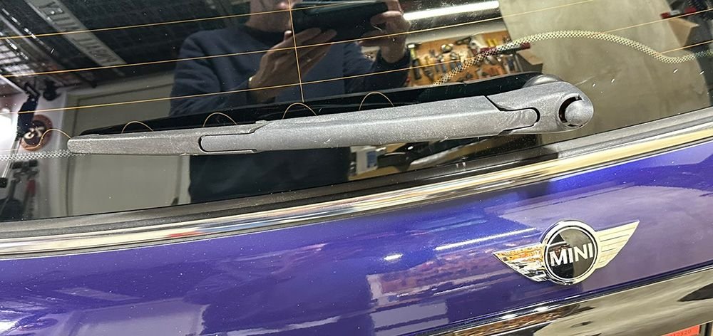

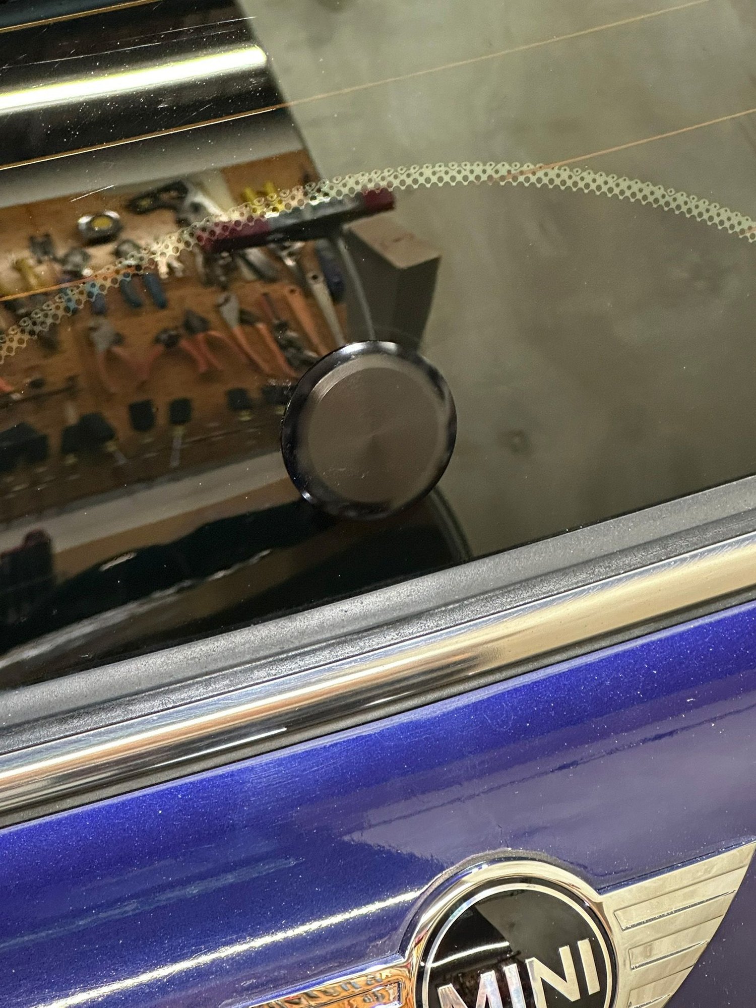

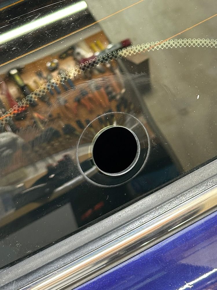

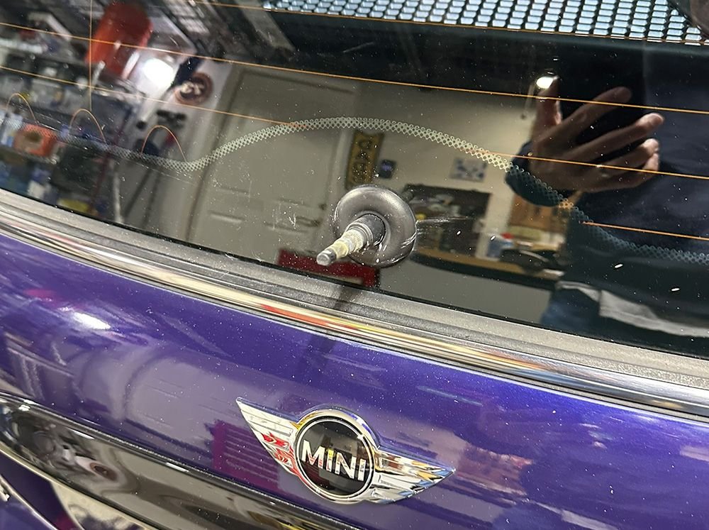

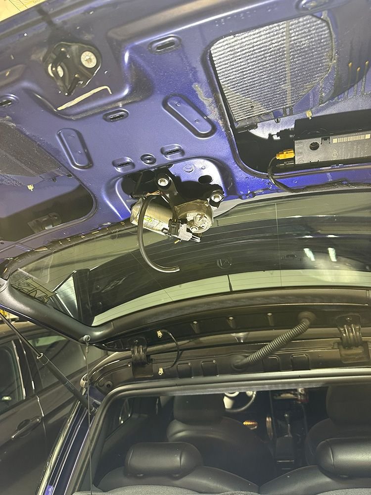

I recently saw a cool lowered yellow VW Golf with RPF1's and a rear wiper delete and thought, that would look clean on the back end of this car.
I got the billet aluminum one from ECS and it's really nice. Just spit on the incredibly thin o-ring before you try to place the plug on the window so it doesn't fall out.
I like the look..... My daughter texted back "hey that thing was pretty useful" when she saw the pics.

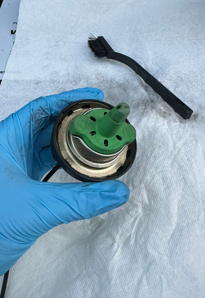

I had gotten a 456 Fault Code - tank venting system very minor leak detected - and found the gasket on my gas cap was pretty cracked up.
Found that a proper replacement for R53 gas cap is NLA. The part that MINI superseded the old versions with is quite a bit different and sellers don't understand that the tether is too short to stretch to the mounting point on the car when the cap is in the holster while refueling.
So, I wound up buying a new gasket from RKXTech on ebay and it looked a bit different but seems to actually be the correct seal. Don't get all nervous like I did when it showed up
I tried cleaning the inside and outside with some MAF sensor cleaner.
Anyways, it's on the car now. Hopefully no more error codes.

"Actual Size" I laughed out loud, which doesn't happen too often
NIce!

Yep, my dad had me make that decal for him back when he purchased the car new in 2005. Since we've gotten it, I've had to replace it a couple times due to wear. My neighbor once told me he laughs every time he sees it. haha
