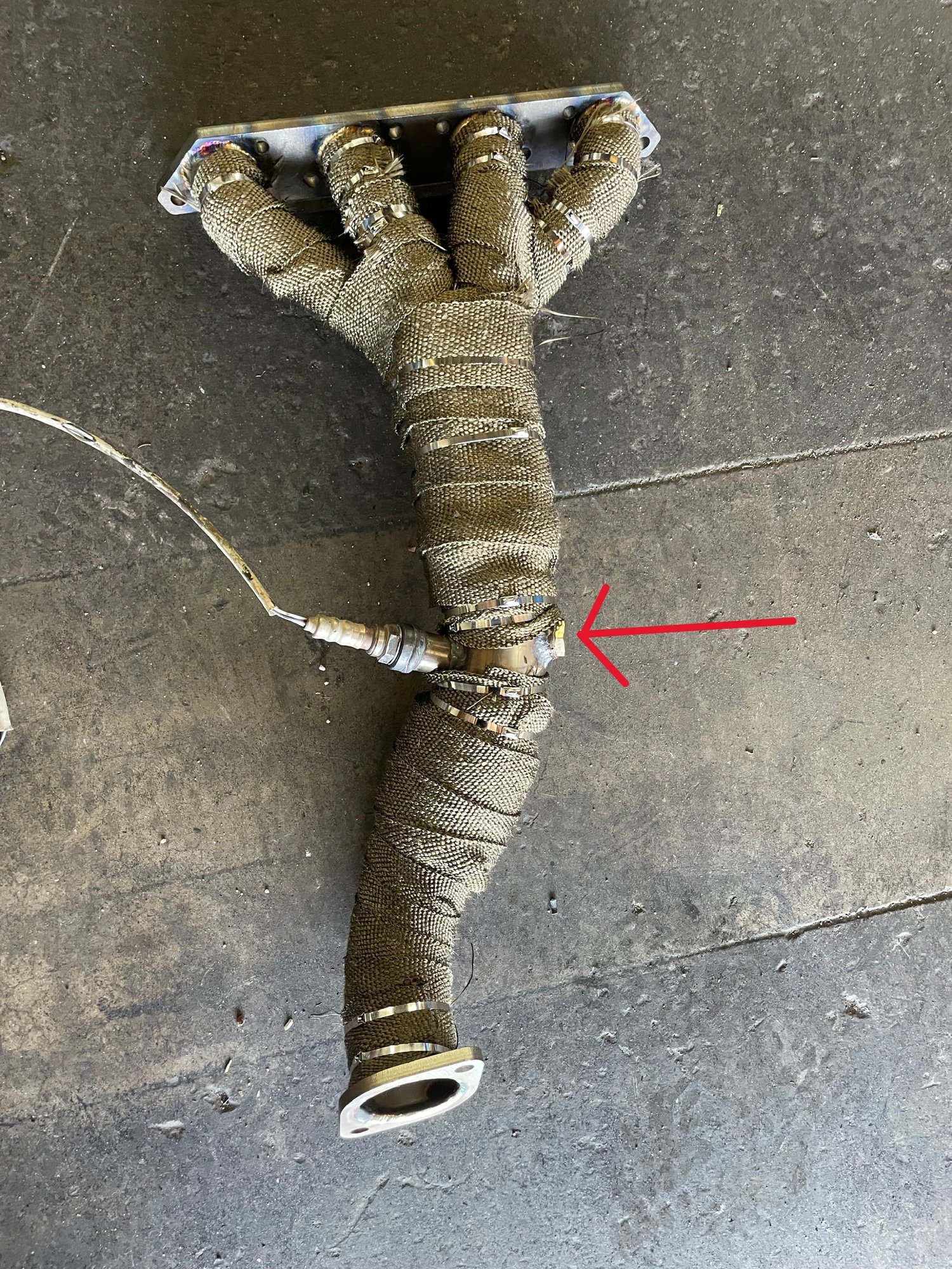

Instructions for installing the wideband sensor for my gauge are to put it as close to the collector as possible. Upstream of the catalytic converter.
I had a bung welded in for my wideband O2 prior to installing my Milltek header. I have it marked in the picture.
I had temporarily installed the header to choose this location. By my testing, the sensor should fit. It may be close to the bulkhead though.

For an in car gauge, most recommend putting it at the collector (that's where mine is). There are pluses and minuses for both location from a tuning perspective but I'm not an expert who can talk on this topic much. The tip placement sensors are only for dyno tuning and good tuners can get the info they need from it.

thank you, both. that location makes sense 🙏
