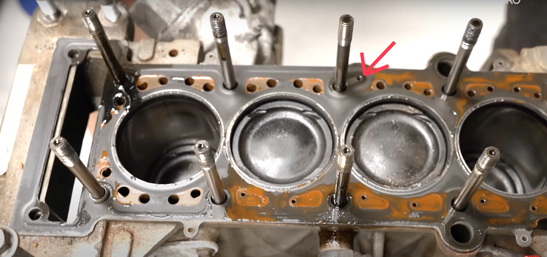

The head is off
So far, I am still not sure why the valve was burnt. And why cyl2 and 3 have washed out areas (the washed out area is on the exhaust side, btw). One thing I noticed when disassembling: it was kinda too easy to unbolt the head. Maybe that is why the leakdown test for cylinders 2 and 3 was 16% (vs 4 % for cylinder 1 and 4).
Now I need to decide what to do next. I think I will go ahead and remove the block from the car to bore the cylinders to 77.5 mm and replace pistons.
Will remove the exhaust valves for cyl 3 for inspection of valve sits as well.

Pistons are out. The rod bearing looks super bad for just 30K. Probably, due to oil starvation and pollution.
