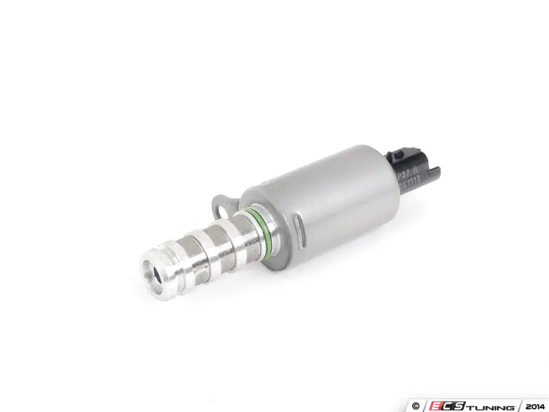

In case anyone comes across this post in the future, I'm 99% sure i figured out the problem. It was a faulty VANOS solenoid. Not that it was dirty because i made sure to clean it when i rebuilt the head. But the solenoid itself seemed to have failed and was messing with my timing causing the engine to sputter and die. Replaced it with a brand new solenoid and she's running pretty stead now, a few more issues to iron out but no longer any RPM fluctuations or premature shutoff.
Special thanks to this dude and his channel. Apparently the Vanos solenoid can fail and throw no codes. He had a similar issue to mine so i thought i would try what he did.
Old Aug 7, 2023 | 09:20 AM
Posts: 36,762
Likes: 2,551
Most of the time its the clogged vanos. I think the clogging makes them fail even after they are cleaned out, like it beats them up and they fail. The updated units also have the screen.
Glad you got it fixed.
