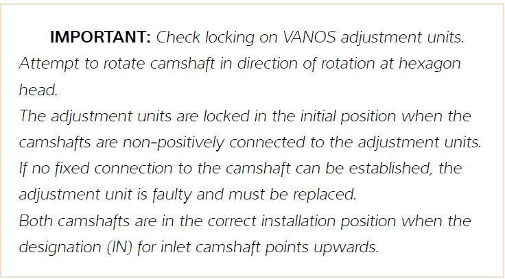

Bo_9, I just had the same problem with the 2009 N12 I restored; The engine had misfires in cylinders 1 and 4 due to dropped valve seats. The mistake I made was I skipped the "check timing" in the disassembly instructions of TIS (technical information system); I didn't think I needed to "check the timing" since I was disassembling the engine and was installing a lot of new components.
Here's the catch on the check engine timing part of the manual. After installing the pin in the crankshaft and before installing the camshaft locking tool, there is a note that tells the tech to attempt to rotated the VANOS adjuster (the sprocket) center bolt. With no oil pressure, the VANOS adjuster should be locked so there is no relative motion between the sprocket portion that is driven by the timing chain and the center hub that is bolted to the camshaft. If there is movement in this step the VANOS adjuster must be replaced. The reason replacement is required is that during reassembly, if the adjuster center hub moves when you tighten the center bolt, your timing will be off.
In my case, I failed to make this check and installed the old VANOS units; the engine ran OK, but I knew something was off; I pulled up the VANOS adaptations on my diagnostic tool, and I was at 12.5 degrees. Afterward, I ordered two new VANOS adjusters from eeuroparts.com and went back to the "check timing" step. Both of my adjusters were shot. I installed the new adjusters, set the timing by the book, rotated the engine, and rechecked the timing ... good to go. Then I cleared the VANOS adaptations, eccentric shaft adaptations, and fuel adaptations. If I remember correctly, the exhaust adaptation range is 140-160. I'm running at 153. Intake range is from 40-60; I'm running at 53. The engine runs much better now, and my smooth running values are near zero for all cylinders.
Oh! Another thing that caught me off guard with this restoration project was the valve lifters; I found several that were stuck and almost all of them were not within height specs; I replaced all the lifters, and valves.
Lastly, restore your PCV system to as designed.

Here's the note from TIS
The note can be a little confusing ... I think that's due to the German to English translation. Bottom line, when you try to rotate that center hub bolt with the crankshaft locked; there should be no movement. I had several degrees of rotation with my old adjusters, and zero movement with the new ones.

Finally got back to this project. Cam was not locked when we pulled the valve cover. Rotated about ten degrees and locked with no movement. I'm assuming that it should be locked when shut down. Ordered VANOS gear, solenoid, and bolt also installed the correct hoses to put the rear PCV back to stock.

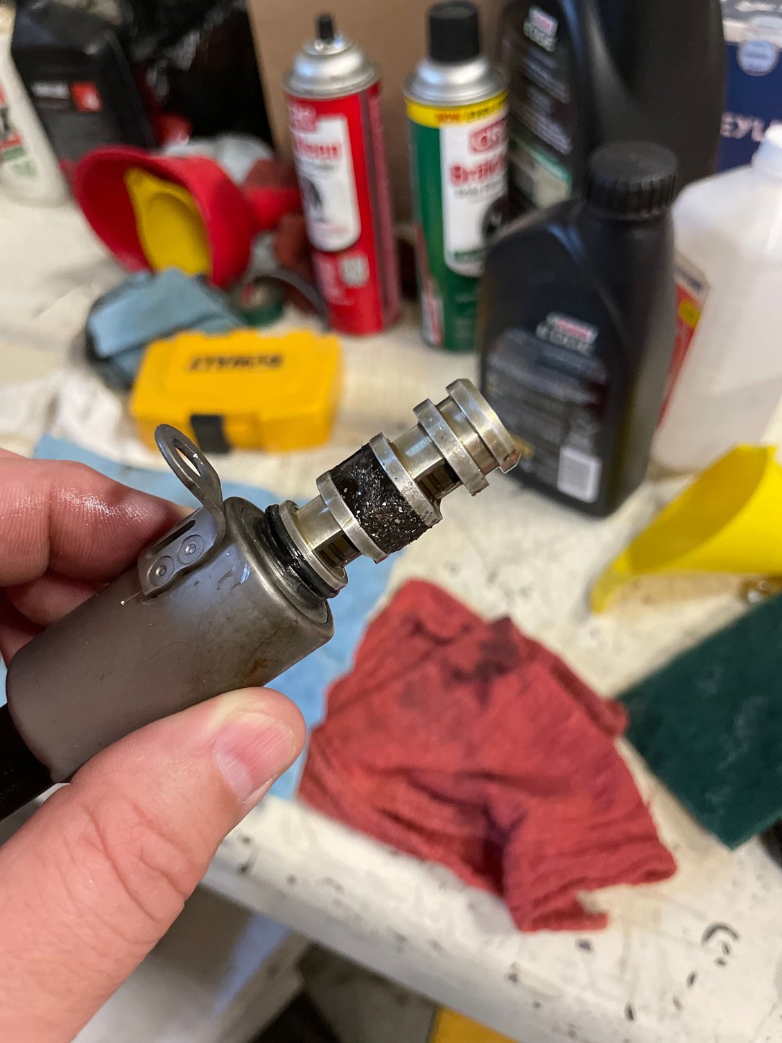

VANOS solenoid had a screen on the middle section only and it was completely full of crap so changed that it.

All kinds of nastiness in the VANOS solenoid and as previously mentioned the gear was never locked in place when checked it. So replaced both and it's now an amazing little engine and this thing is an air-conditioned go-kart!
