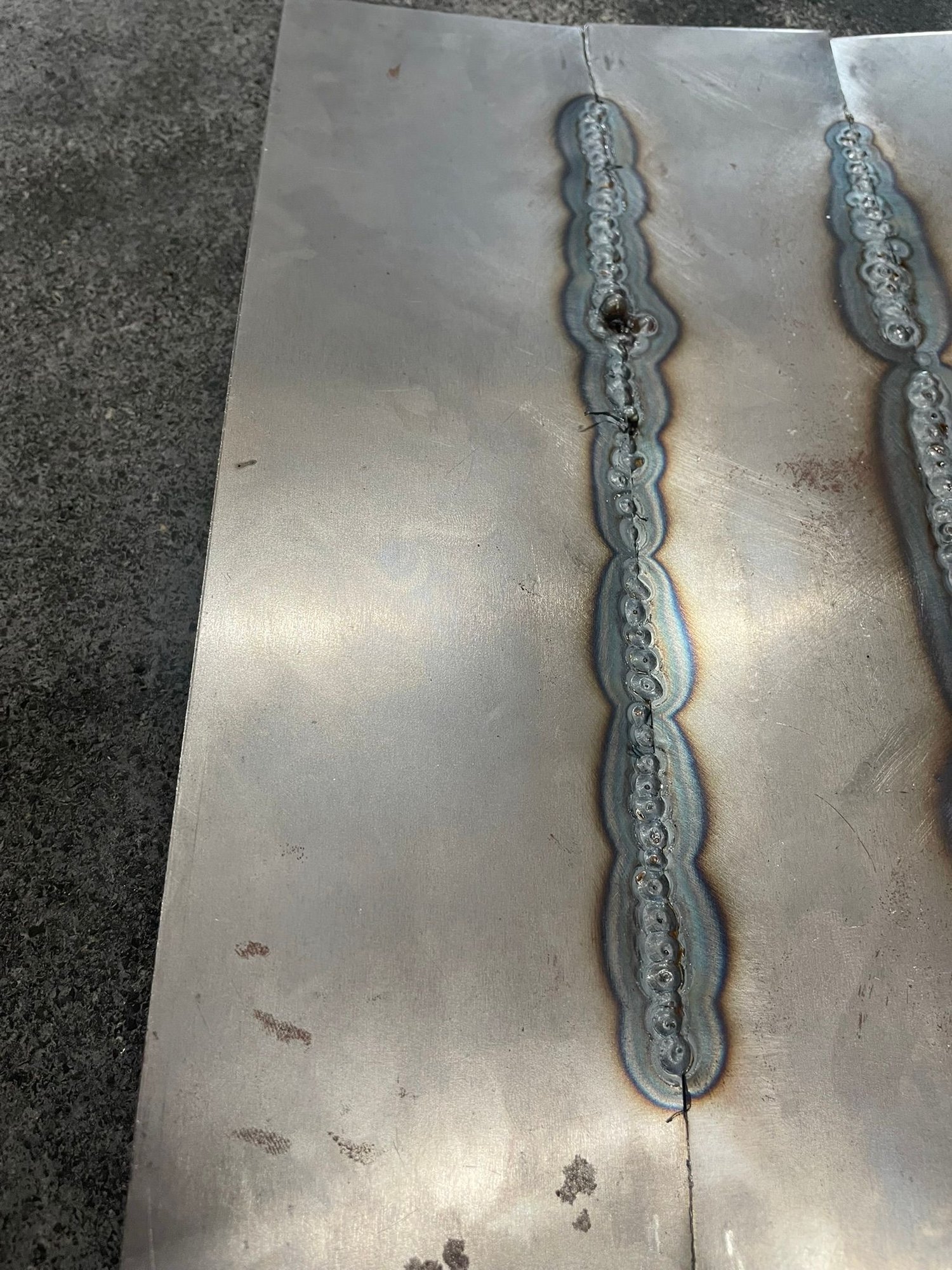

well its harder to weld than i thought it would be. here is my last practice run, on my first day / time trying.
im getting warping. I guess i should slow down? move the spot welds around more? use compressed air for more cooling?

Indeed correct, warping is from heat. Best to move around and do stitches at a time. Or turn your heat down, but you'll loose penetration. Watch some YouTube on techniques, you'll be an all-star in no time!

yes definitely going to need more training. how much penetration is best? let me get a pic of the back side

Ideally you want to melt the two pieces together, and not "bond" them together. From my experience, playing with different gauges, and finding the melting point helps. Turn your temp up until your melting and blowing through the metal, then back it down until your slightly melting but also building instead of blowing through. It's a fine balance but once you learn gauges if metal you will instantly have a clue of how much heat can be applied.
Problem with not having enough heat is again your basically bonding like glue and not forming 1 piece and when it breaks you'll see the weld is actually ontop of the metal and not formed into it.

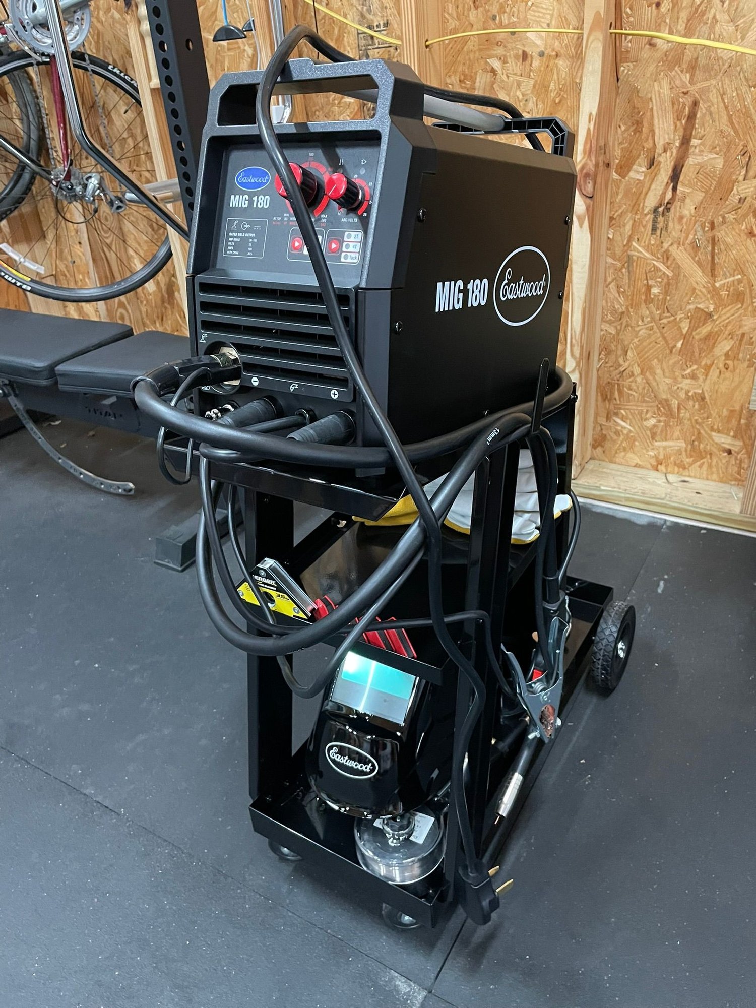

ended up with this setup (let me find a pic). the price was right
picked up an 80cuft argon / co2 tank to go with it

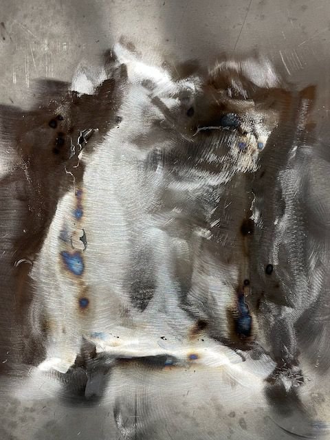

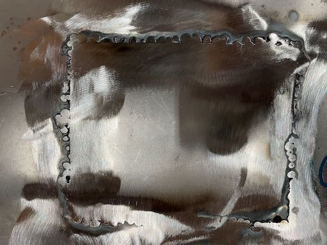

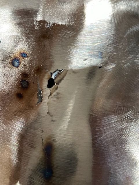

quick update. here is my latest attempt in pics. this is a 4 inch patch in the center. I'm still getting some warpage and, more unfortunately, burn through.
the burn through happens at spots where there is gap. the HARD part is getting the patch to fit without gaps.
I'm wondering if I should not just lap weld a patch. lap of about the size of a spot weld. so much easier. not a good idea?

Prefacing with I'm another amateur but a little further down the road from you. I bought a hobart handler 140 when they were $500 and got an entire setup with C25 canister new for under $1000 total around 2015. I have welded in two floor pans and several rust repair sections on a total of 5 vehicles so far. MIG is the metal hot glue gun.
It looks like you are figuring things out. Like your stated goal, "just looking for something to do the occasional basic thing."
Looks like you're practicing on thin sheet. For thin sheet metal (most of automotive welding), heat/warp/burn-thru is the enemy. You can mitigate heat by doing individual tacks rather than a bead. You figured this out. But instead of doing 5 tacks in a row and then moving (as it looks like in your first welding image - post #20), move after each individual tack. AND this was a big tip for me - don't point the tip 90 degrees to the metal - the stinger will be pushing welding wire thru the thin sheet and asking to burn-through. Point the stinger obliquely, over the seam but angled sideways 45 or more degrees into one of the sheets. This makes the effective cross-sectional area of the metal thicker (from the perspective of the stinger) than the actual thickness of the sheet.
Some other things that can help - thinner welding wire. Going down to 0.025 is helpful. Backing with a copper heat sink paddle can be difficult to set up but can work. And absolutely minimize the gaps - bridging gaps is asking for burn-through.
Be wary of grinding welds down too much to make them all pretty - you may be creating paper thin areas and not have any idea. It's not easy to check thickness when you're done. When rust comes back it'll eat thru thin parts quickly. If it's not a cosmetic area it might be worth leaving the welds. Even if it's cosmetic minimize the grinding/flap disc. You should expect to need a small amount of body filler. Regular bondo (don't get the 5 minute quick set stuff it's more trouble than it's worth) and the bondo finishing glaze (the finishing glaze is really nice).
Weld-thru primer is helpful but not the panacea some claim it to be. Proper paint on the backside is always better when it can be done. Cavity wax (or fluid film with a cavity tip) is another option.
