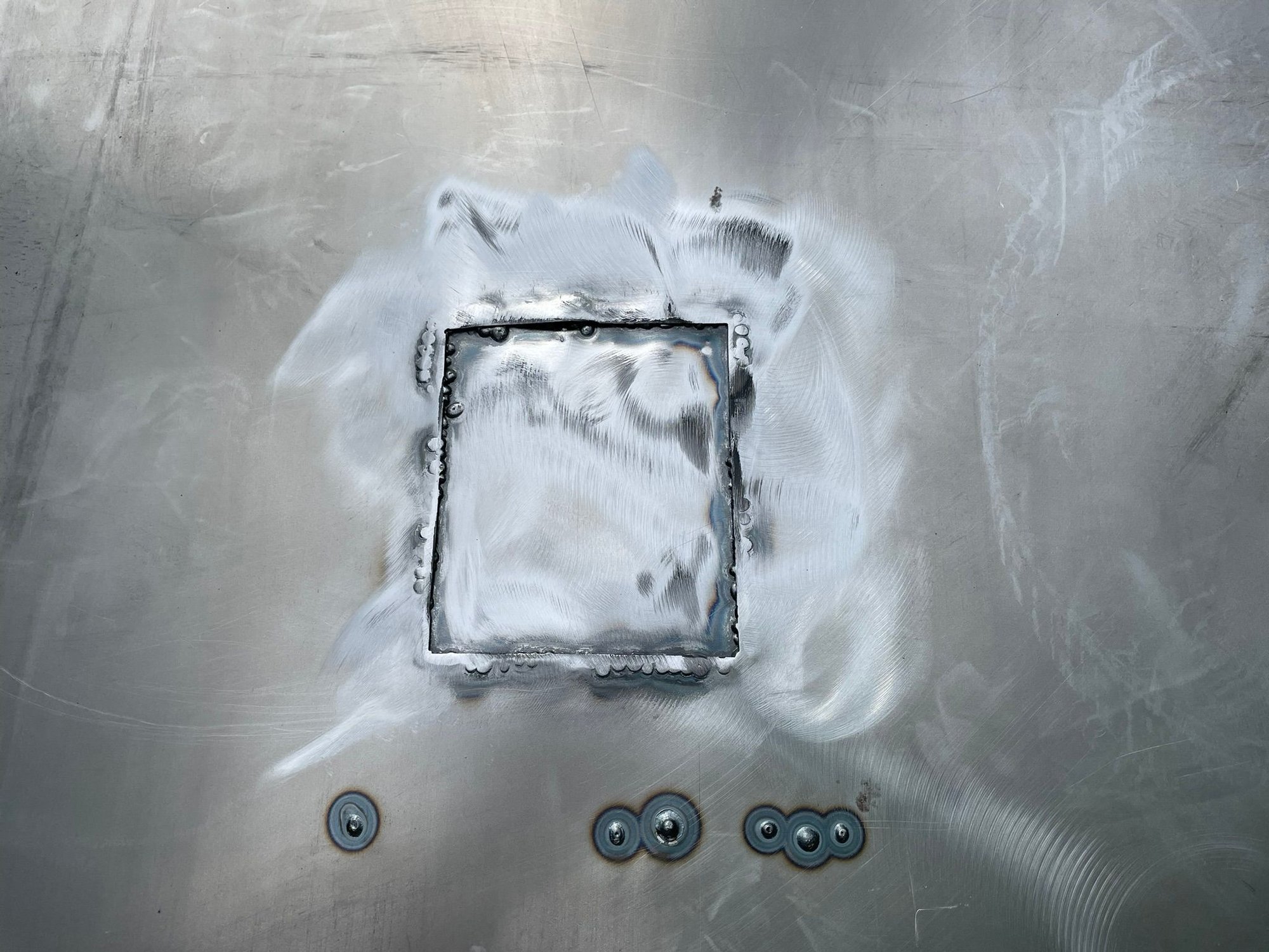

Old Apr 8, 2026 | 02:40 PM
  #34
ssoliman's Avatar
ssoliman
Joined: Feb 2018
Posts: 1,755
Likes: 336

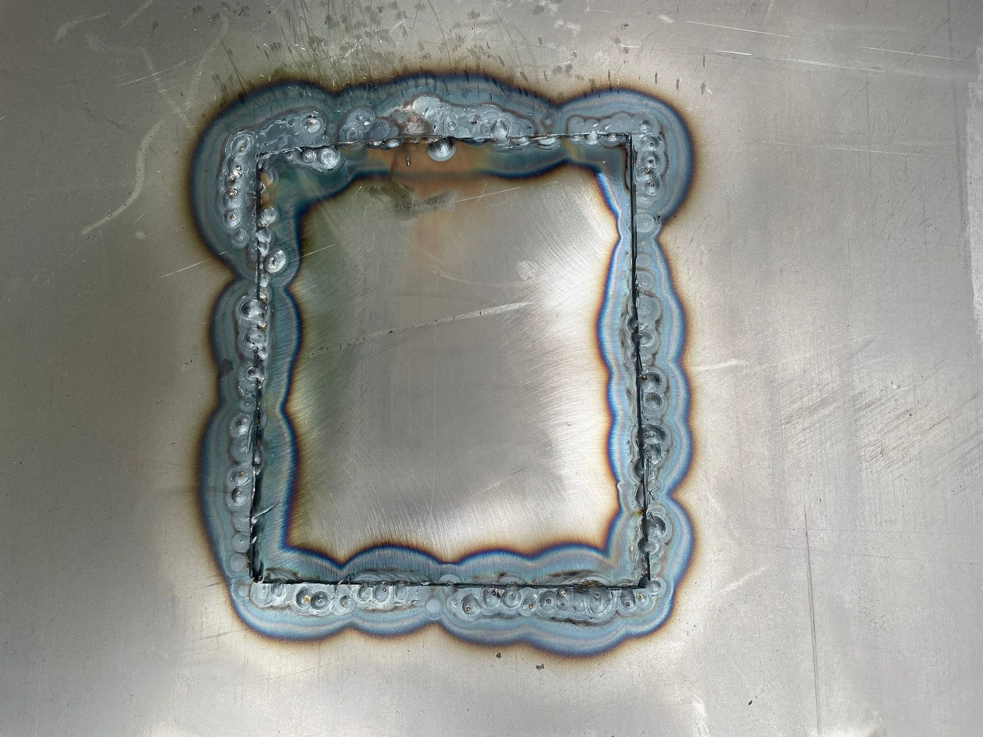

my latest attempt. i overlaped by a few mm. i would then prep the metal and put sealer on top and bottom, followed by the standard paint process
do yall think this level of quality would work or should i keep practicing? be frank.

what do you plan to weld? if you're replacing rusty body panels, i don't want to beat a dead horse, but you're gonna want to butt-weld them instead of overlap.
also, i would suggest getting some thicker pieces to practice welding. sheet metal can be tricky. you have to tack weld repeatedly vs trying to get a bead working.
Old Apr 9, 2026 | 11:55 AM
  #36
ssoliman's Avatar
ssoliman
Joined: Feb 2018
Posts: 1,755
Likes: 336
it will be a patch in the floor pan. 4 inch by 4 inch patch. 18ga. thats it.
practicing with 18 ga. figure i'll need to be able to weld that, so practicing with that.
butt weld is the right way, i get that. i'm not very concerned with appearance because it will not be visible. Covered by epoxy, sealer, primer, paint
I do want it to last

I would think that overlapping would invite space for that to start rusting on the backside of the patch. Maybe weld it up on both sides if possible. Definitely do something to address the back to prevent future rust.

good thought. I'm going to give it another go with the butt weld also
last time i tried the butt weld was with 20 ga. harder to manage

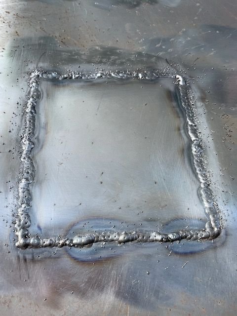

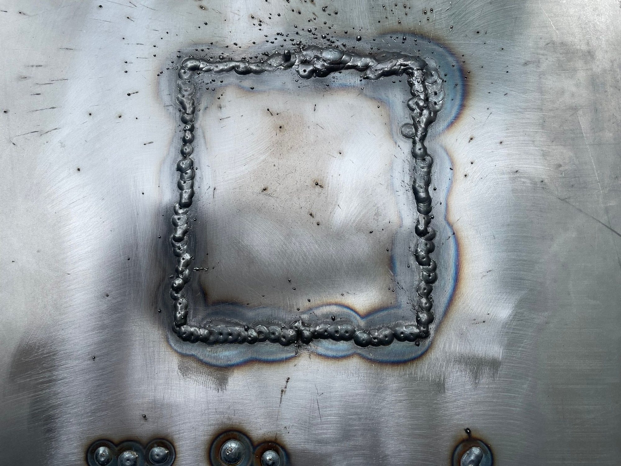

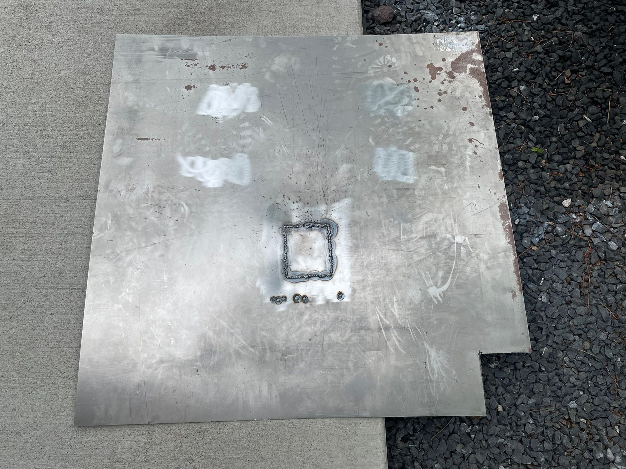

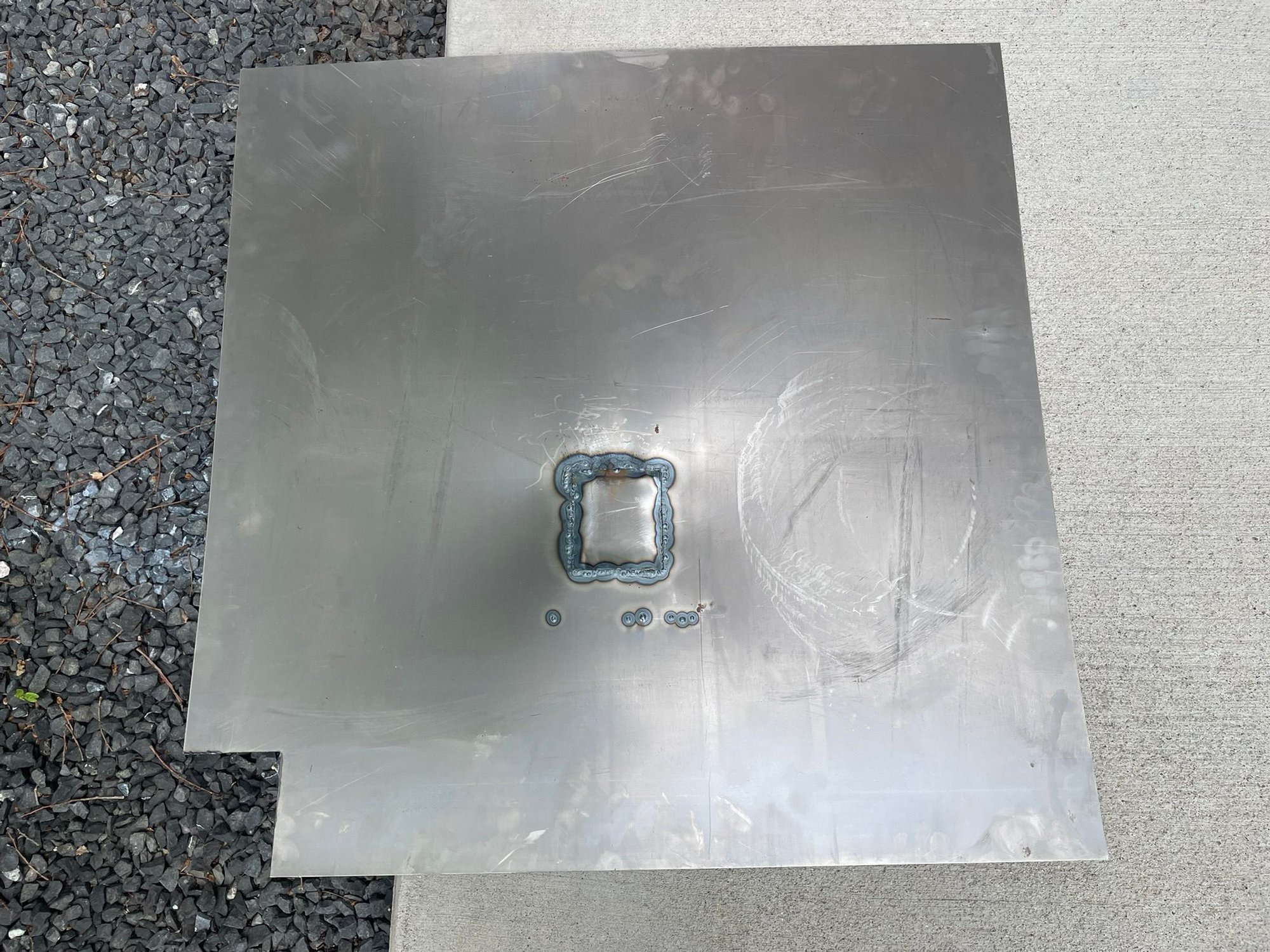

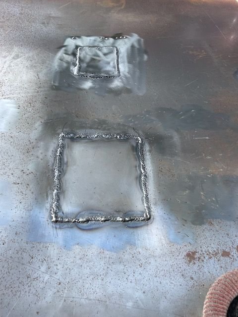

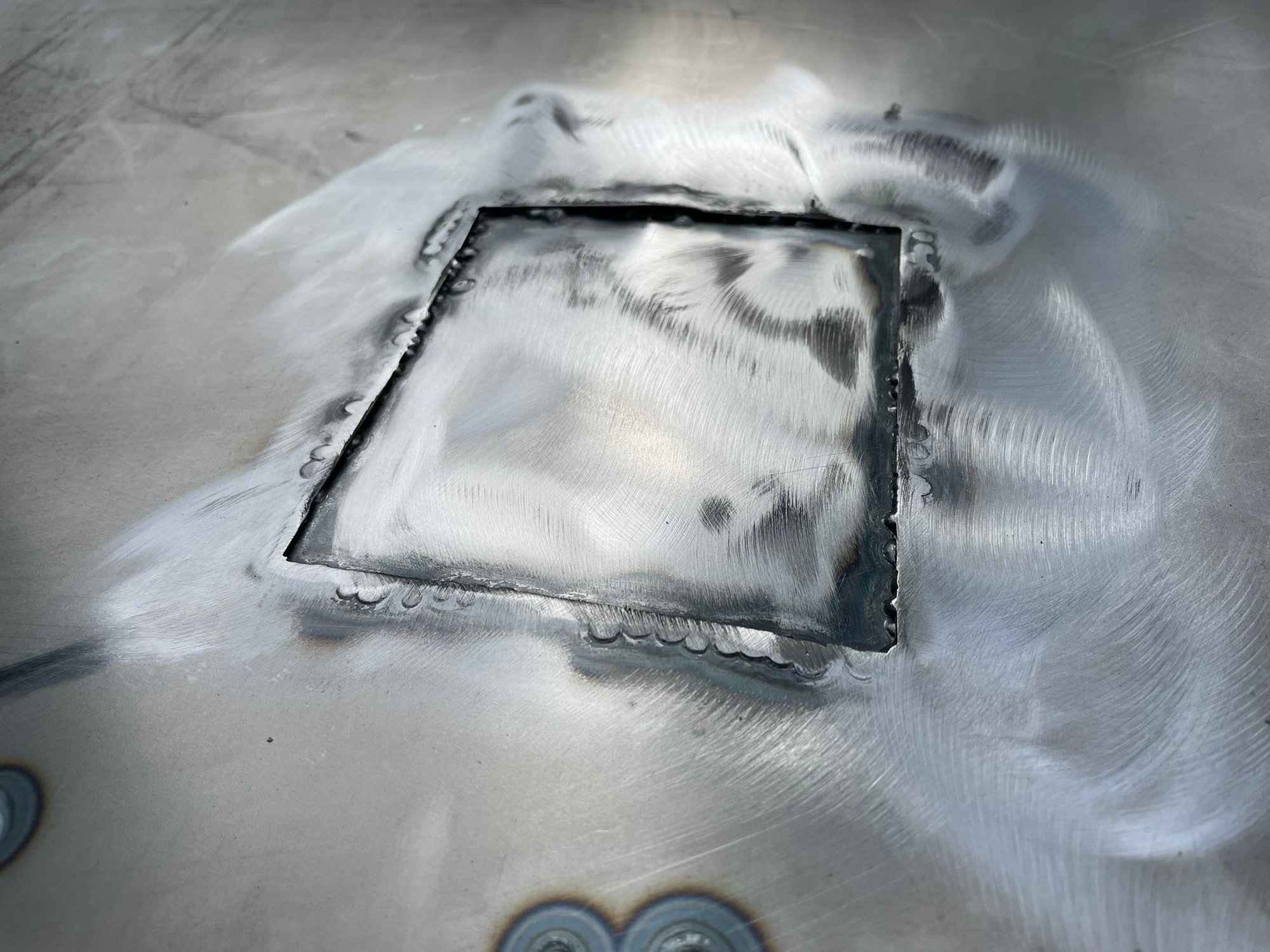

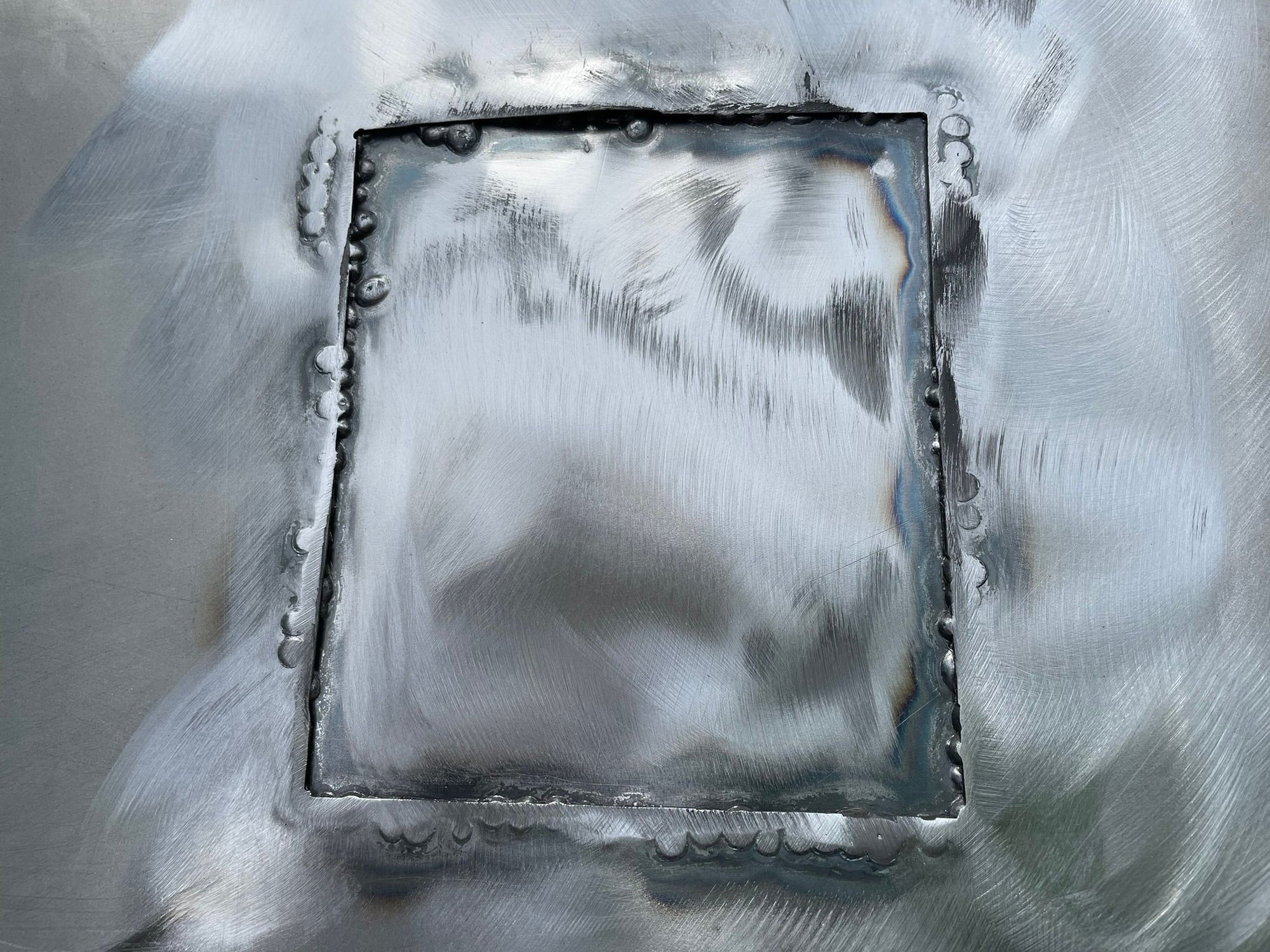

tried again. this time a butt weld. something that I learned this time is to start the weld on the edge of another cool spot weld. less burn through that way.
where it did burn through in three spots I was able to use a copper backer to fill the holes
let me post some pics
Old May 6, 2026 | 05:23 PM
  #40
ssoliman's Avatar
ssoliman
Joined: Feb 2018
Posts: 1,755
Likes: 336
front side, before grinding down the welds

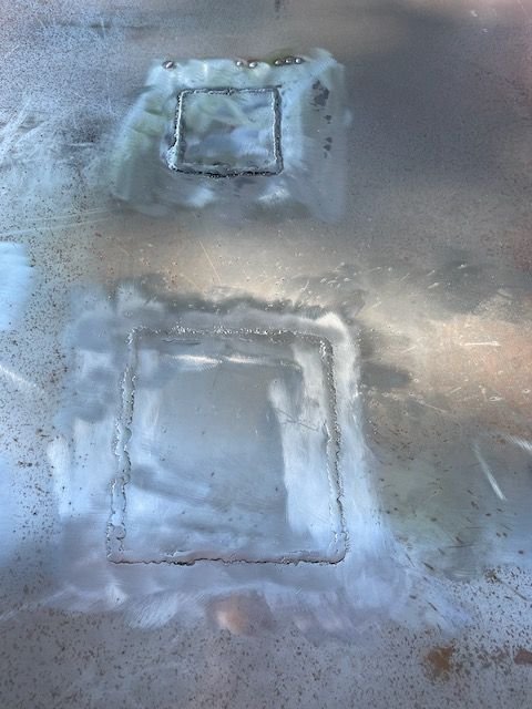

Front side, after a bit of grinding

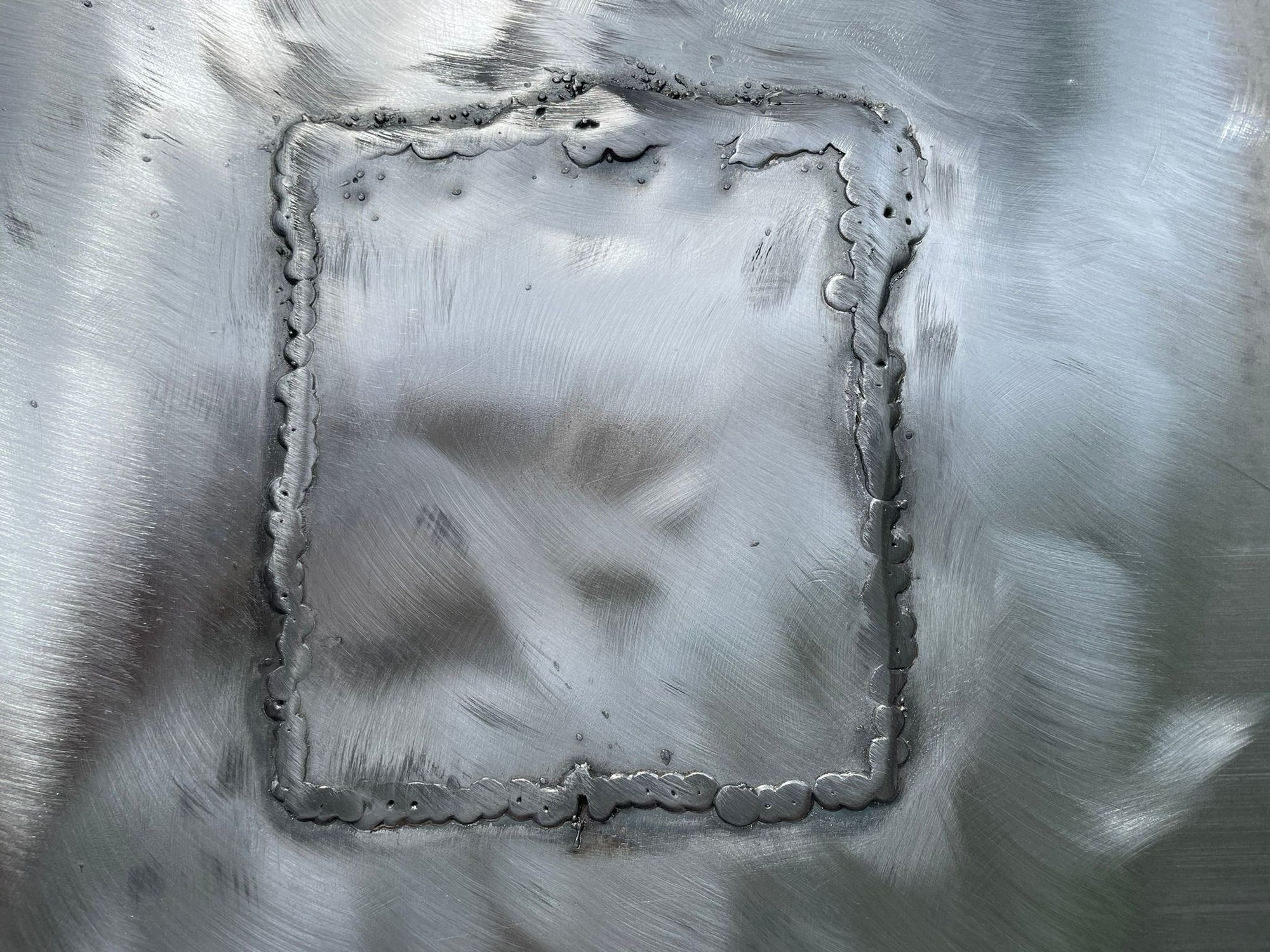

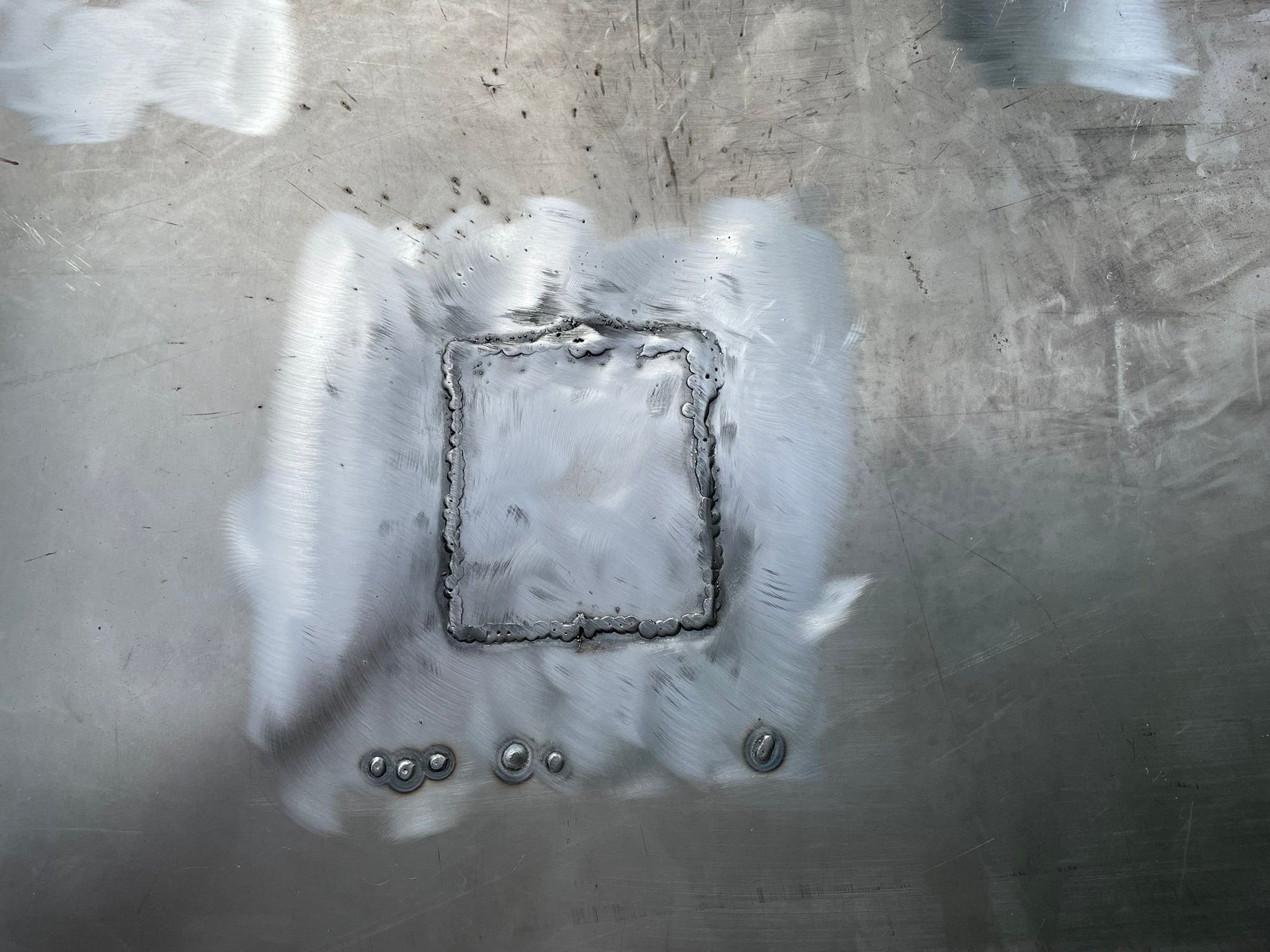

back side. no grinding

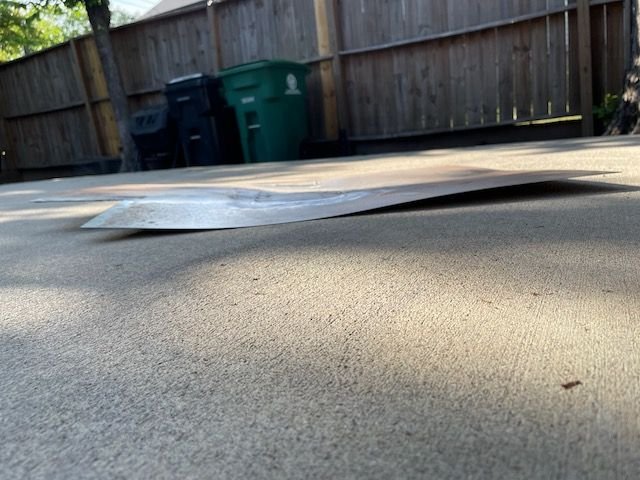

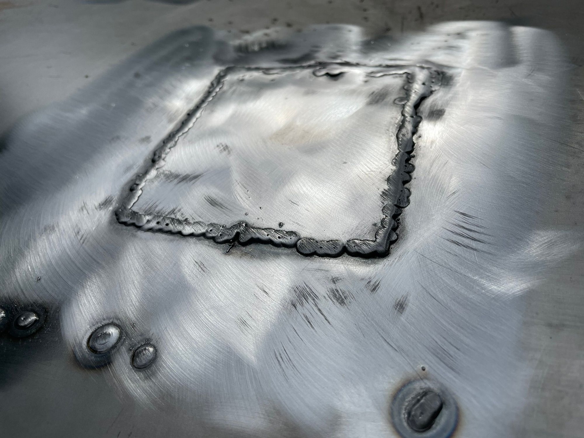

warpage

i don't think i'm really giving new information, but that looks like you're getting it too hot. maybe give it longer to cool between spot welds?

yeah i struggle with waiting. i think your right tho. its getting too hot
i had the air gun right there and was spraying air on it after each set of welds (4 at a time)

im going to try again. maybe turn it up even more (and do shorter spot welds)
really dont want to warp the floor pan and cause an issue for the seat bracket mount points (is that a risk?). seems like it might be
maybe i could install the seat brackets and then weld in the patch. the bracket would hold things in place somewhat, no?

Man... I'm not the one to his advice on that. But I would think doing tack welds all the way around is the way to go

what i was suggesting is just doing tack welds on alternating sides of the your work area so it doesn't get hot and warp. i watch a ton of tv shows where people are restoring cars or fabricating things for cars, and they always say to just hit small welds (not trying to run a bead) and letting it cool so you don't warp your metal. i apologize if i was unclear or sounding like i'm changing what i'm saying.
