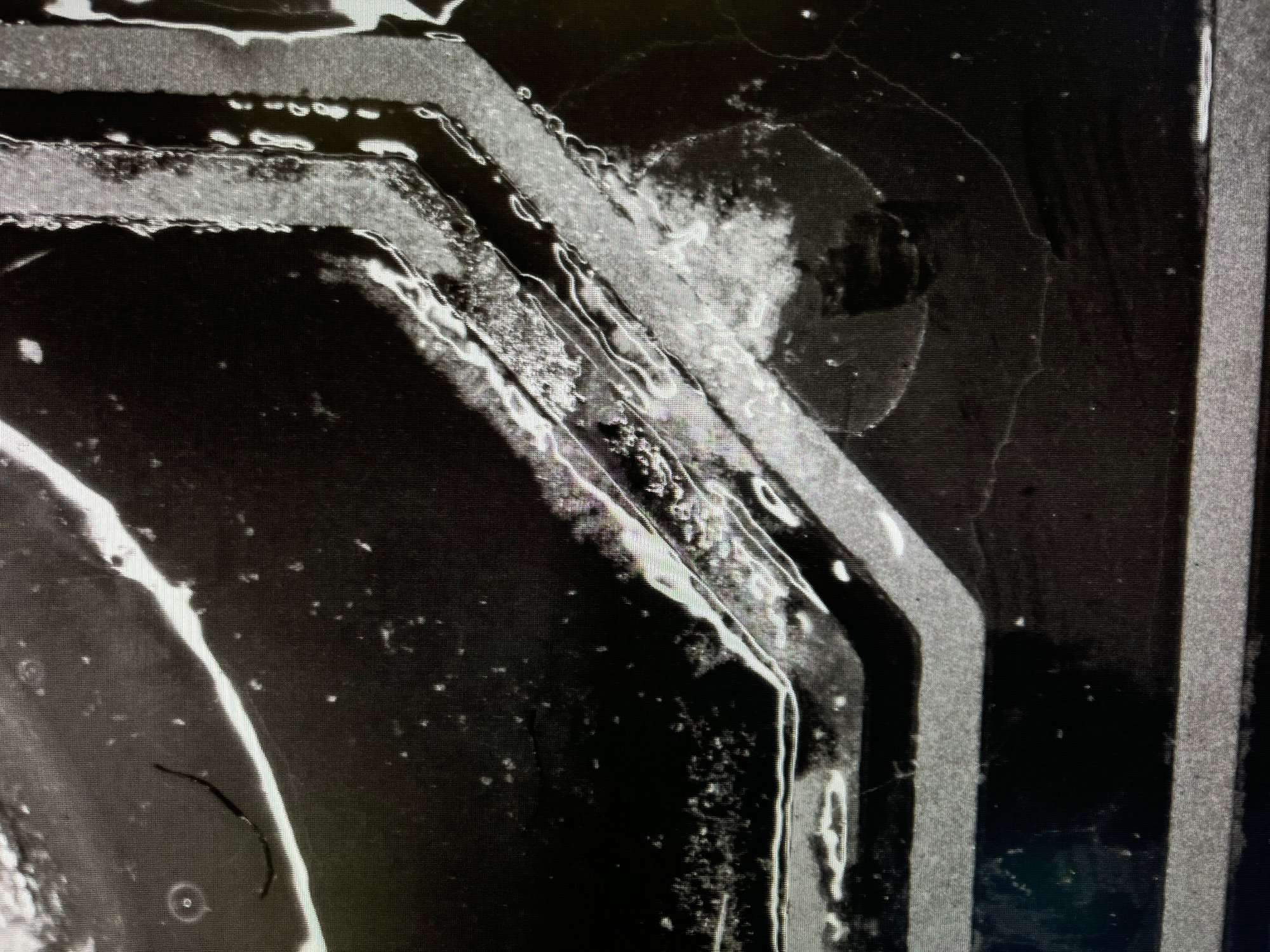

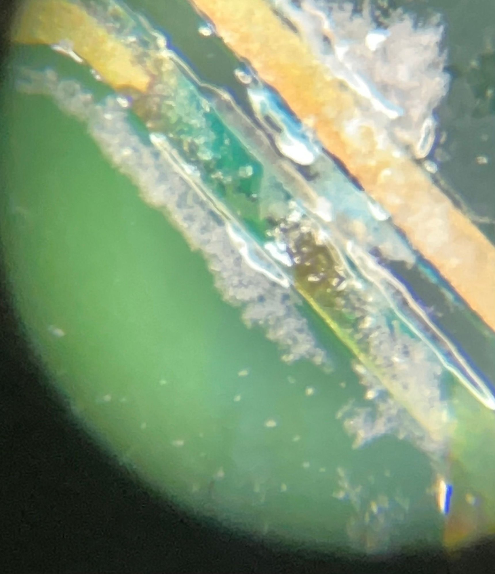

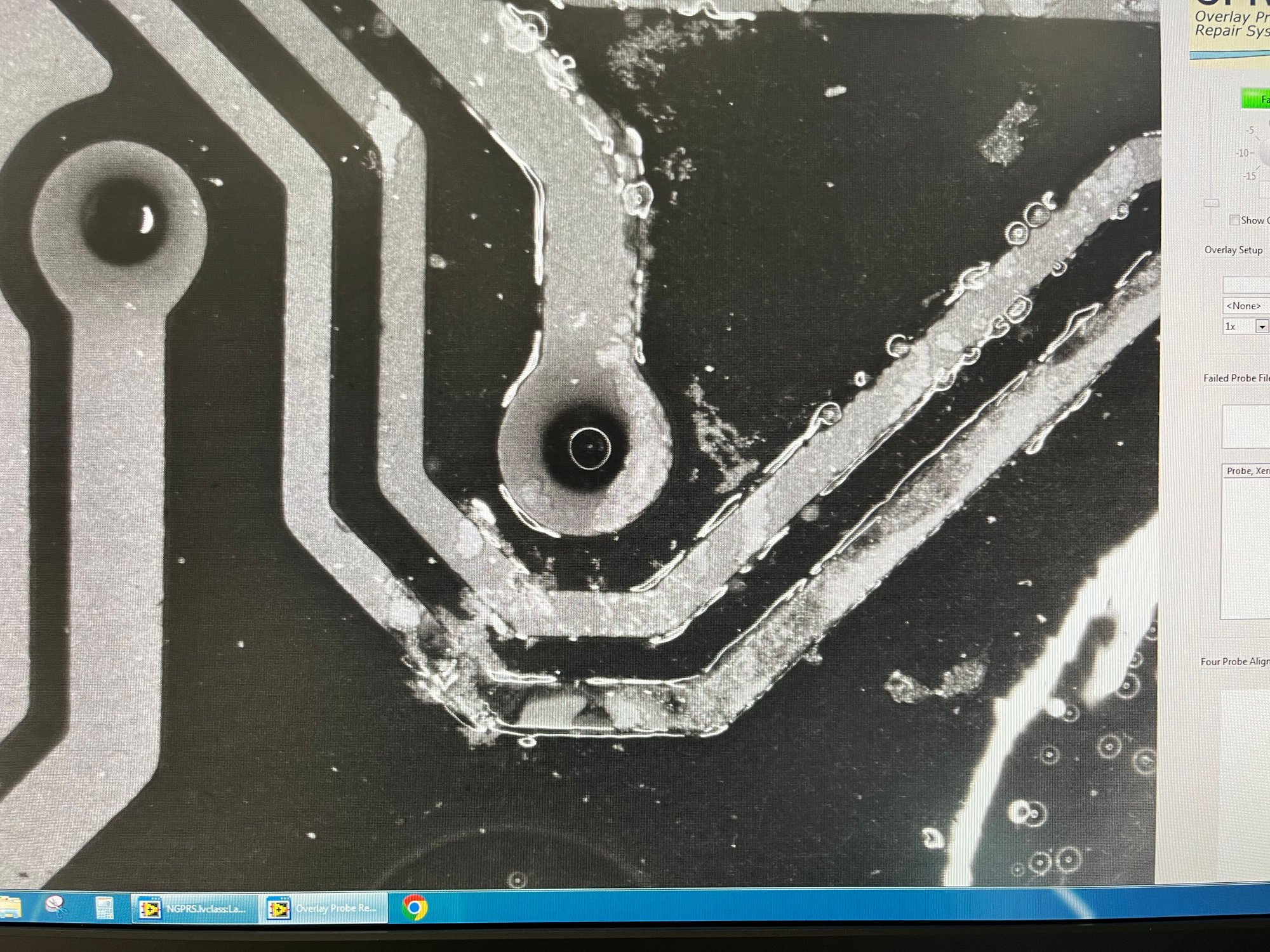

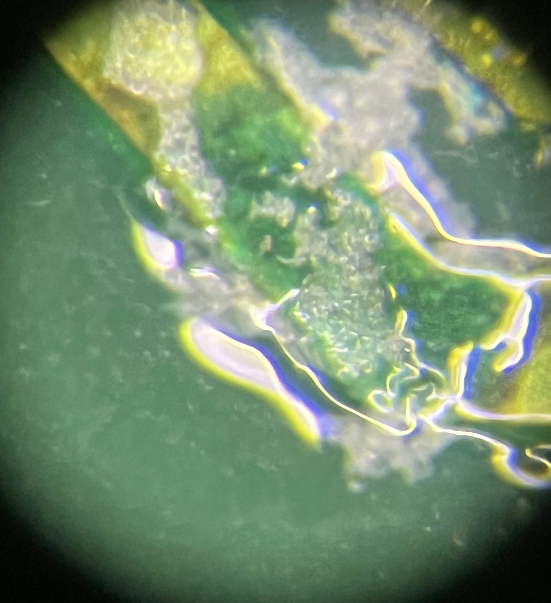

Old Jan 6, 2024 | 04:54 AM
Neil_Ireland's Avatar
Neil_Ireland
Joined: Jul 2012
Posts: 40
I removed the BCM and found some corrosion on the traces.
Do you think this is repairable?
Old Jan 8, 2024 | 08:18 AM
Posts: 36,762
Likes: 2,551
Some places clean them, re-soilder and then treat with that gel. Repair places. I have heard of some people doing it themselves, but thats with an electrical backround. If their is a bunch i would replace the whole unit with a used one that's closest to the same VIN and options or get it done at one of those repair places.
