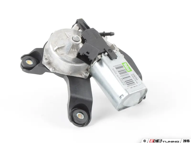

BCM or wires going to wiper are corroded.
BCM - if that goes bad it causes the lights and other things to have a mind of its own. like a low battery. Its usually not just one thing, most of the time.
Check the wires and connection at the rear wiper motor itself. The tips of the wiper spray also leak, its part of the rear wiper system and i have seen those leak back inward on the motor.
https://www.ecstuning.com/Search/Sit...h/67636932013/
