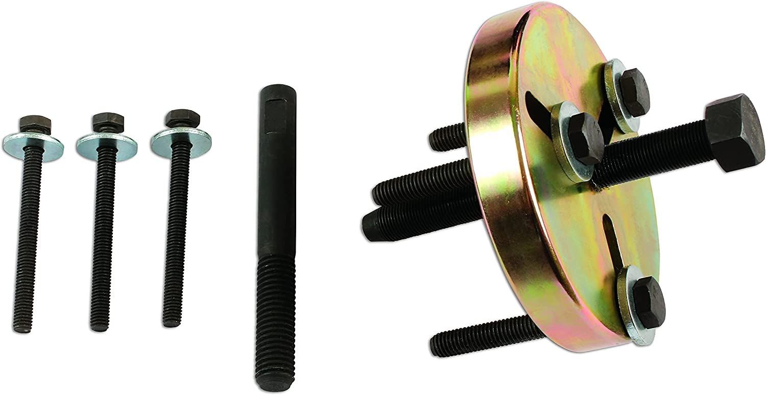

Just out of curiosity here, why are you drilling into the timing cover to remove the crank pulley? The pulley comes off real easy with the correct tool

I had ordered a new crankshaft pulley and harmonic balancer. The harmonic balancer cover with the 3 screw holes broke off upon install, and my duck foot puller wouldn't work, and neither would my 3 claw tool. I drilled into the harmonic balancer to try to remove it. I fought with it for hours trying to remove it, and ended up grinding down the 3 claws to be able to fit behind the pulley.
