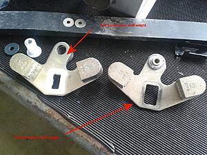

Well I didn't go full Monty as pertaining to the shift weight "delete" mod.
However, I did just finish R&Ring the shift weight bushings as mentioned above with the bushing kit from Belarus.
I had posted a write-up in the R53 Stock Problems forum "R53 hard sometimes impossible to shift into any gears" thread.
If anyone is interested.
BTW: I would be remiss by not thanking @Oldboy Speedwell for his insight and contributions.

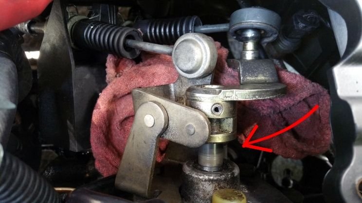

The shift weight assembly is held in by one 13mm bolt. It can be hard to spot from above but you can see it and feel around a bit.
It can be removed with a deep well 13mm socket on a pivot head ratchet. Although, I highly recommend getting/using a stubby 1.5 extension and a standard 1.5" 13mm socket which made it easier to control and leverage.
That bolt is lock threaded on there super tight from the factory! Take your time and wrench it back and forth a little at a time. It might be difficult and slow but it will come. Be patient.
A better view sourced from Detroit Tuned's web site shows the location (circled in red) of the central pivot shift weight bushing bolt location.
A view from the top as mounted to the transmission in the car. Indicated by the red arrow: The bolt is located just behind and below the main selector shaft.
You can't see the bolt in the image. but you can access the bolt head between the two shifter cable bushings.
The rag is just there to prevent the bolt from falling into the subframe after it's been loosened/while removing.
After the bushing bolt has been loosened/removed the whole shift weight assembly comes right off with ease. There is nothing else holding it in place.
Best of luck!
