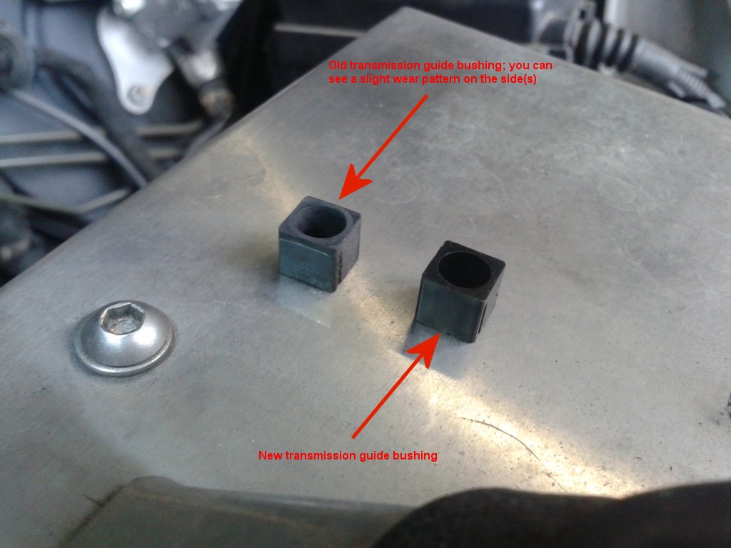

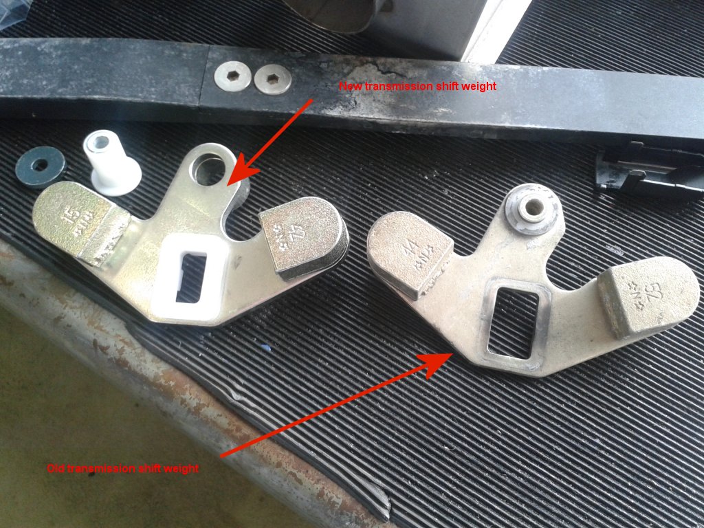

Parts were ordered a few weeks ago and replaced yesterday. The problem was the plastic guide part of the shifter weight was broken/missing. Shifter feels like new!
The pictures below help illustrate removing/replacing the parts. This assumes you know how to remove the factory air box.
Removing the transmission guide bushing bracket.
Bushing removed; accessing the shift weight.
Comparing the old and new bushings.
Hmm... I wonder what the problem was!

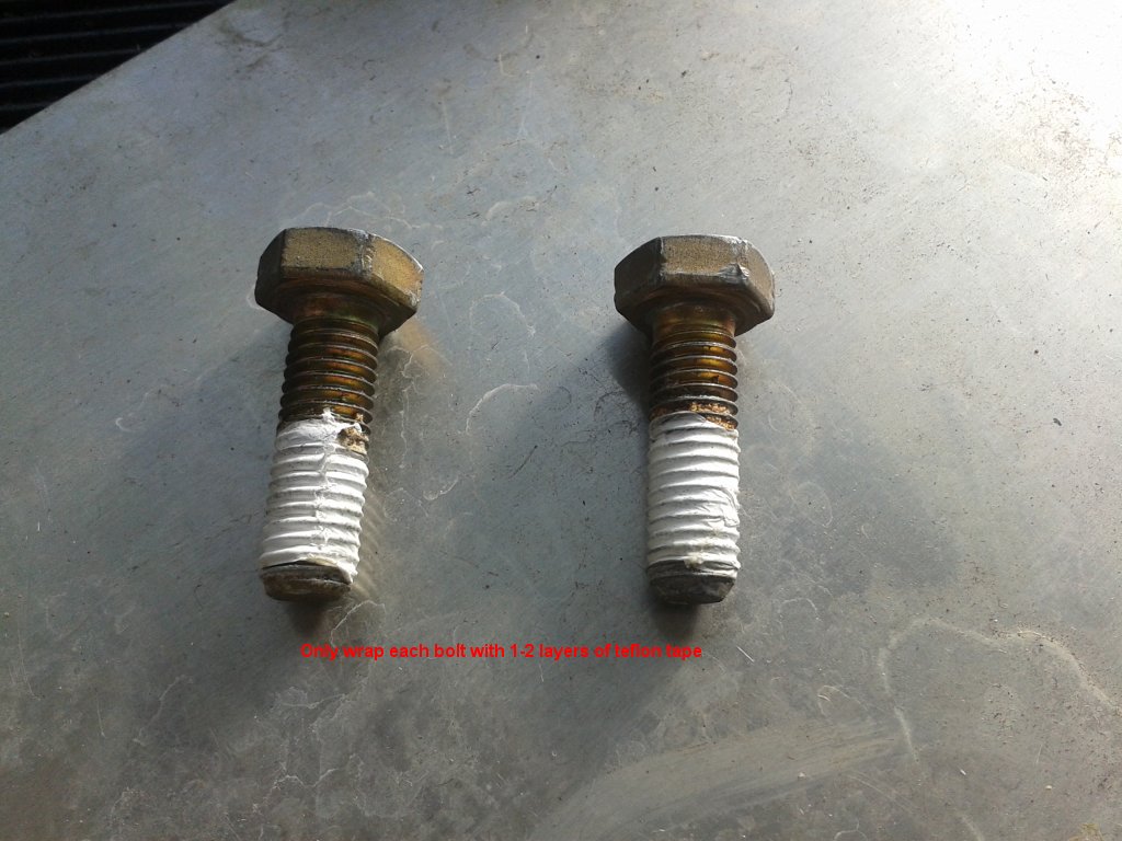

The guide bushing bracket bolts interestingly were wrapped with teflon tape. I'm not used to that; I usually use Loctite. However, I wrapped the bolts with two layers each. Any more, and the bolts may not go in properly.
