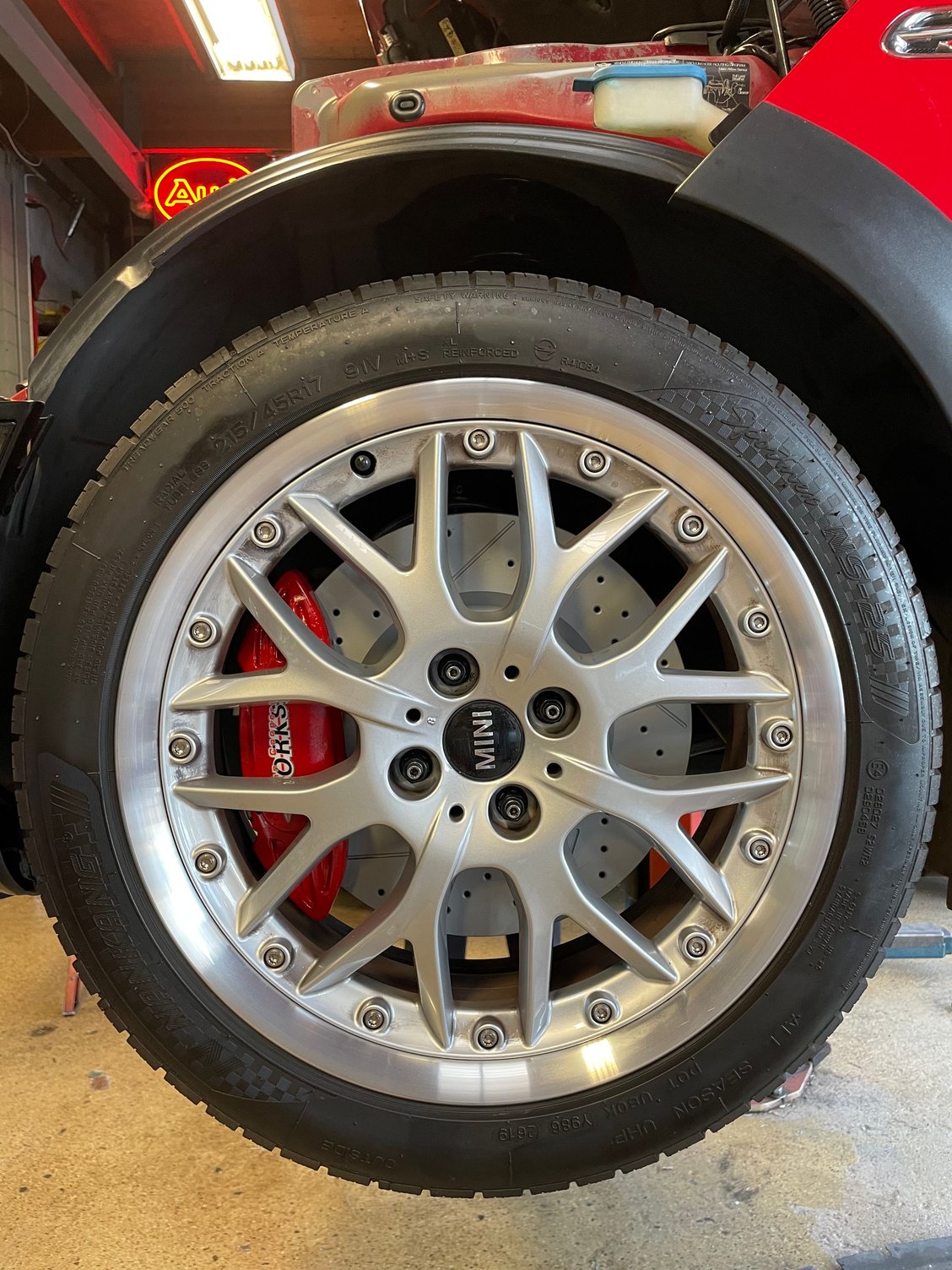

In the spring I upgraded my front brakes to the R56 but when I went to install my 15” winter wheels they don’t fit over the calipers. So although I tossed the R53 calipers I had to purchase new ones and installed them over the R56 rotors. The brakes feel slightly different and want to make sure it’s ok to use.

Here are r56 JCW calipers on factory bbs R90 17x7 with 15mm spacers
I have the same wheels that I’m removing for winter this the smaller wheels.
Those 15mm spacers look great on your Mini but, are you running coilovers which require the need for the spacers?
