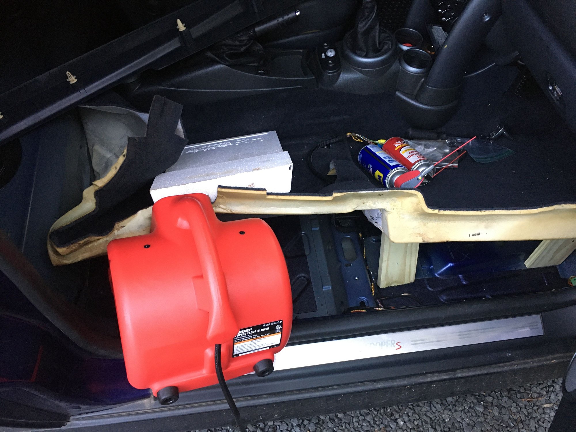

Removed the seat.
Removed the panel on the side of the door sill. That’s held in by one large torx bolt in the back holding the seat belt down. After that it pulls straight out towards the middle of interior, has clips.
Propped the carpet up with some small wood pieces I had around.
Put fan on it.

Got everything dried out and back together. No more issue with the third brake light on for now.
I'm going to check the other brake lights and see if they are good.
