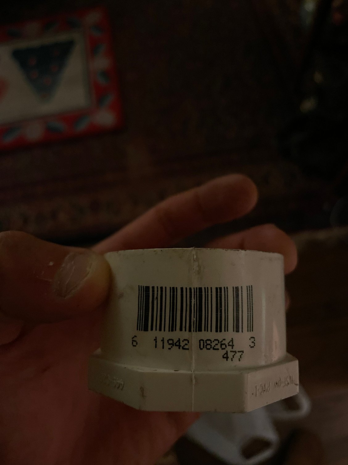

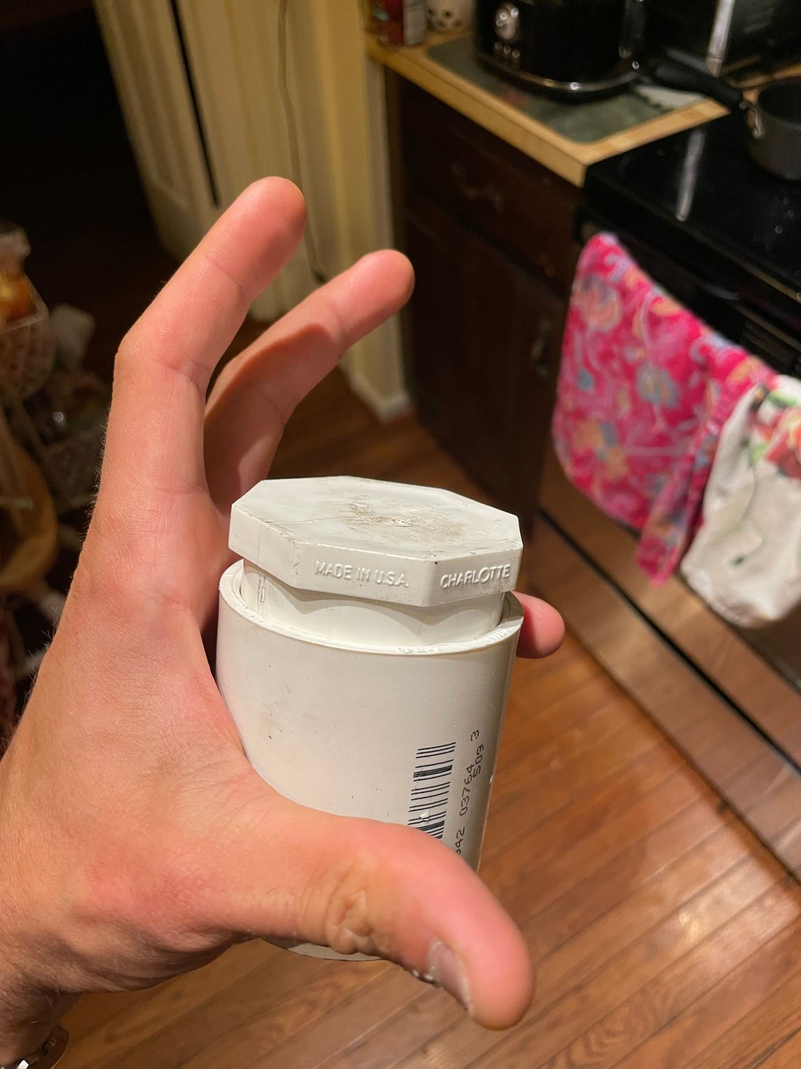

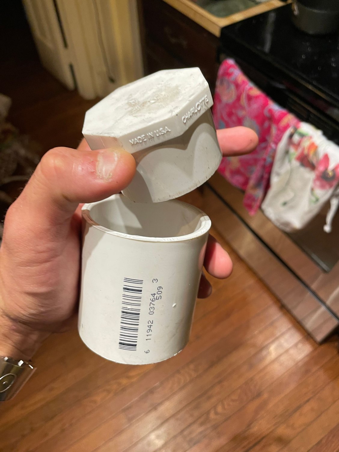

R50/53 Here are two pvc pieces I used for installing driver side axle seal
Old Jul 27, 2021 | 07:28 PM
pollito's Avatar
pollito
Joined: Mar 2019
Posts: 83
Hi all,
I just installed a new driver side axle seal and I used the two parts in the photos below that worked well. However, a longer pipe would be better for clearance of the front sub frame. I ended up putting a stubby 2x4 on top of everything to hammer. The diameter of the smaller pvc piece that has that hex shaped head fits over the passenger side seal much like the 2” pvc pipe fits over the driver side seal. Just to be clear, both for the driver side and just the hex shaped one for the passenger.
