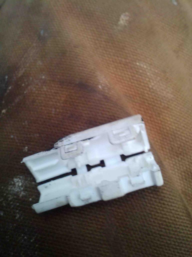

My 2002 Cooper S had a problem with the brake lights permanently being on.
After some searching I found that the probable cause was a bad diode.
Here's what I did:
Remove plastic cover running along sill and underneath passenger footwell.
You should be able to just pop it of, there are no screws just friction fit trim fasteners. You should see the BCM unit and a couple of wiring looms.
Below the BCM is a wiring loom with a small white plastic box that contains a diode. You may have to unravel some black cloth tape to expose the white plastic box.
Peel back the rubber boots on either end of plastic box to expose two connectors. Unplug these and you will be able to remove the diode and the two spade connectors.
Once you open the white box you will find a diode that has a female and male spade soldered to it. Examine the diode carefully and you should see one end has a silver band, note which connector this silver band is connected to. In my case it was the female spade with the silver band end soldered.
I elected to change the diode for the closest match I could find immediately , you may want to order the exact same diode Silicone Rectifier 1N5626
Using a soldering iron I removed the damaged diode and soldered in my new diode. In order to correctly size the diode and connectors note the overall size of the existing diode.Name:  diodeattached_zpsdfbcf3b8.jpg

Place diode in box and pack with Dielectric grease to protect it from water.
The only tool needed for this job is a soldering iron.
Will report back if there are any issues with non-exact diode.
