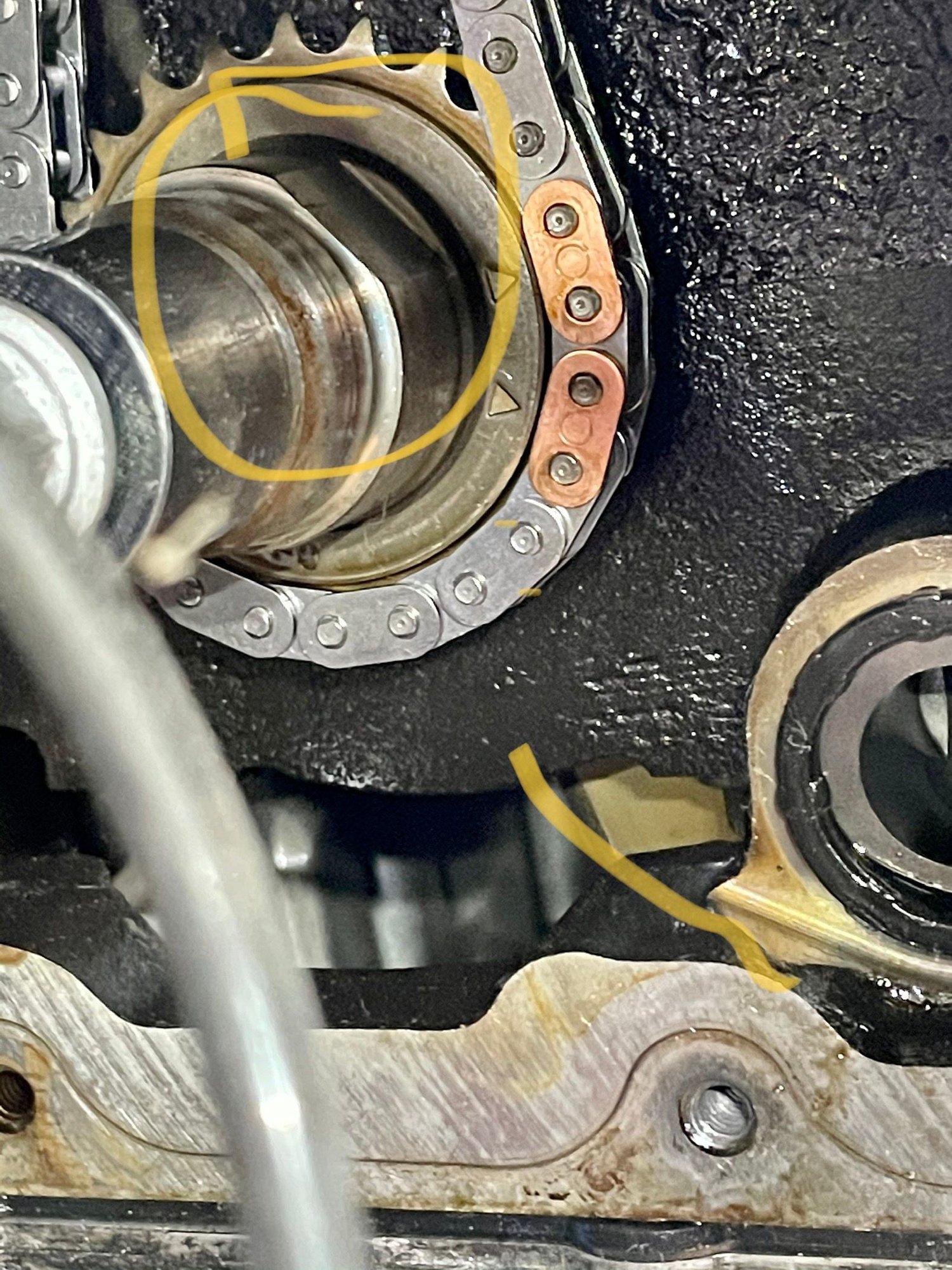

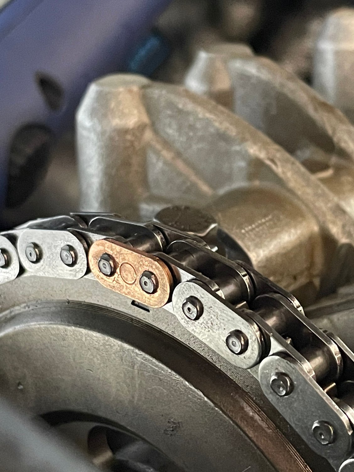

my own mistake has cost me dearly!! I installed a high performance cam with a new chain ect. and after installing the chain tensioner I assumed oil pressure would release it like on the 2nd gens but nope I was wrong. Started the engine and the slack of the chain caused it to come off and lodge down with the crank sprocket spinning and shearing the pin. Ok first off you know what they say about assumptions and I hardly ever assume but anyway the book calls for you to stick a pry bar down and put tension then release and that releases the tensioner. Then not realizing the sprocket has spun I’ve timed three times along with compression test and all four were low so I bought a reman head ( didn’t need) put back together and still no start. I scoured the internet and found a guy that his pin was sheared as well so I pulled the gear off and mystery solved. Since I can’t remove the pin I welded the sprocket to the crank because if I did I’d have to pull the engine. So there’s my horrible story.
the first picture is after the sprocket spun and the second is correct. Look at the flats that run the oil pump in correlation to the copper links and arrows.

So the correct location of the oil pump flat is 11:30 or so?
don’t go by that
