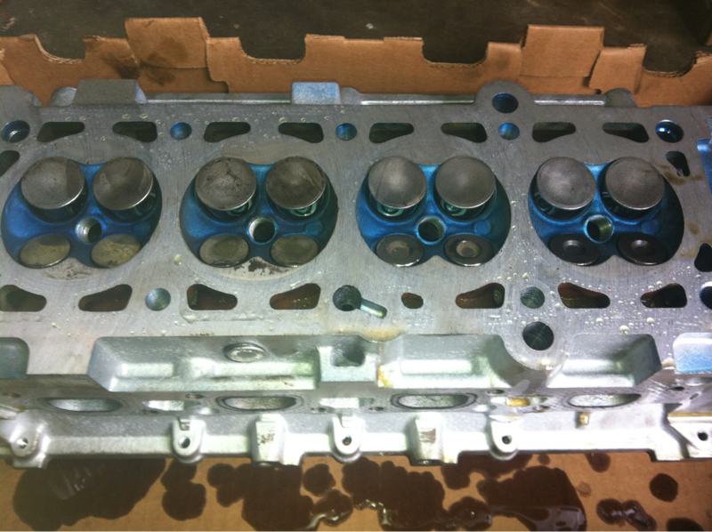

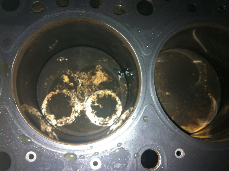

I got the head out. It's scary when you realize you have most of the socket sizes memorized... Been working on this car for far too long.
Today is a sad day. It turns out that the R50 engine most certainly is an interference engine. Mine did some pretty good interferein'...
Just dropped it off at the machine shop for valve job #2. It's hard to start a car when all your intake valves break and are stuck open. Aside from a couple tiny marks, the pistons appear to be ok. Gonna check them out more closely when I go to the garage tomorrow.
Here are some pics of the damage. *facepalm*

Oh ouch...
New head bolts too... (Again..)
