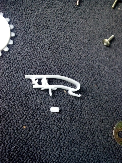

where can i buy the white clips that hold the regulator cables up top? Mine broke

You can remove (and retighten) the white gear holding the window with a flat screwdriver tapped with a hammer. The white cable holders are NLA individually but can be found in some (but not all) regulator kits (partsgeek.com).

I did find this kit that also includes hardware for the regulator.
https://www.ecstuning.com/b-genuine-...r/51337031087/
