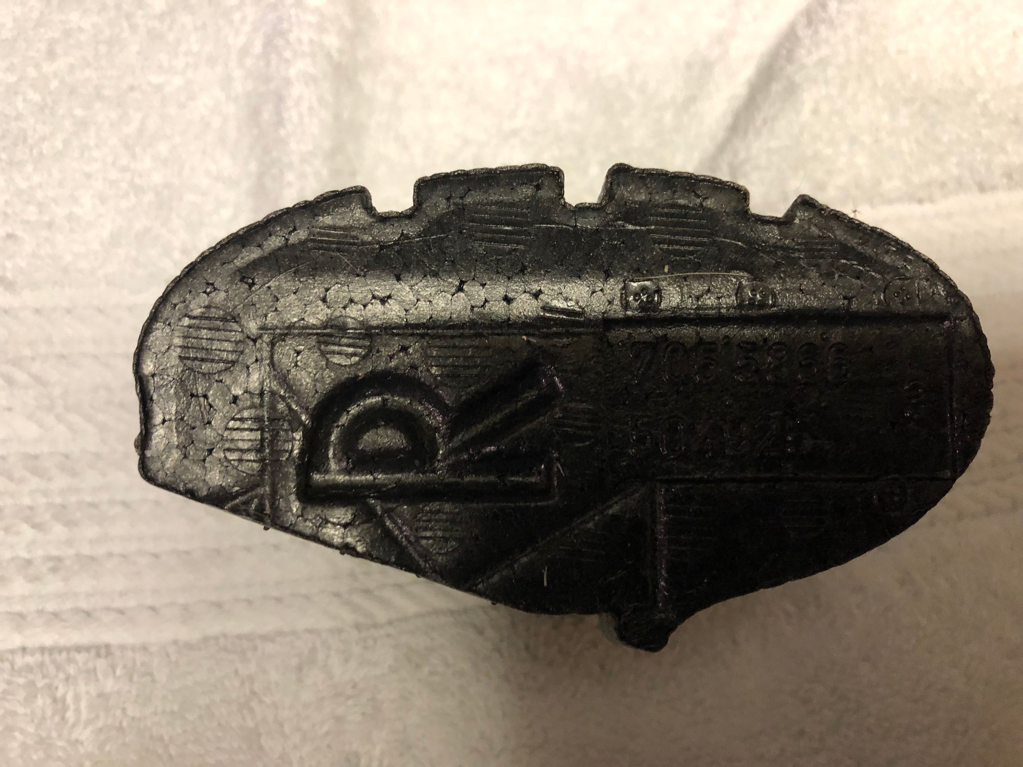

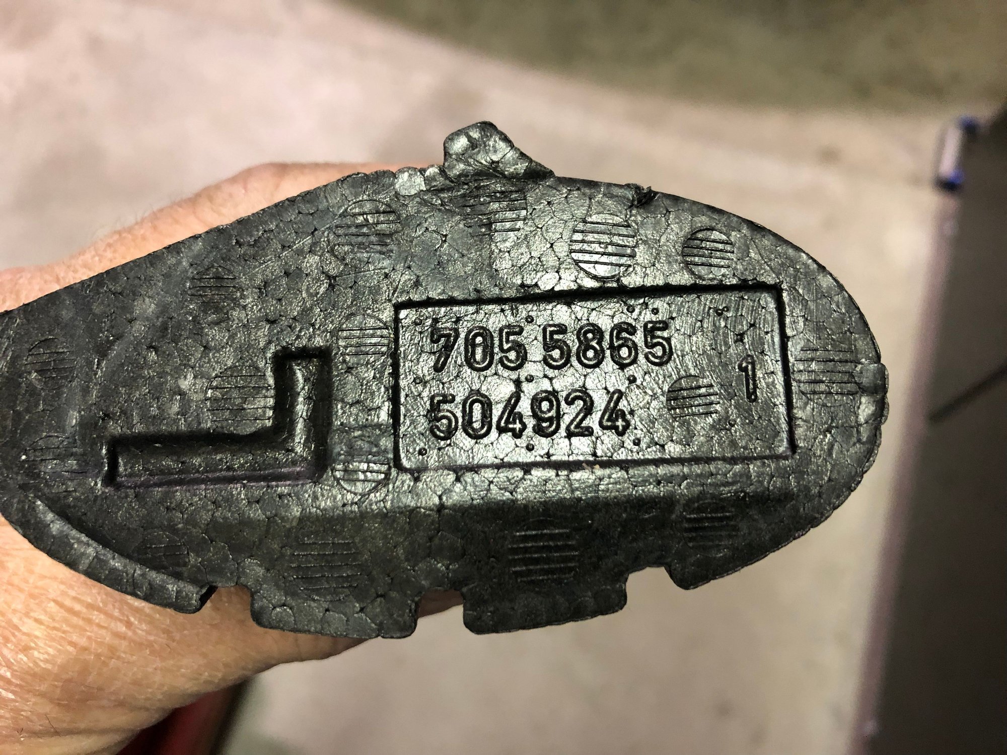

Down Tube Rattle
Genuine MINI Cooper R50 R52 R53 Down Tube Inserts (L & R)
7055865 / 7055866
Inserts for Down Tubes - right & left

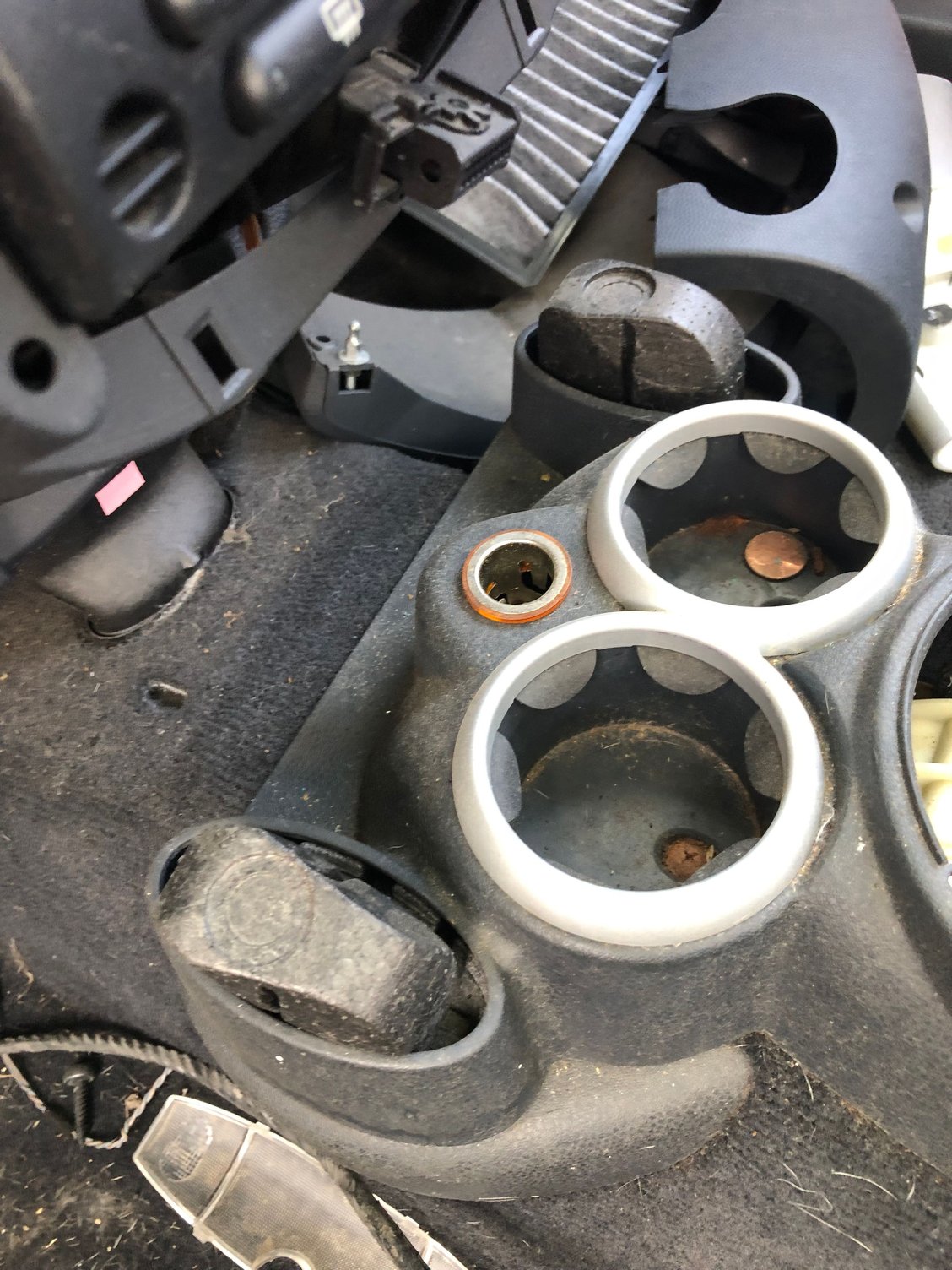

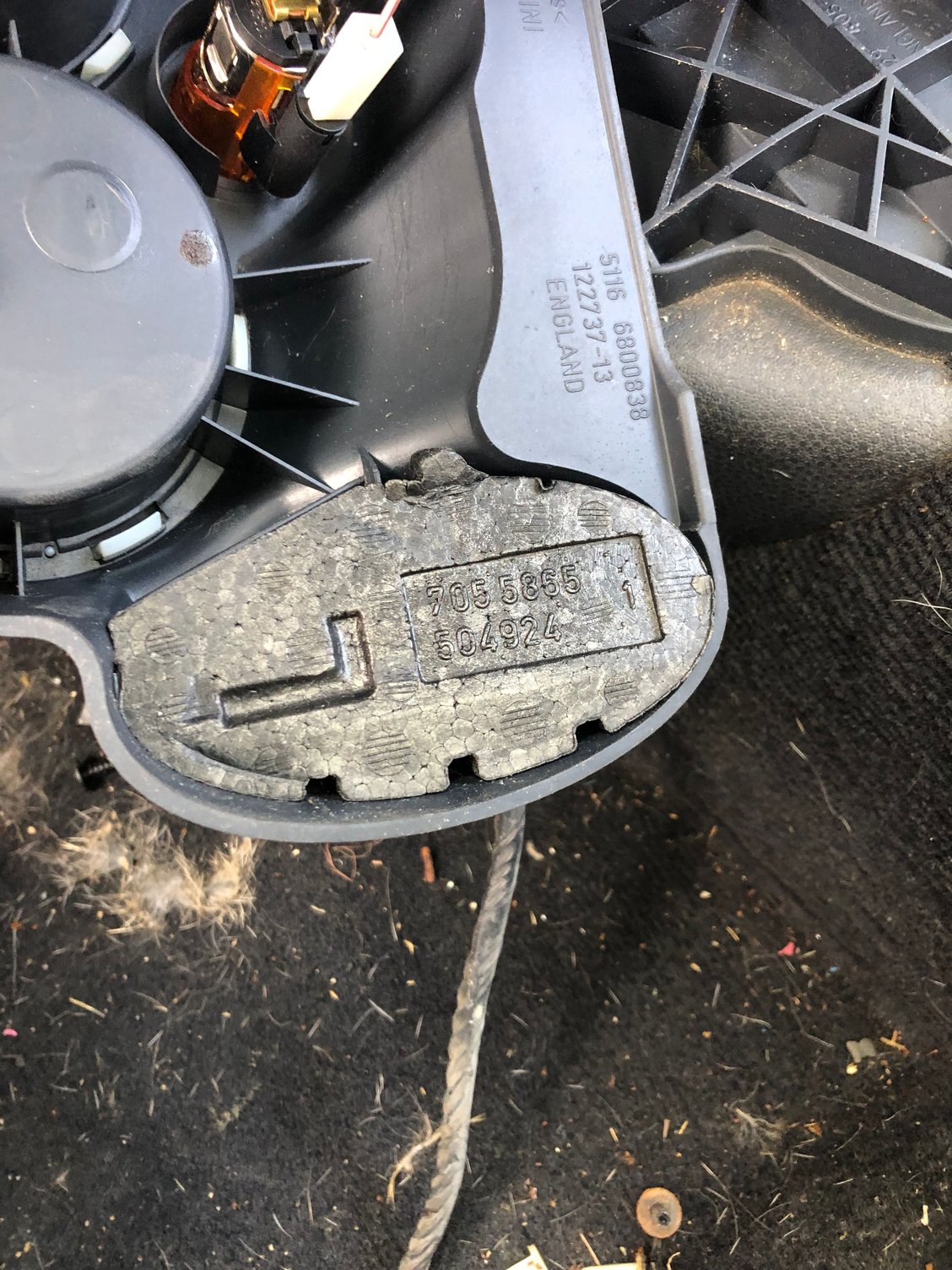

Located at the base of the DownTube.
Addresses Down Tube rattle. Cushions and firms up bottom mount. In my experience found on pre facelift MINIs but fits all 2002-2008 R50, R52, R53s.
