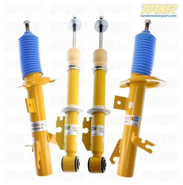

2 sets were JCW and last set = Bilstein Sport Struts = https://www.turnermotorsport.com/p-3...er-s-set-of-4/
Very happy with the swap, every bit as good as the JCW's and are designed for car running lowering springs so work with the JCW springs very nicely !
Bilstein Sport Shock Set for 2002-2006 MINI Cooper/Cooper S; Set = 2 front + 2 rear. Bilstein Sport Shocks offer a firmer ride quality than standard Heavy Duty (HD) shocks, these are designed for lowered vehicles and sport applications. For the performance minded driver, Sport shocks deliver absolute mastery of the road surface
