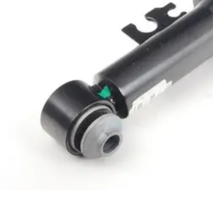

It appears I spoke to soon, when I declared the R53 JCW struts and shocks are still available. It seems the front struts can still be bought, but not the rear shocks (for a non-GP R53). The part number I have for JCW rear shocks on a non-GP like mine is: 33526768412. The JCW rear shock which is still available is for a GP: 33506776199.
What is the difference between the 2 different rear shocks? Is it just the lower bushing? The GP version appears to have a conical one, compared to non-GP.
Old Mar 16, 2021 | 08:30 PM
  #45
deepgrey's Avatar
deepgrey
Joined: Jun 2009
Posts: 1,314
Likes: 484
From: Atlanta, GA
That looks like the lower bushing on the second gen shocks.
Old Mar 16, 2021 | 08:33 PM
  #46
Ferrino's Avatar
Ferrino
Joined: Oct 2017
Posts: 44
Can that bushing be modified to suit 1st gen trailing arms? i.e. cut.
Old Mar 16, 2021 | 08:43 PM
  #47
deepgrey's Avatar
deepgrey
Joined: Jun 2009
Posts: 1,314
Likes: 484
From: Atlanta, GA
I don't know much about the GP, but I suppose it's probably possible. People run a machined adapter for that lower bushing to go the other direction when they install R56 aluminum trailing arms on the R53. I didn't realize that the R53 GP used that style trailing arm.
Old Mar 17, 2021 | 03:54 AM
  #48
njaremka's Avatar
njaremka
Alliance Member
Community Builder
Community Influencer
Joined: Jul 2016
Posts: 7,534
Likes: 2,503
From: WNY
The GP had aluminum trailing arms, the precursor to the R56 trailing arms. I suppose you “could” cut that off to use with R53 steel arms, but I’d worry about getting it flat enough for a good seat on the arm. I would seriously just get the Bilstein B8 sport shocks and be done.
Old Mar 17, 2021 | 04:44 AM
  #49
NoBars's Avatar
NoBars
Joined: Dec 2020
Posts: 33
If they press out it’s literally a 5 minute job to turn those ends off on a lathe.
I have seen posts where people installed these (the R56 style shocks) on older R53s just installing it backwards. That is, by having the conical part on bolt head side instead of having it on the trailing arm side. You may need to buy a longer bolt to do that, though.
But, given the experience I had when I switched from my MINI shocks to the Bilstein B8s, I would say - Go with the B8s all the way around... Or the B6... Bilstein makes a much better shock.
