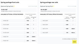

Was just looking at ST's website and noticed that they offer custom spring rates too:
Standard is 80N/mm front and 40N/mm rear,
which equates to 8k and 4k, is that correct?
