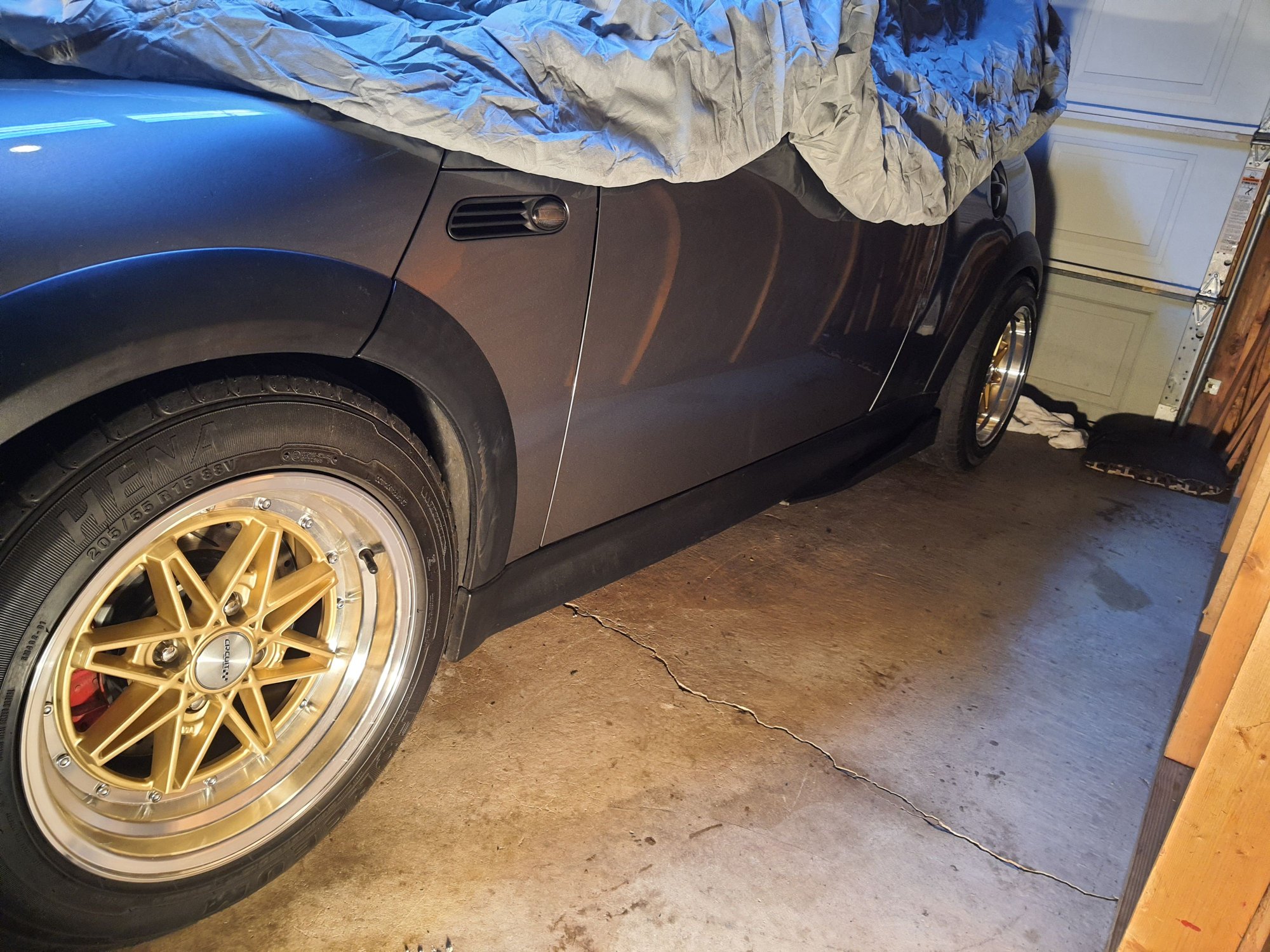

I gotta adjust something . When full crank on turn it kinda made almost a binding kinda noise but it hasn't been aligned yet and I still have to put on the upper rear adjustable control arms and the front camber plates.. buuut it did feel pretty nice besides that binding issue BUT I didn't go over 30mph and only took it around the block 2x...
heres how its sitting now that I again adjusted it for preload. Ille 2x check my endlinks again though. I got it sitting EXACTLY where I've wanted it to since the day I brought Troll home.
