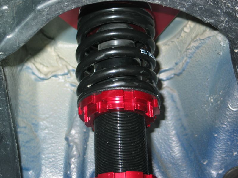

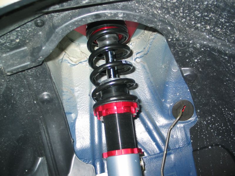

Urgent help needed for Megan Coilovers… A few days back, I installed a set of Megan Coilovers on my ’06 MCSC following the directions and posts by Meb and others (thanks for all those posts, very helpful). 2 days ago I was driving around and noticed that something wasn’t quite right. My Mini, and I were really getting hammered on sharp bumps. The next morning I performed a simple test. I pushed down on the back end and there was some travel. I did the same on the front end and, wow, no travel other than the tire give. Here is my test and findings:
I removed the front strut and disassemble it to remove the dust boot thus exposing the shock shaft. I then put everything back together (ofcourse except the dust boot) and fully compressed the suspension to see how much travel I really had on the front end. And, Holy Coilovers, Batman!!! There was absolutely no suspension travel. The shock was fully compressed to the stopper. I double checked to make sure the shock was not leaking and no evidence of that found. Furthermore, I then adjusted (raised) the lower spring perch to the highest possible thread settings giving the spring more room to compress before the shock was fully compressed. It actually gave me about ½” clearance on the shock shaft. Still no where close to full travel.
I was on the phone with Steve at Megan Racing and send him all the info including pics of the fully compressed strut (suspension), uncompressed, and adjusted perch fully compressed suspension. Unfortunately he was unable to return my phone call before the end of day yesterday.
I have read other posting on NAM about a harsh ride on the Megan’s and I can only assume that it might be due the lack of travel on the front struts.
Has anybody done any similar testing or has had similar experiences? I’m in desperate need of help.
I believe the solutions to be fairly simple, Megan Racing needs to: 1) Provide a higher spring rate for the Mini, thus not allowing the shock so fully compress, or 2) Develop a new taller spring that, again, will not allow for the shock to fully compress.
Now, keep in mind that I do own a ’06 MCSC and there is about a 175lbs weight difference when compared to the MCS. But even Steve at Megan pointed out, that the weight is mostly at the back of the car. But still, it shouldn’t make such a big difference in suspension travel.
[FONT='Times New Roman']I will try and add the pics in here…..Thanks for all your help!!!!![/FONT]
Here are the pics: First is of the fully loaded, second is of no load, third is of fully loaded with full adjustment to lower perch to topmost threads.
Attached Thumbnails Urgent help needed!!!...Megan Coilovers-fully1.jpg   Urgent help needed!!!...Megan Coilovers-noload1.jpg   Urgent help needed!!!...Megan Coilovers-perchtopmost3.jpg

your car being a convert should have nothing to do with this.
i would double check and make sure you installed everything properly. i am running these coils on my sunroof'd S and have good suspension travel in the front and rear. nothing like you described.
are you positive you set the upper perches correctly? what it sounds like to me is that you are using the upper perches to adjust rideheight, which would be completely wrong. rasiging and lowering the upper perches to adjust ride height would SUBSTANTIALLY reduce your suspension travel. practically causing it to "ride on the bump stops". you need to set the upper lockin perches with the strut off the car. you want them to just **slightly** compress the spring. the spring should still be able to turn semi-freely. then you adjust the lower mount ( closest to the control arms) by loosening the lowest bottom lock nut (single lock) and then spinnin the ENTIRE shock assembly inside the lower piece.
if that helps, it help. i basically confused myself. but i would bet 10 dollars that says you are using the upper locks to adjust the height. this isnt like a normal coilover, notice no helper springs, yadda.

I followed Meb's instructions to the 'T'. I'm not using the lower perches to adjust ride height. I was extremely careful not to do this. The additional adjustment I made to the lower perches was to allow the spring to compress further since there was no more room to compress due to it riding on the stoppers. I know exactly what you're talking about with the adjustments and I took a good day to examine the coilovers and undestand their design before mounting them on the car. And as Meb described, I just hand tighten the lower perches to the point of putting resitance on the springs before mounting them.

hrm. dunno on that one then. i think the stamping on your springs matches up with the correct ones, i believe. correct me if i am wrong but the num (xxx.xxx.xxx), the middle number should be the spring length in mm. i would confirm that but you could measure the spring to make sure you have the right springs.?
when i go over big bumps the car bounces up and down, so i am fairly sure it is working. the ride is also a bit bouncy where the dempening is set now. i am fairy certain that i have travel unlike yours. could it be the bump stops being the wrong size?
how are you compressing the shock with the wheels off for that compression picture? with a jack?
what is your dampening level set to in the front?

Thank you defy, I appreciate all the input I can get. I have tried all the settings from full soft to full hard with no difference. That's what brought me to perform the test.
Yes, I was using a jack to do the compression. And you're right, I also thought about the stops being to long and that migh give a bit more travel but you also run the risk of bottoming out the shock and could blow it out.
Have you looked at your travel w/o the dust boot? On a large bump the car will bounce up and down but you will have no downward dampening or compression effect since the car is riding on the stoppers.

I agree with Meb about redesigning the system on the long term. However, I'm also looking at a short term solution here as well. I don't want to be running with my front suspension fully compressed. This will cause more problems in the long run, i.e. mushrooming. By adjusting the lower perch as high as possible, it allowed me to see if the spring would fully compress before damper travel was gone and what would happen to damper travel. As evidence by the pictures, The spring didn't fully compress and there was a bit of damper travel. So findings, in the original set up with the lower perch at suggested heigth the damper becomes fully compress before the spring holds the weight of the car, therefore, complete loss of dampening capabilities. Conclusions, adjusting the lower perch upwards and adding a taller spring will provide that additional damper travel. I think that a higher rate spring will also help in the situation as it will won't compress as much, however this will also change ride characteristics.
Old Aug 24, 2006 | 11:46 AM
Megan Racing's Avatar
Megan Racing
Vendor
Joined: Jan 2006
Posts: 304
From: La Puente, CA
If we increase the length of the spring it won't really accomplish much due to the fact that the shock length remains the same. We are plagued with only 2.25" of suspension travel with the current setup.
We've decided to increase the piston length by 30mm and use a 180mm spring to compensate. However, I was thinking about going up to a 6kg spring. What do you guys think? Let me know so I can get this rolling ASAP. If someone can get the Good Dr. in here to key in on his opinion, tha'd be good.
