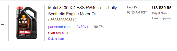

I get my oil from ebay.
I love ebay but learned a lesson to be much more careful,
like never ever buy bargain NGK on there!
https://www.northamericanmotoring.co...ml#post4546792
