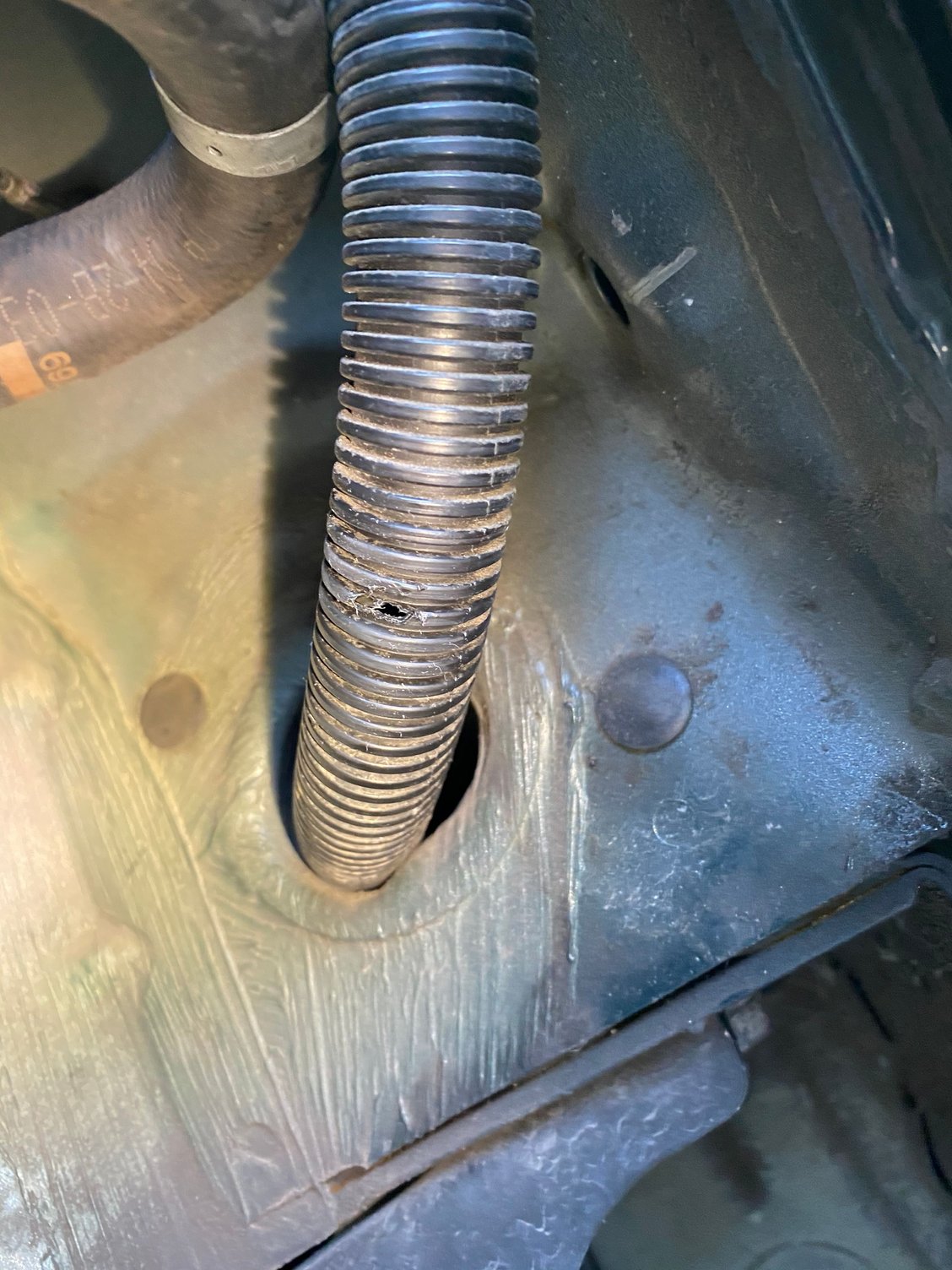

Well, for the sake of anyone reading this in the future, I found at least a major contributor to the issue if not the entire problem.
The issue is/was that one of the vent lines connected to the charcoal canister had apparent been chewed through by a rodent. The hole is only about the size of a few grains of rice.
I found this by building my own home made smoke machine.
I have patched the line with epoxy and flex tape to see if I can seal it back up instead of dropping the whole fuel tank to replace the line.
I’ll update when I have results as the patch work is still curing.

Picture of the hole.

Result was that the patch worked great. No more code. Passed emissions today.
