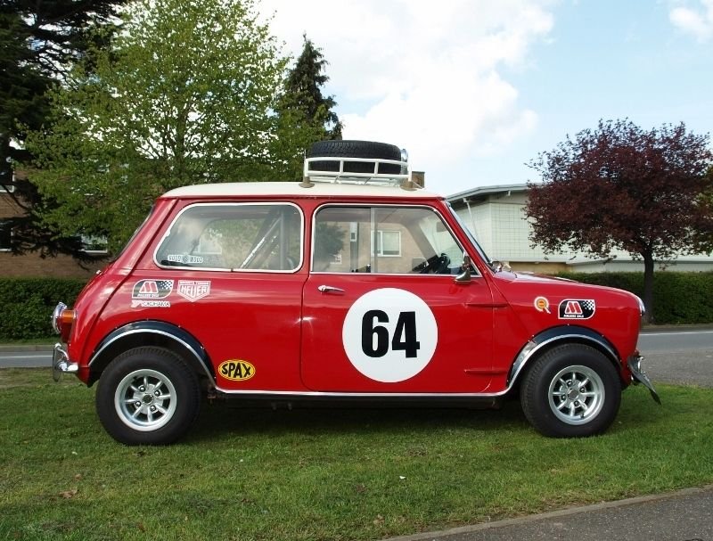

That sunroof delete still looks like a headache. That said, it is difficult to find a good 05/06 S or JCW that does not have a sunroof. Also, I may actually like them one day.
So.....this part is not pure performance, however it may be. With the Porsche 911's a car will be faster with with wider flares and wheels. I have always loved the classic Minis with the flares and the Minilites. I do not see that many wide minilites on the R53 and R56 cars. What kind of offset can be done? I see 15x9 et0 wheels. I would want a square setup.
