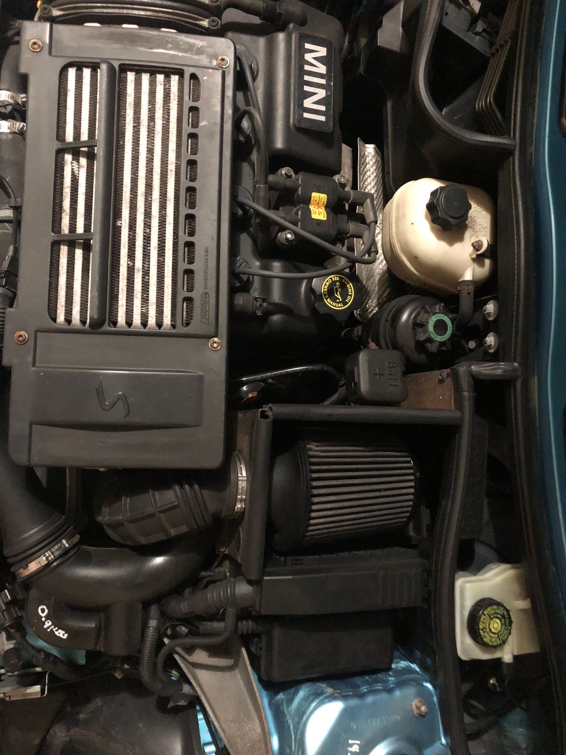

Thanks for the info. I attached a pic of the intake setup...how could I ensure cold air is being drawn in?
As as far as the green seals, I’ll have to do some research on those as I’m not too familiar with them. I have read in some posts about them but nothing further. Are these the seals connecting at the top of the intake horn, or is it on the bottom side?
I have a new pcv on the way and will be replacing that when it arrives.
On the JCW models the cowl just behind the end of your air filter is cut out. The air is drawn from the cowl, which is much cooler than the engine bay temps. You would then need to create a lid for the top of your air filter housing, You could glue a piece of plastic(maybe clear) to the rubber rim pieces. That way you can see the air filter and it may look cool too! It will also keep out the hot engine bay heat!
