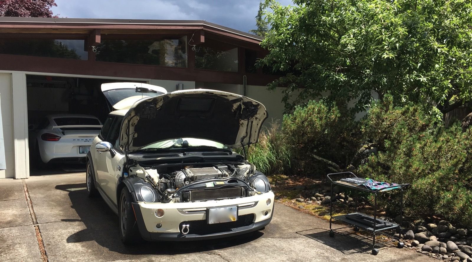

Originally Posted by jk6672
What's the point of that bar? Hard to tell from those crappy photos, but it looks useless if those are hinged at the tower.
The JCW bar is also hinged on both ends.
Yeah! But the bar is straight, and has no slotted bolt holes like on the M7. He had pointed out fasteners that rely on clamping force are no good as the interface surfaces will slip WRT each other.
Here is the M7 no-good curved bar that does not have the raised rackets.
