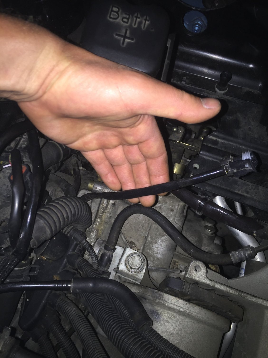

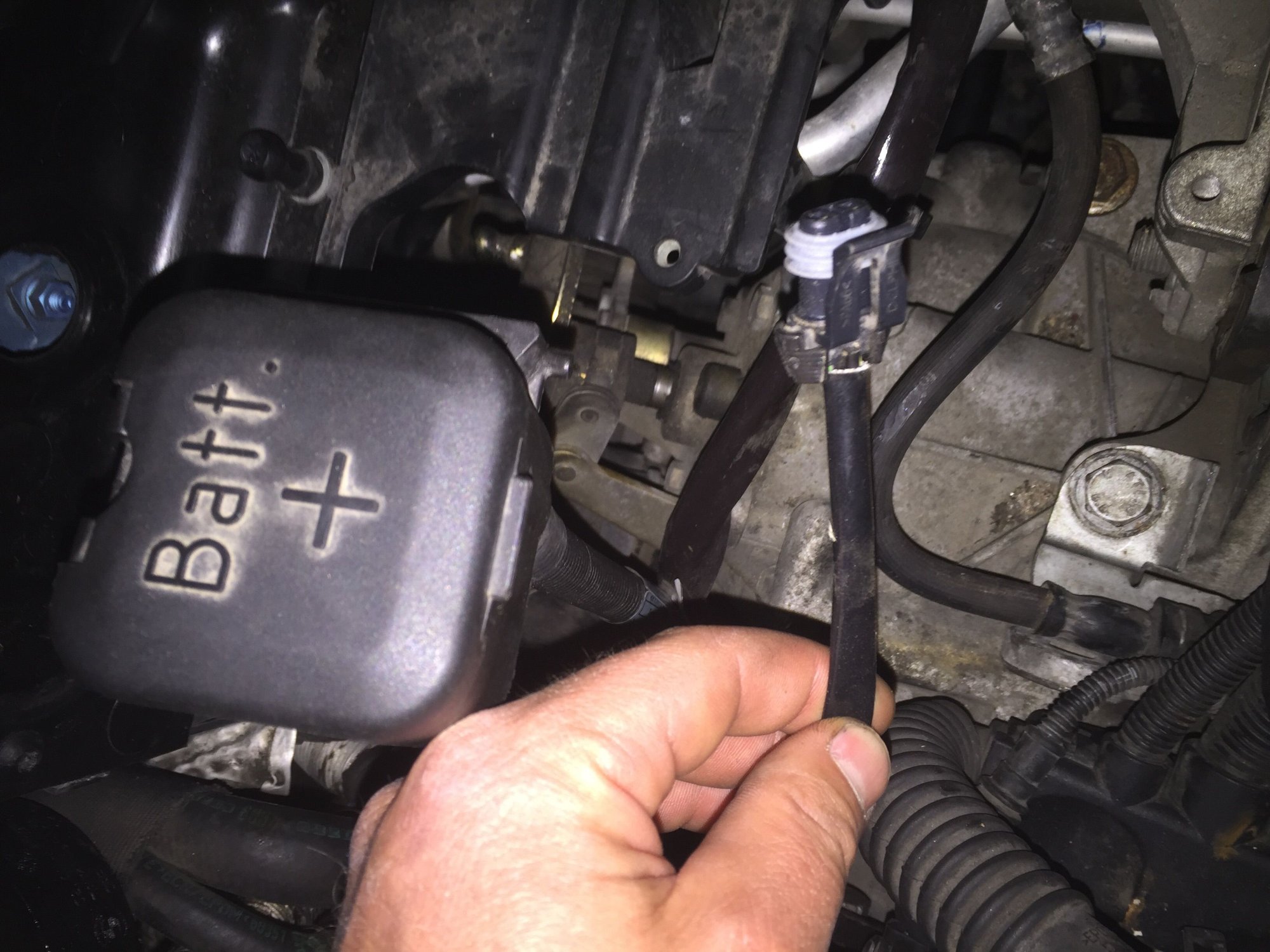

1. During removal of the intake hose connected to the supercharger, managed to break the red clip and brake booster hose at the connection. I purchased a replacement hose through detroit tuned and now can not figure out how to get the coupling apart in the middle of the brake booster hose. Here is a pic of the coupling.

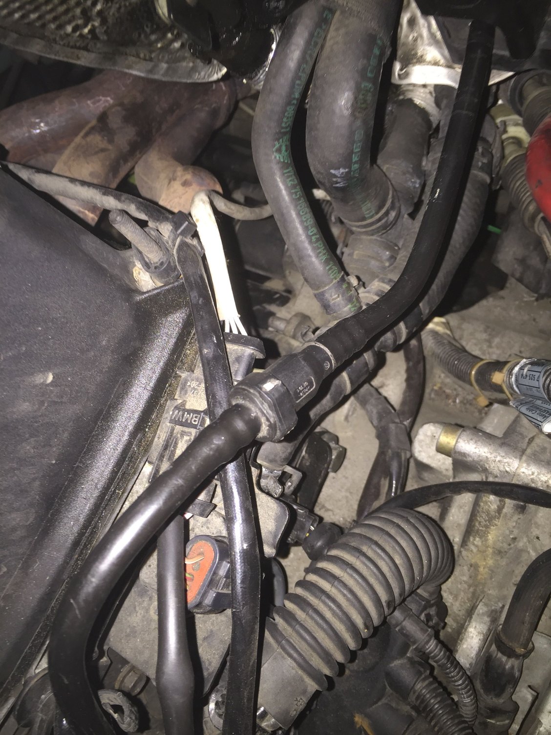

2. I also hae a connection that i am not sure where it goes. I think that it may be for the reverse light indicator but can not figure out if it is or not? Can i reach the reverse light plug with the subframe attached? Here is a pic of the connection in question.

I think that is your reverse light plug. You can see it on the back of the transmission thru the wheel well. Also double check your headlight leveling sensor if you have one. I always forget that.

Brake booster tube is removed by squeezing the square section of the connector with long-nose pliers and pulling the tube out.
Reverse switch connector... Fender well.
Steering is a sloppy fit with a pinch bolt... Should be easy, but I guess I'll find out this week.
Thanks for the pics... Figured out what my leftover bracket is for (oops). Finishing up my clutch, engine re-seal, cooling system and PS overhaul too.

...Anyway, to get the lines out you just carefully pry up on the red clip and pull, pry up again and pull, until its free.
If you're talking about the plastic hoses that go into the red clips in the intake duct, there is no prying necessary. Just push down on the clip (hold the red clip into the intake) and slide out the hose. I used my fingers to push down on the clip and needle nose pliers to slide out the hose.

Yeah got it backwards sorry, been almost a year now since I've had my Mini apart
Pull up on the line, push the clip down
