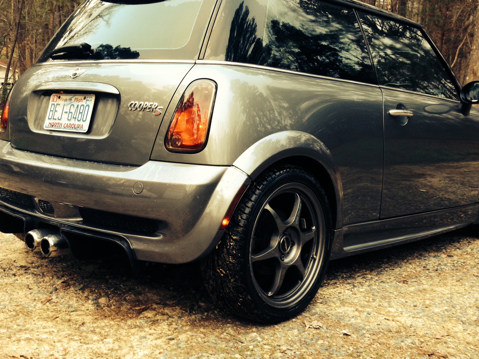

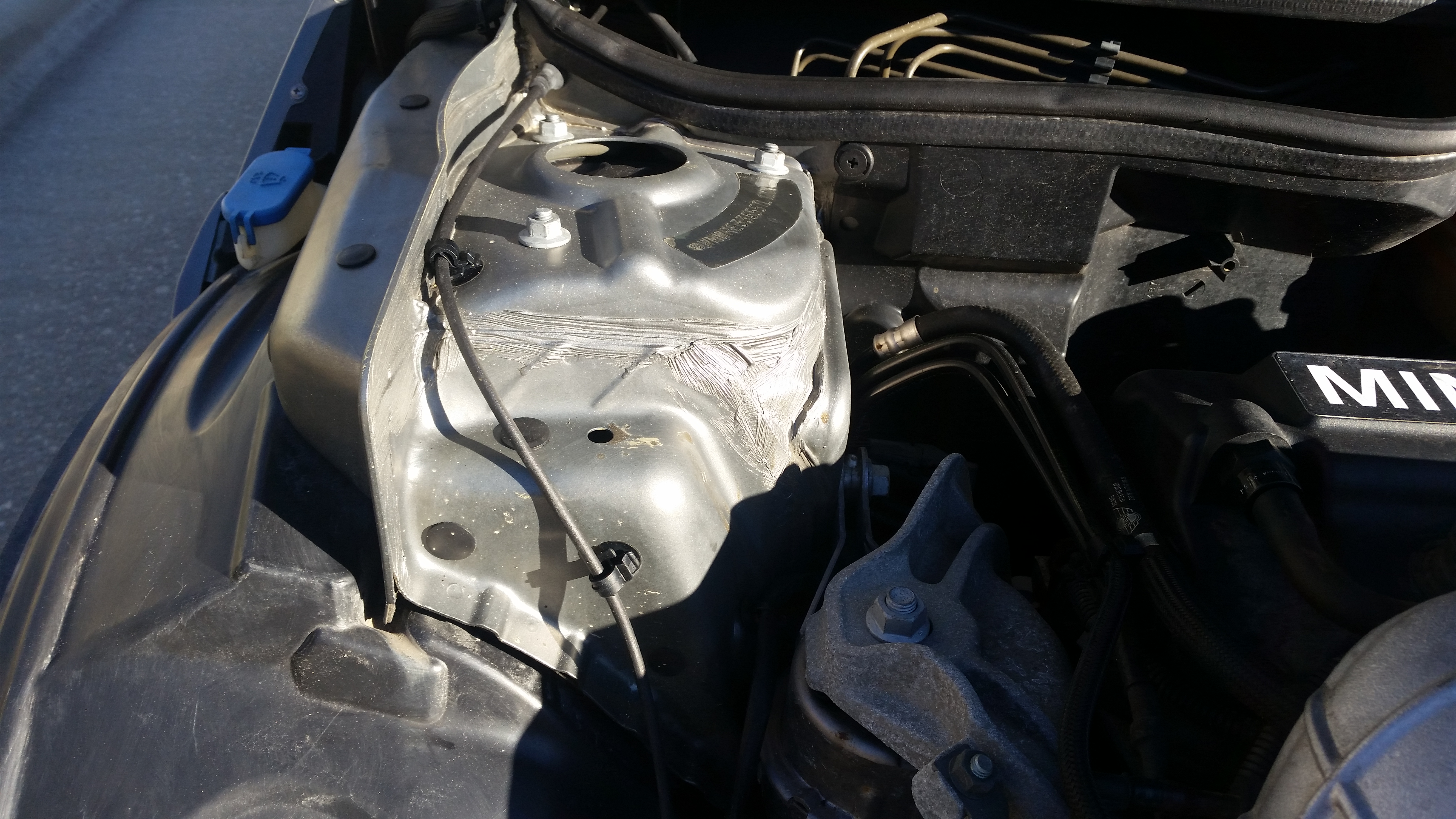

So I just returned from checking out the Mini, attached are a few pics of it. It ran almost like knew, great steering, good power and throttle response. No lights on except the tire pressure due to sensors not being installed in this set of wheels.
The guy seemed pretty straight forward about it, however he has only owned it for roughly 8 months. The history of maintenance beyond this period is relatively unknown. I did put a deposit down on it but will be taking it to a shop before completing the transaction, just would like to put it up on a lift and look around. I would guess bushings and other wear items would be easily inspected.

I don't think that year needed sensors or has them. I have an 05 R53 and the tire monitoring system is based on ride height (or something like that)...
I have a set of MOMO wheels and tires I use for three seasons that didn't require an actual sensor in the wheel. Pressing the button for a few seconds resets the system.

Is it just me or is something missing in the last picture? :O

Reads off the abs sensor, there is a reset button in the center console. The struts mounts to looks a hair mushroomed.
Get these after you can get it flat with the hammer technique :
https://www.northamericanmotoring.co...1-day-one.html
DIY on strut tower straightening https://www.northamericanmotoring.co...ection-19.html

Yea, I had the same thoughts on the strut tower. Not bad, but something going forward I will likely deal with.
