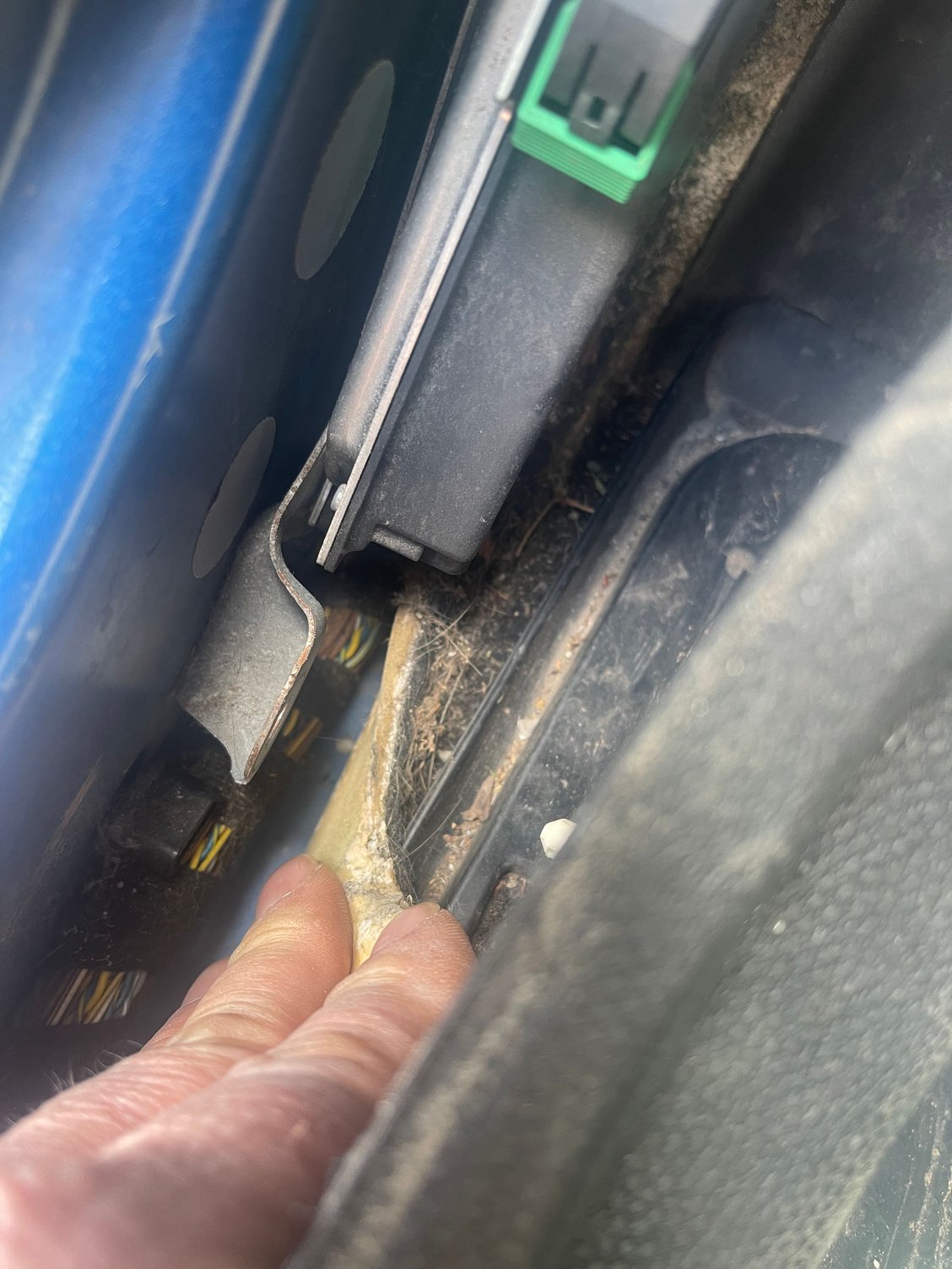

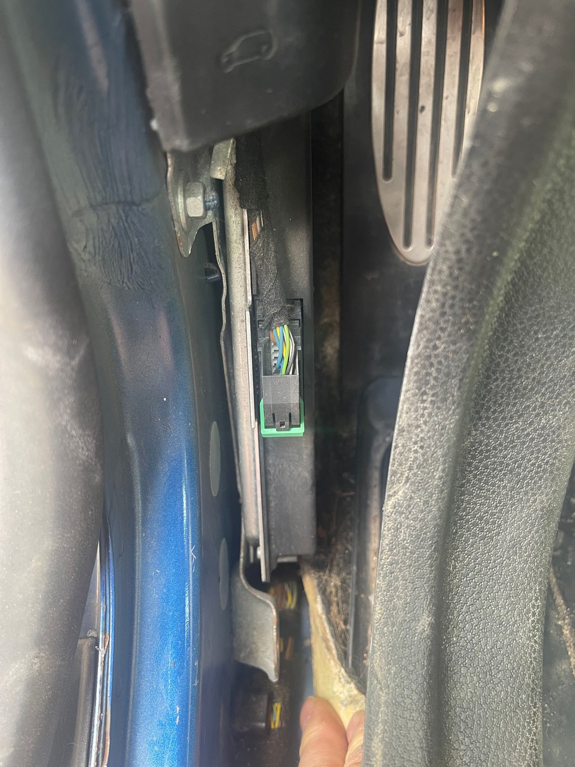

So I pulled the frm module this weekend and there are no signs of water damage at the pins or connectors. I opened the module up and there are no signs of water intrusion at all.
