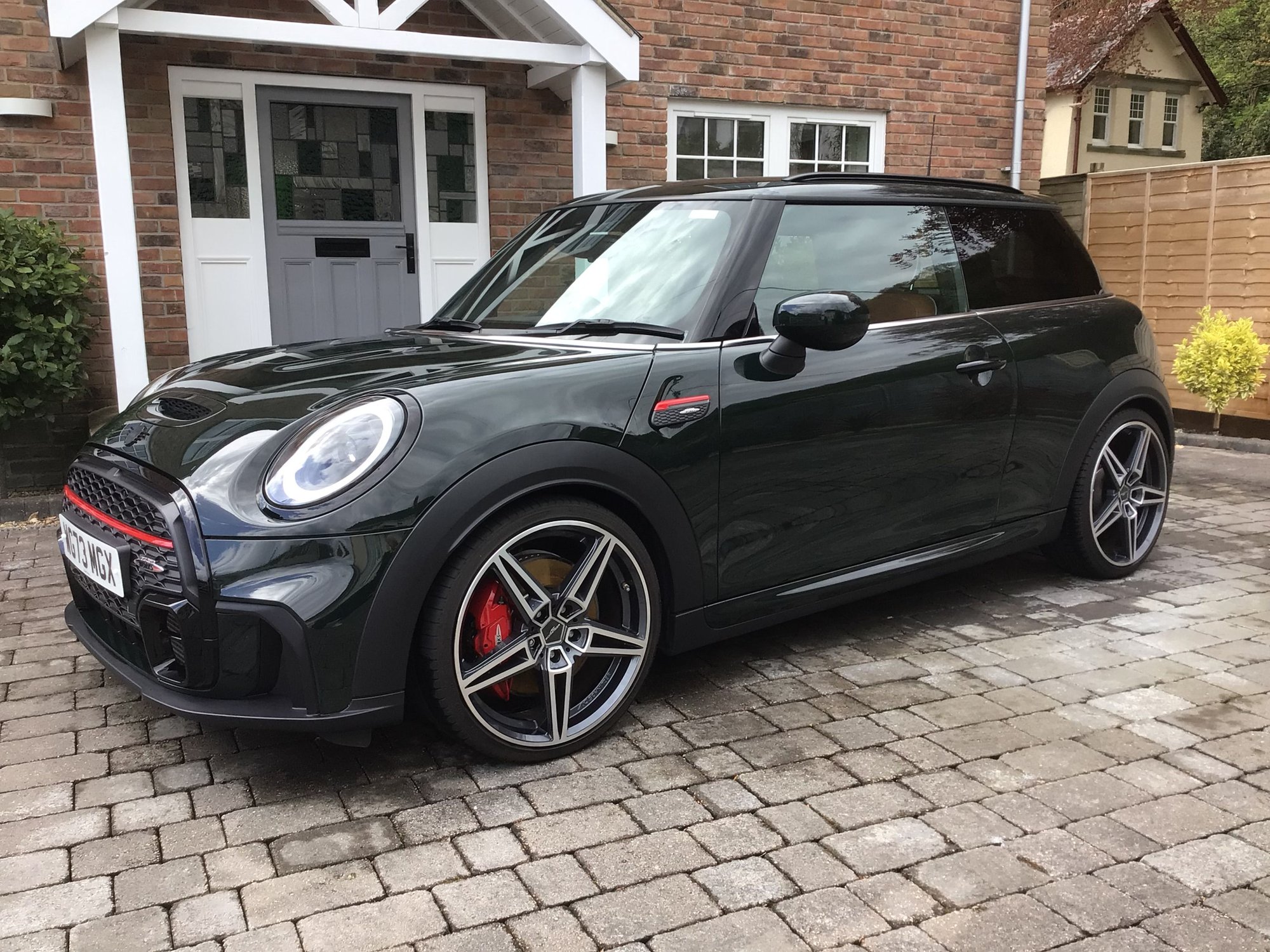

Thank you for coming back on this, I am referring to the Red bar which runs across the rear to stop luggage from moving forward.
The link you provided shows the exploded diagram of the Red Bar and the attachments, my problem is it is not clear how this attaches to the body as this is not going to be installed in a GP rather a 2023 JCW which has been prepared to accept the GP rear interior trim panels and the floor panel which you show.
I now think there must have been some sort of bracket welded or fixed to the GP which is not present on my car and that’s what I need to see in order to set the assembly in the correct position for the interior side trim panels which the bar passes through.
The plan is to colour code the bar to match either exterior or one of the interior trim colours, this is the car 4th Manual JCW F56 I have owned.
