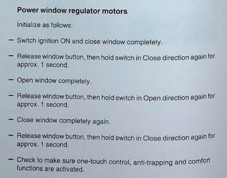

Not sure if it makes sense to try the power window initialization procedure:
Thanks. Might have to do this eventually, but right now the windows don't move at all.
