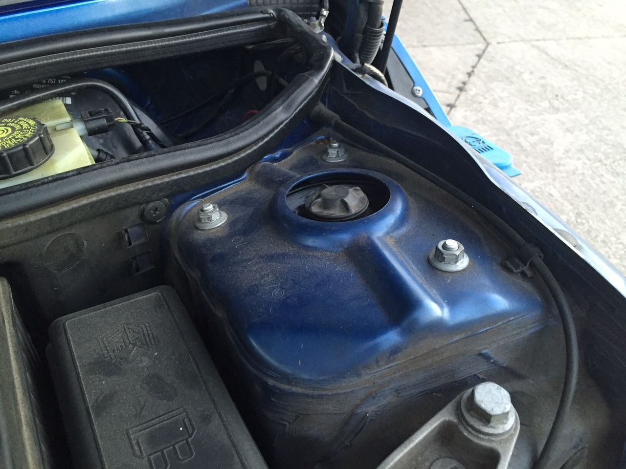

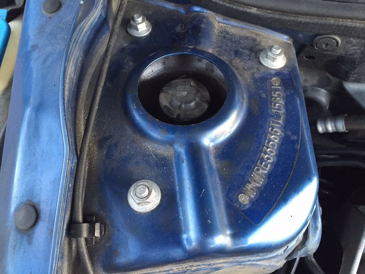

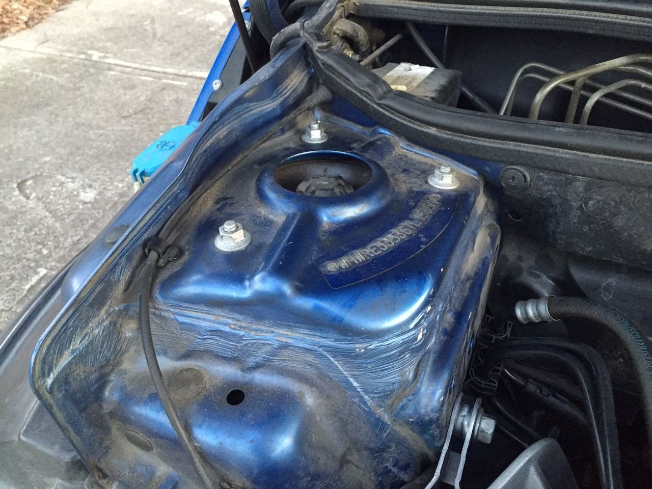

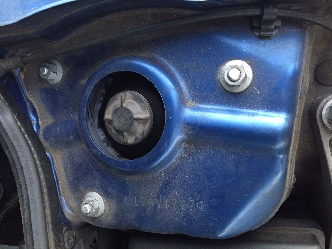

Do you think this car has mushrooming?
I am looking at a car and have only seen pics. I had the owner take some pics of the srut towers. I think it has minor mushrooming. Do you guys agree and think it may be fixed by torquing down some plates?

A little, but that's not too bad, but you need a new Left strut top bearing. Do both, and use MINI parts vs. aftermarket: they'll last longer. If you want to be sure, get some Strut Top Defenders and indurators while yo do the job.

Here are some pics and what to look for , I see some affect , but it does not looks that bad as others.

+1 your one strut mount rubber is cracked and needs replaced.

definently mushroomed, if you take a straight edge (ruler) across the strut, it should be fairly level. if its not, you have mushrooming. some has to be fixed by a 2x4 and hammer, while some can be fixed with chamber plates and strut tower plates

OP, that's very minor. And honestly, don't be overly concerned with it. My JCW had it when I purchased it and it's almost always correctable. And, most of these cars have it anyway, at least to some degree. Good luck!
