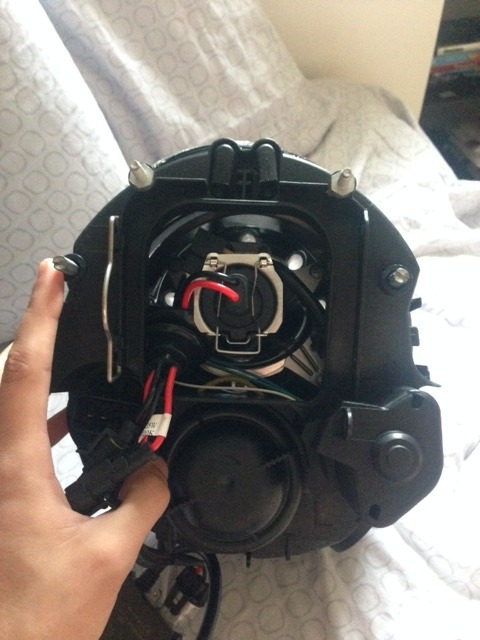

Headlights:

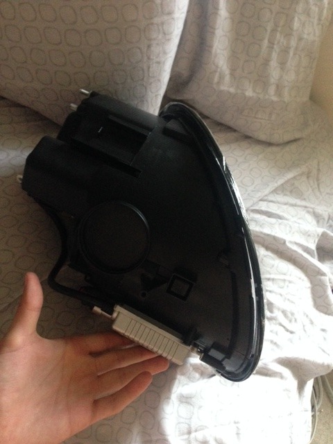

HID Bulb install:

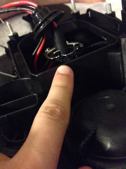

Lid won't close since wires have to connect to ballast which is outside of the housing for the bulb...

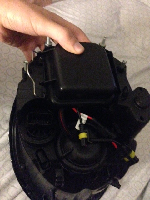

I am thinking of trimming here under the lid and make 2 "U" shaped cuts? so that the wires fall into this dip and can still be connected to the ballast.
Waiting to see how you and others have done this though before I go hacking away at plastic lol

So I got the lid closed with the wires coming through, no cutting needed... Where to mount the ballast
Is there enough room on top of the lid and when the hood closes to mount like so?
