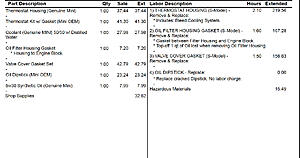

Alright guys, I am back (and with estimates already!). So I contacted RMW and set up an appointment for next Monday and was able to get my Mini up there yesterday in order to actually have them figure out what they need to do.

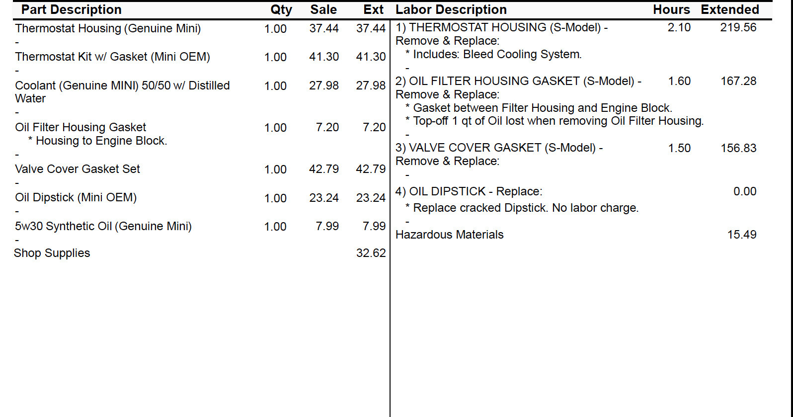

The coolant leak is apparently coming from the Thermostat Housting. The oil leak is coming from the valve cover and oil filter housing. They made me up quotes for that and the struts. I've included them below:
First quote is to fix my leaks. Shop labor is $100 something and some change so the math makes sense... but will it actually take that long to do the repairs? I can understand some of it will take a little while, but I'm wanting to make sure I'm not being overcharged here. Also, since this is an estimate, if they go over or under on the time quoted will my final cost be more/less? This is the first independent shop I've dealt with so I just wanted to make sure.

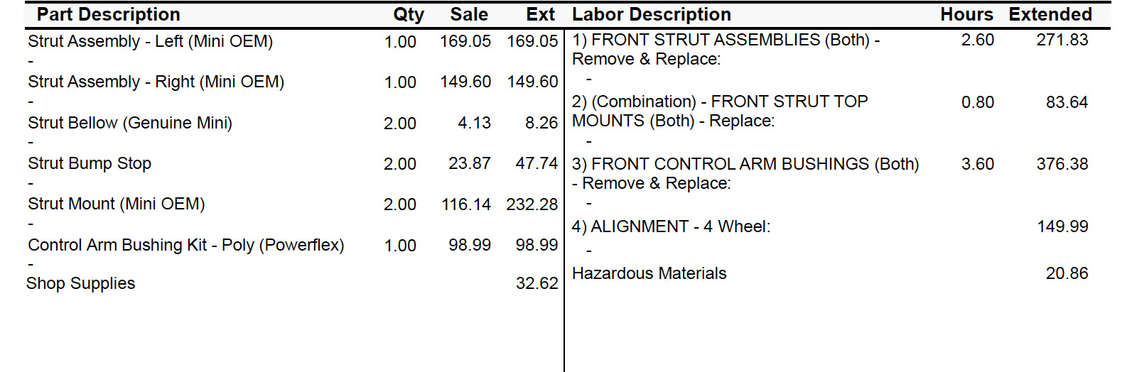

This is the second quote I got and (unlike firestone) it includes the bushings as well. What do you all think of this one?
Sorry if it seems like I am asking a lot of you guys! I'm still young and this is my first truly foreign car. I'm still getting used to the fun life of owning (and repairing) an import.
I've done all those jobs myself so my first impression is that, for an indy, both estimates are reasonable and pretty much on-target. Using aftermarket parts could save you some money and, of course, DIY could save all that labor but, in the long run, OEM parts have a warranty and, in the absence of having skilled amateur labor to DIY, you have received a fair quote. No matter how they do it, those control arm bushings are no fun and getting to the thermostat housing is half the battle.

I wanted to make sure that my diagnosis and views of the condition of Nigel were correct.
So -- an hour later here was the prognosis and overall cost to repair:
1) Side marker out and rear license plate lights not working
2) Valve cover gasket, CPS o-ring (I just replaced it), Oil Filter Housing gasket, Oil cooler gasket
3) Both upper motor mounts - I am assumin this means the upper mount and the support bracket on the shock tower
4) Power steering hose (minimal leaking -- as I check the level almost weekly after dumping a lot of fluid from a loose clamp
Total cost for parts and labor $2000 -- yikes. So I said thank you as I do most of my own work..
I went ahead and ordered everything besides the power steering hose and upper mount (I have a TSW sitting in my garage).
Total cost shipped for parts $93 from ECS tuning. I know that I'll be slower than the dealer but I need to take off the intercooler to change the boots and install an oil catch can anyhow so...the only real work I am not looking forward to is the oil filter housing (which mind you has been leaking for over a year).
Just goes to show that MUCH of the maintenance cost on these cars is labor...some of the labor and diagnosis charges were beyond obscene -- I love this dealer (which will remain un-named) but I just can't justify spending that much cash on a 12 year old car... to quote my 75 year old Mom (who is hella conservative with money)...at that price just go buy a new car...I have been eyeing a B7 S4 for a long long time. Will probably continue to eye it for a long long time given the overall "great condition" rating the dealer gave.
